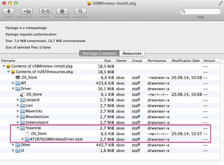

Skvo Posted September 26, 2014 Share Posted September 26, 2014 Try with the newest driver for 10.9 here: http://www.mediatek.com/en/downloads/ Newest driver unofficial support OS X 10.10. Pacifist show: 1 Link to comment https://www.insanelymac.com/forum/topic/168984-airport-like-app-for-ralink-2870/page/6/#findComment-2064178 Share on other sites More sharing options...

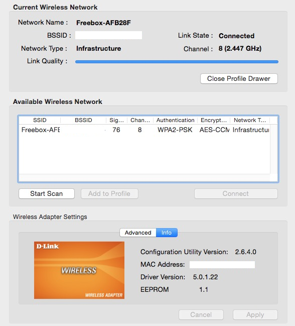

@ROBASEFR Posted September 26, 2014 Share Posted September 26, 2014 Yes you are right ! Thanks for the eye ! And it is working with OSX 10.10 DP8 automatically ( with profil drawer/connect order of my SSID) with my Dlink DWA 140 rev B1 USB dongle ! How it works for me: I took Dlink Utility prefpane v 2.6.4 from latest "DWA-140_drv_RevD1_MACOS_4-2-9-4_UI_2-6-4-0_all_en_20140806.zip" Installed with Pacifist : Statup items folder in S/L/StartupItems Then took with Pacifist : RT2870USBWirelessDriver.kext v 5.01.09 from "MT7610U_D5.0.1.09_SDK1.0.2.10_UI5.0.0.15_20140822.dmg" and installed it with Kext Wizard And took RaWLAPI.framework and put it in S/L/Frameworks Rebuild cache and permissions with Kext Wizard v 3.7.10 DWA-140_drv_RevD1_MACOS_4-2-9-4_UI_2-6-4-0_all_en_20140806.zip 2 Link to comment https://www.insanelymac.com/forum/topic/168984-airport-like-app-for-ralink-2870/page/6/#findComment-2064225 Share on other sites More sharing options...

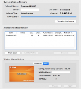

scoobdriver Posted October 1, 2014 Share Posted October 1, 2014 Superstar .. Used this to get my ASUS USB-AS50 Dongle working on my Surface . However it is only working in single channel mode I think. (It also only appears to see 5Ghz networks and not 2.4Ghz) Do you have any experienxce of the issue ? Edit Scrap that.. I think it is only 5Ghz, I also think it is only operating at 20Mhz , Not 40Mhz or 80Mhz, would this be correct ? Yes you are right ! Thanks for the eye ! And it is working with OSX 10.10 DP8 automatically ( with profil drawer/connect order of my SSID) with my Dlink DWA 140 rev B1 USB dongle ! Capture d’écran 2014-09-26 à 23.23.25.png How it works for me: I took Dlink Utility prefpane v 2.6.4 from latest "DWA-140_drv_RevD1_MACOS_4-2-9-4_UI_2-6-4-0_all_en_20140806.zip" Installed with Pacifist : Statup items folder in S/L/StartupItems Then took with Pacifist : RT2870USBWirelessDriver.kext v 5.01.09 from "MT7610U_D5.0.1.09_SDK1.0.2.10_UI5.0.0.15_20140822.dmg" and installed it with Kext Wizard And took RaWLAPI.framework and put it in S/L/Frameworks Rebuild cache and permissions with Kext Wizard v 3.7.10 DWA-140_drv_RevD1_MACOS_4-2-9-4_UI_2-6-4-0_all_en_20140806.zip Link to comment https://www.insanelymac.com/forum/topic/168984-airport-like-app-for-ralink-2870/page/6/#findComment-2065358 Share on other sites More sharing options...

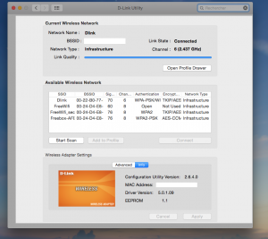

@ROBASEFR Posted January 29, 2016 Share Posted January 29, 2016 Mediatek has released an update V5.0.1.25 MAC 10.9/10.10/10.11 http://www.mediatek....ads1/downloads/ Obviously the utility works now under El Capitan: Source:http://www.insanelym...-capitan-ready/ Didn't try my self .... As always get rid of your old kexts, app and preference files before you install this ! Good luck Update: I tried and it works perfect with OSX 10.11.3 ! Desactivate WPS (associate IE and probe IE) ! in Wireless utility Input also your préfered DNS server ! in System preferences /Network/802.11nWLAN At last the utility works now ! 1 Link to comment https://www.insanelymac.com/forum/topic/168984-airport-like-app-for-ralink-2870/page/6/#findComment-2211525 Share on other sites More sharing options...
