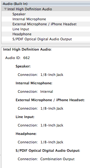

No. I've backup AppleHDA and all run smoothly. :)

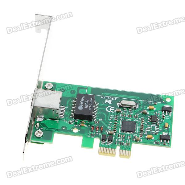

Just waiting on a Realtek nic which will hopefully fix sleep/resume issues. I'll post back with details

For the audio update problem I use this script based on a script suggested by dgsga in another topic
#! /bin/bash
cd /usr/libexec
sudo ./plistbuddy -c "delete :IOKitPersonalities:HDA\ Platform\ Resource:Layouts" /System/Library/Extensions/AppleHDA.kext/Contents/PlugIns/AppleHDAPlatformDriver.kext/Contents/Info.plist
sudo ./plistbuddy -c "delete :IOKitPersonalities:HDA\ Platform\ Resource:PathMaps" /System/Library/Extensions/AppleHDA.kext/Contents/PlugIns/AppleHDAPlatformDriver.kext/Contents/Info.plist
sudo ./plistbuddy -c "delete :IOKitPersonalities:HDA\ Hardware\ Config\ Resource:HDAConfigDefault" /System/Library/Extensions/AppleHDA.kext/Contents/PlugIns/AppleHDAHardwareConfigDriver.kext/Contents/Info.plist
sudo perl -pi -e 's|\x85\x08\xec\x10|\x62\x06\xec\x10|g' /System/Library/Extensions/AppleHDA.kext/Contents/MacOS/AppleHDA
exit 0
It will work only for who is using a legacyHDA.kext because the script will remove all the layout,pathmaps and ConfigDefaults from the original AppleHDA leaving only the one we need and we have in legacyHDA. This reduces the time to load the kext and find out the correct data for the audio card
with this modification I have 3 whell spins at boot instead of 11
Note:For who is using ZEvoReboot.kext (like me) the legacyHDA is included in that kext so you can use the script without problems
ZotacAppleHDAFix.zip

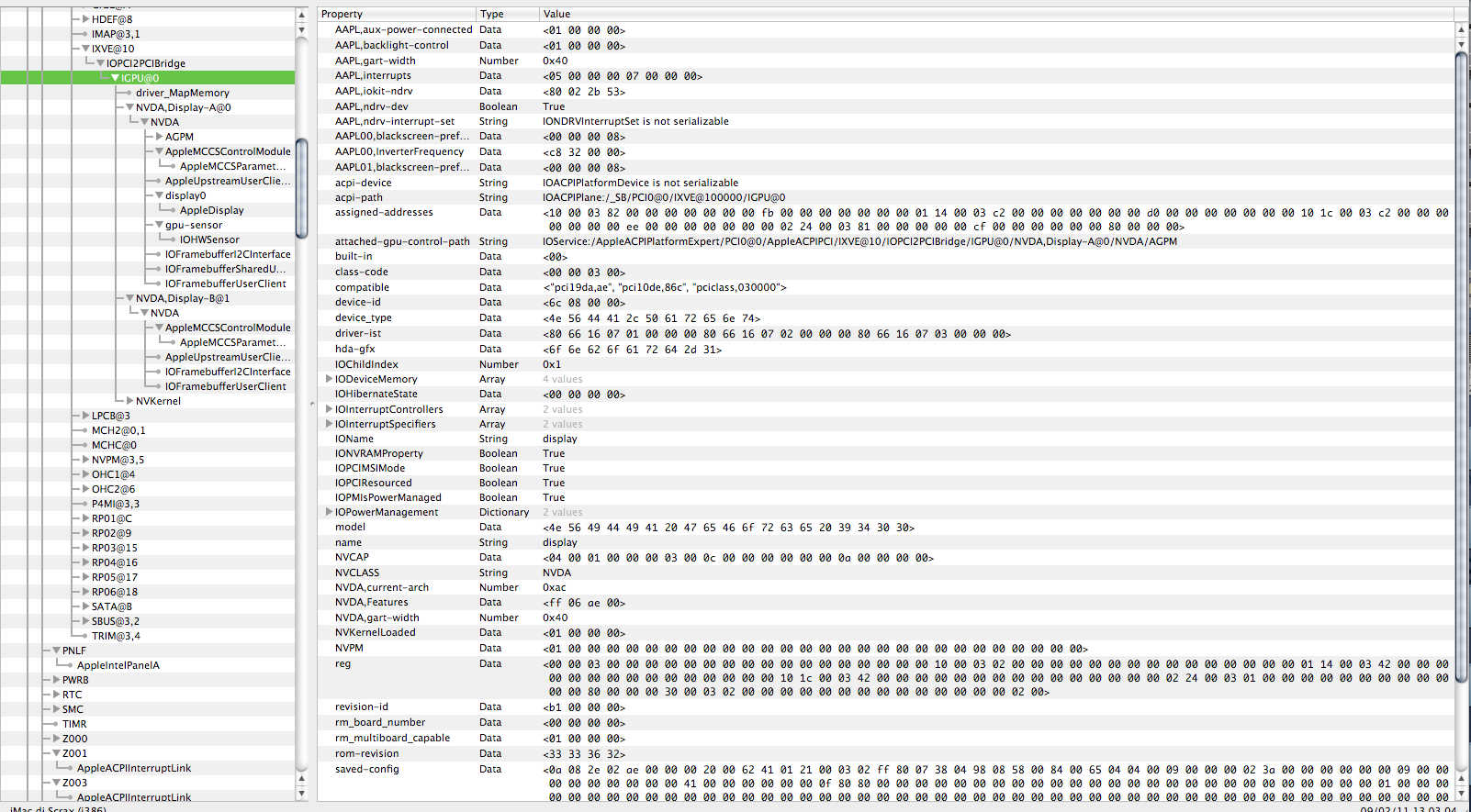

In a few day I'll update a more optimized and reduced DSDT that I'm testin in this day.
I really suggest anyone using my previously posted DSDT to change to this one because it's a lot more better and a little more faster at load either.
EDIT:
And here you are!
An extremely stripped down dsdt with all the minimal code to boot our Hack without problem.
It's based on the original dsdt from the last rev1 bios but it passed from a 30224 bytes to a 3186 bytes DSDT.aml file
In less than 200 lines of code we have our dsdt.dsl with all the patch added name changed to the one of a iMac9,1 (now we have almost the same ioreg but with the original dsdt) RTC fix, TIMR & HPET fix, integrated GFX injection, HDEF injection, SATA injection, LPCB injection, SBUS injection, USb injection, missed mac Device names injection.
For injection it uses the MCDP method instead of DTGP so this help in keep the dsdt smaller.
DefinitionBlock ("Zotac_GF9300_ITX_WIFI/dsdt_V3.9.3.aml", "DSDT", 1, "APPLE", "iMac", 0x00090001) { //DSDT V 3.9.3

		Device (IXVE) {Name (_ADR, 0x00100000)
			Device (IGPU) {Name (_ADR, Zero)								 // Internal GFX INJECTION
				Method (_DSM, 4, NotSerialized) {Store (Package (0x1E) {
							"@0,display-cfg", Buffer (0x04) {0x00, 0xff, 0x00, 0x00},
							"@0,compatible", Buffer (0x0B) {"NVDA,NVMac"},
							"@0,device_type", Buffer (0x08) {"display"},
							"@0,name", Buffer (0x0F) {"NVDA,Display-A"},
							"@1,display-cfg", Buffer (0x04) {0x03, 0x02, 0x03, 0x01},
							"@1,compatible", Buffer (0x0B) {"NVDA,NVMac"},
							"@1,device_type", Buffer (0x08) {"display"},
							"@1,name", Buffer (0x0F) {"NVDA,Display-B"},
							"NVCAP", Buffer (0x14) {
								0x04,0x00,0x01,0x00,0x00,0x00,0x03,0x00,
								0x0C,0x00,0x00,0x00,0x00,0x00,0x00,0x0A,
								0x00,0x00,0x00,0x00},
							"VRAM,totalsize", Buffer (0x04) {0x00, 0x00, 0x00, 0x20},
							"device_type", Buffer (0x0D) {"NVDA,GeForce"},
							"model", Buffer (0x14) {"NVIDIA GeForce 9400"},
							"rom-revision", Buffer (0x0D) { "62.79.34.0.0"},
							"device-id", Buffer (0x04) {0x61, 0x08, 0xDE, 0x10},
							"hda-gfx", Buffer (0x0A) {"onboard-1"} }, Local0)
					Return (MCDP (Arg2, RefOf (Local0))) } }

I have attached the ACPI tables with the MacMini3,1 device properties plist in them if you want to try (obviously need to change the PCI address bits).
hyum interesting... thankyou!
PS: The PCI adress is the same this board is pretty identical to a similar mac mini or imac.

EDIT: It works I can't say if better or not, still no luminosity slider, but i think we need a imac9,1 dump from one with the GF9400.
Mac mini can't control luminosity either, only mac book, macbook pro and imac can.from my test in a mac store.
Guess you tried adding Device (PNLF) into DSDT? I needed that, plus the dev prop.s from the MBP6,1 to get my Vostro brightness slider working.
As for a iMac9,1 dump the only one I can find has a broken link on ProjectOSX.
I'll give your Zotac stuff a shot later today. Thanks for sharing!
All best.
Yes I added it, and I made some test one with the macmini data and other merging in data from the dev prop of an iMac10.1 but it's a pain because isthe model with ati not nvidia..
I will try to check all the device prop I have to find out how to enable brightness slider
Could you check if your AAPL,backlight-control is 00 00 00 00 like the mac mini or 01 00 00 00 like the iMac in ioreg ?
here a screen of my IOREG now:
BTW, tried your extra folder. 3 wheel rotations faster to boot than my old extra folder.....

BRIGHTNESS "WORKING!!!" :D
I've managed to find out what to inject using dev prop of a MacBook6,1 (it has the GF9400M) now I have the brightness slider and bezel :) but no change to the display brightness :D

  1. Ethernet not working after sleep,
  2. mute not active on ALC662,
  3. No driver for USB wifi,
Workarounds:
  1. None for now (or another Eth device in the PCI-e slot? The Apple Eth2usb adapter :D )

A note that i forgot to mention is that Rear Line IN is configured to be a secondary Line Out. That way you can have a 6 out for analog surround (using also the frontal out)
To use your configuration instead you need to copy from your legacyHDA or what you use to inject audio pinconfigs and path maps your injection dictionary "HDA Hardware Config Resource" and "HDA Platform Resource" and paste them in the info.plist located inside ZEvOreboot.kext under IOKitPersonalities
Minihack do you have at hand the legacy kext with the correct Rear LineIn? I'll add in the zip for who needs Line In.
Here you go. Patched for ALC662.
