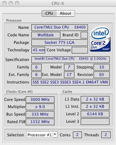

I honesty never managed to get speedstep to work at all so it's running on default 2.8GHz all the time in my case. Temps are same as on 10.6.x. Are you sure it's even related to power managament? Lion suffers a lot from "buggy" quicklookd scanning "broken" movie files. I personally noted a QTKitServer process starting once in a while using CPU time a lot causing whole system a bit unstable and hot. I solved it by removing execute rights from that file so it won't annoy me anymore.

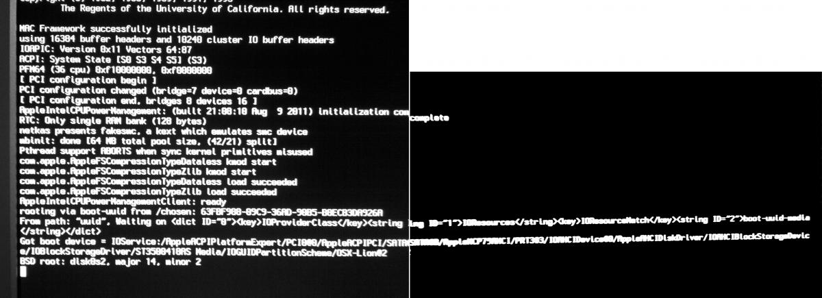

I have a serius problem with my SKU : GF9300-G/-J, I was install 10.7 and work fine, the only problem is that no appear the round below the apple...
Today I update to 10.7.2 and crash the system, because the screen was stoped in "PCI configuraton is begining". I made two changes in the DSDT:
in PCI0 change Name (_UID, 0x01) and change "Geforce" by "Parent" in the inyection of Nvidia, but the result is "PCI configuraton is begining".
Yozik, do you have any solution?

When I boot with boot flag
-v npci=0×2000
But no boot...
please someone try for me if those solutions work to solve
the Hidden text in verbose boot after [PCI CONFIGURATION begin]
with boot flag
-v npci=0×2000
and to bypass all kext loading by creating he kextcache with the command
sudo kextcache -v 1 -a i386 -a x86_64 -m /System/Library/Caches/com.apple.kext.caches/Startup/Extensions.mkext /System/Library/Extensions

apart from it .. I suppose the trick ' npci=0x2000' solves 50% of the problem.. I see that is not a problem of boot flags but of a iopcifamily kext that from 10.6.8 to lion is very dirrerent!
that's because often you have differents behaviour using many versions of DVD setups.. (iatkos etc..)
if you cerate a kextcache probably you have KP at boot..
I suggest you to boot with another version of iopcifamily..
but.. sorry.. is it so much important to see the rows filling at -v boot?
if you're fine.. you hit the top.. with or without verbose log at boot!
after the boot.. launch the terminal and log cat the system logs .. kernel logs etc.. you read those hidden and invisible rows again!
vicentyùin the bangslak v3 and iatkod l2 lion dvd there are the iopcifamily patched from oleg
that solve the verbose log
