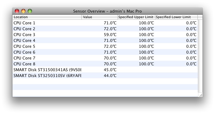

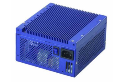

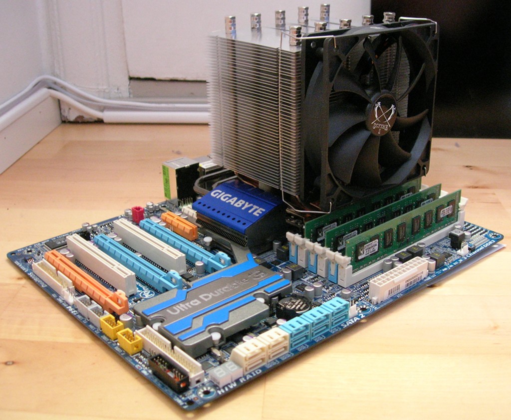

mrmacintosh31 Posted July 2, 2009 Share Posted July 2, 2009 EX85-UD5 Totally Silent Computer Sorry to be a bit off topic, but some people in this group might find this information useful I want my computer to be as silent and stable as possible. Lately I got annoyed by the noise emitted by my processor cooler and the power supply fan, so I started to google around to find silent replacements for these parts. Here is what I found: Totally silent (passive) processor cooler: Scythe Mugen II This cooler is massive and you can use it with or without the included fan. In both cases it is totally silent. Totally silent power supply: FSP Zen 400 This is a 600 W power supply that is down rated to 400 W and passively cooled. Totally noiseless. Manufacturers site: http://www.fsplifestyle.com/en/booster_a.a...mp;productId=21 This power supply only has a 4 pin 12 V connector as EX85-UD5 has a 8 pin connector. EX85-UD5 is compatible with both 8 pin and 4 pin, the trick is to connect the 4 pin to the right pins on the 8 pin connector on the motherboard. My system now has only 1 slow and silent fan blowing air out of the case and the large silent processor fan that came with Mugen II. I tested my new totally silent system with 40 minutes of x264 video encoding with Handbrake 0.9.3. This loads all cores on the system maximally. I also have hyper threading turned on so my 4 cores are seen as 8. I used this free program to monitor my core temperatures: http://www.bresink.de/osx/TemperatureMonitor.html The air temperature in my room was about 30 degrees celcius at the time of the test. I never overclock as I wan't my system to be absolutely stable. Here is my computer idling: Here it is after 40 minutes of loading all the cores. My current hardware list is: - Motherboard: GigaByte GA-EX58-UD5. (Bios version F5). - Processor: Intel Core i7 920 2,66GHz - Processor Cooler: Scythe Mugen II (Totally noiseless) - Ram: Kingston ValueRam 6GB (3x2GB) DDR3 1066MHz CL7 (KVR1066D3N7K3/6G) - Graphics: ASUS GF 8400GS SIL PCIE 512MB 64BIT DDR2 (Passive Cooling and totally noiseless) - Computer Case: Antec Sonata III - Power Supply: FSP Zen 400 (Totally noiseless) - Hard Disk: 1,5 TB Seagate SATA Hard Disk. - Bluetooth: MSI PC2PC-Bluetooth Transceiving Key (MS-6967-010) Bluetooth Wireless Adapter. - BluRay SATA Burner: Lite-On DH-4B1S DVD+/-RW ja BD-RE - Monitor: Sony TV KDL32W4000 Link to comment https://www.insanelymac.com/forum/topic/149505-guide-retail-os-x-install-1058-on-gigabyte-ga-ex58-ud5-core-i7-mobo/page/77/#findComment-1190594 Share on other sites More sharing options...
krypto Posted July 2, 2009 Share Posted July 2, 2009 Actually, the injector in my script's Graphics folder is the same Netkas Universal Injector referenced in the link. So, no need to delete it - just delete the other graphics kexts in S/L/E mentioned in the post and install the GT200 drivers. regards, MAJ Thats right MAJ , I just had to delete the graphics kexts in S/L/E and install the GT 200 drivers! Its not necessary to delete the Graphics folder and then install the same Netkas Universal Injector again! Beautiful , simply just works.... Link to comment https://www.insanelymac.com/forum/topic/149505-guide-retail-os-x-install-1058-on-gigabyte-ga-ex58-ud5-core-i7-mobo/page/77/#findComment-1190695 Share on other sites More sharing options...
mattrb Posted July 2, 2009 Share Posted July 2, 2009 EX85-UD5 Totally Silent Computer Totally silent (passive) processor cooler: Scythe Mugen II Totally silent power supply: FSP Zen 400 I see that you have made an honest attempt to make it as silent as possible. Although, there is a fan on that heatsink, they put out a few dB. So "Totally" and "Passive" would be the incorrect way to describe this computer. Fortunately, I am sure that you could barely hear any noise, Bravo to your attempt at quietness. Link to comment https://www.insanelymac.com/forum/topic/149505-guide-retail-os-x-install-1058-on-gigabyte-ga-ex58-ud5-core-i7-mobo/page/77/#findComment-1190738 Share on other sites More sharing options...
