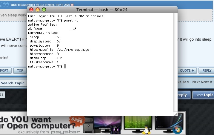

hobes270 Posted July 9, 2009 Share Posted July 9, 2009 Even sleep works flawlessly! I have EVERYTHING working to 100% right now except for sleep. How do I go about getting sleep to work? It will go into sleep, but will never come back out. I am using chameleon 2, on DD script 3.91. Thanks!! Link to comment https://www.insanelymac.com/forum/topic/149505-guide-retail-os-x-install-1058-on-gigabyte-ga-ex58-ud5-core-i7-mobo/page/81/#findComment-1196054 Share on other sites More sharing options...
matt1801 Posted July 9, 2009 Share Posted July 9, 2009 I have EVERYTHING working to 100% right now except for sleep. How do I go about getting sleep to work? It will go into sleep, but will never come back out. I am using chameleon 2, on DD script 3.91. Hi Hobes, Sleep has been the biggest mystery to me apart from my airport issue. Here's a summary of my sleep oddessy: Part 1: 1. Installed iPC 10.5.6 2. Sleep worked out of box Part 2: 1. Installed 10.5.7 using DD method 2. Sleep worked, but instant kernel panic on wake from sleep 3. Upgraded to F8b bios, same sleep result 4. Changed hibernate mode (open terminal, type "pmset -g" to see what your current hibernate mode is, and look back about 25-30 pages for explanation and directions on how to change it) to all available values, sleep still would not work. 5. Left hibernate mode on mode "0" and quit working on sleep! Part 3: 1. About 3 weeks later I tried sleep and it worked! I could wake from sleep and my system remained stable for many hours after! I cannot tell you what the heck I did to spontaneously get sleep working, I suspect it must have been a software upgrade I downloaded, or an unintentional tweak to the hibernate mode settings. I have attached a photo of my terminal running the "pmset -g" command. Honestly, I never thought sleep would work on my system. I have over a dozen usb devices, usb midi, usb bluetooth, logitech wireless mouse, etc. I figured all those peripheral would make sleep finicky forever. But as of today, it seems to work great. Sorry I can't be of more help, but I suspect with the shear variety of system configurations out there finding a "silver bullet" sleep solution will be next to impossible. I've also listed my system config below. Cheers and good luck, Matt Gigabyte UD5 F8b bios DD install method with Chameleon 2 rc1 bootloader Core i7 920 (no overclock) 6gb ocz ram 3 sata hd drives Pci wifi card EVGA 9800gtx graphics with netkas.org drivers Sata dvd drive over 1 dozen usb peripherals apple bluetooth keyboard apogee duet firewire audio interface samsung t260hd monitor Link to comment https://www.insanelymac.com/forum/topic/149505-guide-retail-os-x-install-1058-on-gigabyte-ga-ex58-ud5-core-i7-mobo/page/81/#findComment-1196135 Share on other sites More sharing options...

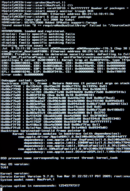

Per Wiklander Posted July 9, 2009 Share Posted July 9, 2009 Well, the problem here was that I didn't get the chance to enter any params since I had accidentally activated quiet boot. After using another computer for the past week, I decided to fix this today and my guess that pounding F8 would give me the menu back proved correct. So I booted with -v and, as often happens when you are desperate enough to ask for help, everything worked just fine, no gray screen of death. *sigh* It's working just as good after a few reboots now so I guess I'll never find out what the actual problem was that caused the gray screen at boot last week. When this happened again today I decided to find out what was wrong. After a series of reboots I'm pretty sure that the only time I get the KP is when I have my headphones connected to the front audio headphone jack on my box. Back (on mobo) ports work fine. Plugging the headphones into the front mic jack is also fine. See attached image for the actual KP. Link to comment https://www.insanelymac.com/forum/topic/149505-guide-retail-os-x-install-1058-on-gigabyte-ga-ex58-ud5-core-i7-mobo/page/81/#findComment-1196639 Share on other sites More sharing options...
