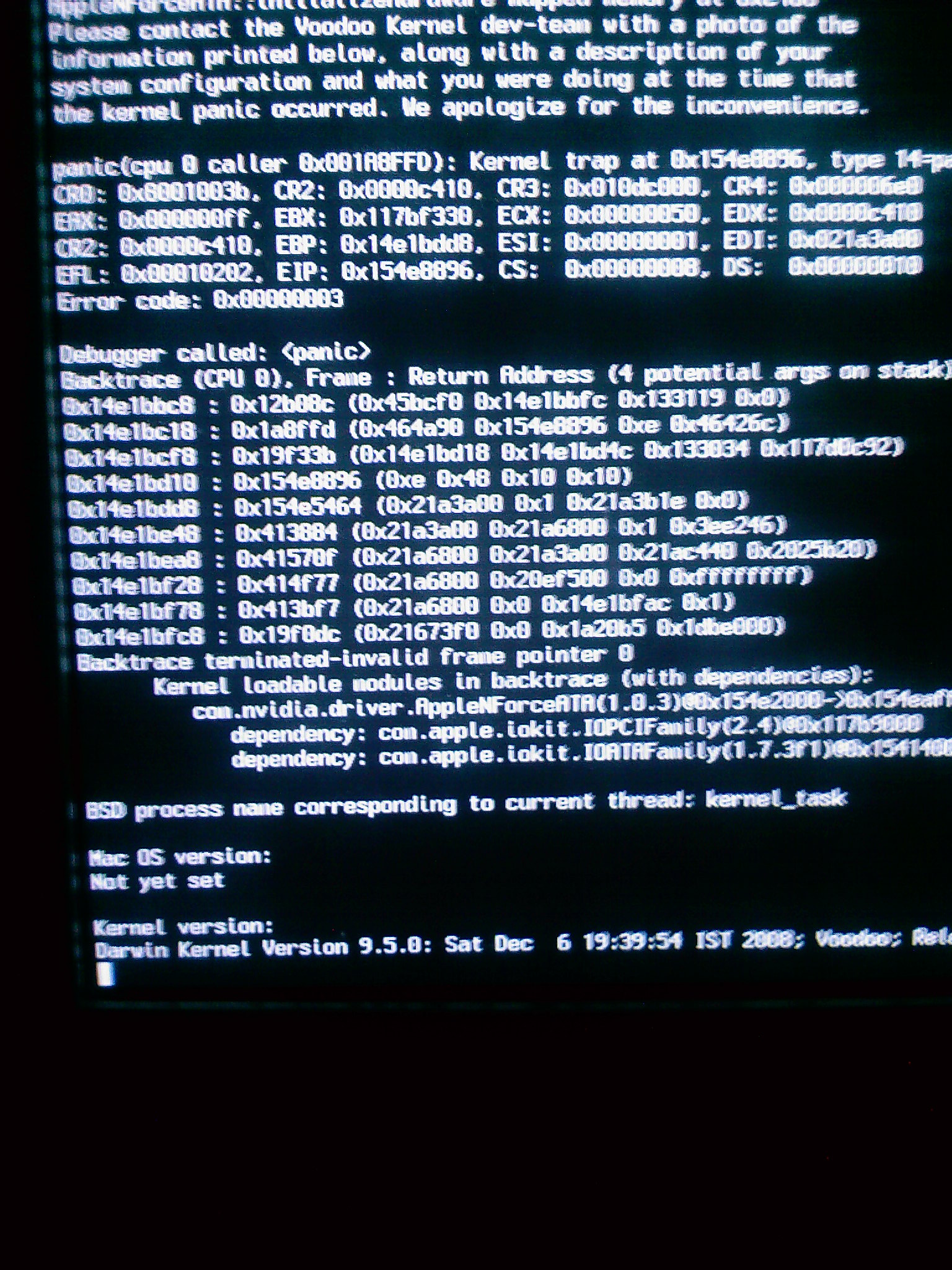

sirmota Posted January 16, 2009 Share Posted January 16, 2009 After a successful instal i get stuck on this screen if i boot with -v and -f flags http://img261.imageshack.us/my.php?image=dsc03705eb6.jpg my paltop it's a Hp pavilion zx5000 what can i do to solve this? Link to comment https://www.insanelymac.com/forum/topic/142876-xxx_x86_1056_install_disc_universal_finalv2/page/7/#findComment-1044016 Share on other sites More sharing options...

sirmota Posted January 16, 2009 Share Posted January 16, 2009 Your Radeon9600 (I belive is what you have) wont fully work with QE/CI. Those 9600 drivers in the ISO are from Tiger; someone requested them 'cause they were working for him, they give resolution change only. Now if you can live with it your best chance is not to install the 9600 drivers and try to get it working afterwards (seems that AGPGart.kext isnt working for you) or if you have windows installed, you can access the OSX disk (with macdrive) and delete AGPGart.kext (in /System/Library/Extensions/), so you dont have to reinstall.I would install Tiger on that computer; Yes that's my video card, i'll try to install again without the video driver, if i still have that problem i'll give a try with Tiger. And just one more thing, i have a new hp dv5-1050ep and when i try to install i get the "still wainting for root device" http://img178.imageshack.us/my.php?image=dsc03708gc9.jpg i've tryed the ipc pp3 release too but no success either, is there anything that i can do? My Notebook it´s a HP Dv5-1050ep Intel® Core™2 Duo T9400 2,53 Ghz, 6 MB - Chipset Intel IPM45 + ICH9M Memory 3GB -HD 320GB SATA 5400 rpm NVIDIA GeForce 9600M GT 4 USB 2.0, 1 HDMI , 1 eSata, 1 VGA, 1 RJ45 conector ethernet, 1 IEEE 1394 Firewire Thanks man Link to comment https://www.insanelymac.com/forum/topic/142876-xxx_x86_1056_install_disc_universal_finalv2/page/7/#findComment-1044175 Share on other sites More sharing options...

sirmota Posted January 17, 2009 Share Posted January 17, 2009 Thats a nice machine for leopard. Try to change the sata settings from IDE to AHCI or from Enhanced to compatible (within BIOS). If you have windows try to get the device ID from your SATA controller with Everest or some software like that; I'll add it onto the ISO... My BIOS don't have the option to change to AHCI, is there any other way? In EVEREST i got this : South Bridge Intel 82801IM ICH9-M Intel Platform Montevina Revision 93 Package Type 676 Pin mBGA Package Size 3.1 cm x 3.1 cm Core Voltage 1.05 V Driver Description Intel® ICH9M-E/M SATA AHCI Controller Driver Date 15-04-2008 Driver Version 8.0.0.1039 Driver Provider Intel Device Description Intel 82801IB ICH9 - 4-port SATA AHCI Controller Bus Type PCI Bus / Device / Function 0 / 31 / 2 Device ID 8086-2929 Subsystem ID 103C-3603 Device Class 0106 (SATA Controller) Revision 03 Link to comment https://www.insanelymac.com/forum/topic/142876-xxx_x86_1056_install_disc_universal_finalv2/page/7/#findComment-1044386 Share on other sites More sharing options...

BlackCH Posted January 17, 2009 Author Share Posted January 17, 2009 Device Description Intel 82801IB ICH9 - 4-port SATA AHCI ControllerBus Type PCI Bus / Device / Function 0 / 31 / 2 Device ID 8086-2929 Subsystem ID 103C-3603 Device Class 0106 (SATA Controller) Revision 03 Yes; that ID wasnt on the driver, thats why you cannot boot. I've added it now. Lets see if it works. What you need to do is to replace the Extensions.mkext file (/System/Library/ folder within the ISO) with the one I uploaded for you. There are some applications under windows that can do that- TransMac or MagicIso (replace a file within a ISO image). If you have access to OSX this can be done easy with some terminal commands. Then reburn. Let me know if it works download link: http://www.mediafire.com/?ymemwmxmzjw 1. Power* cannot log off/restart/shutdown. Please recommend an appropriate fix for power based on hardware below. Thanks. 2. JMicron JMB363 ATA * when I enabled in bios again I got another kernel panic. During install I recall having two JMicron ATA options and believe I selected both. Which do I need and which should I delete. 3. Kernels * I installed the default kernel. Can this kernel take Apple updates without concern? Do I need Voodoo to do that instead? An Apple security update killed my last Kalyway install. 4. Separate Kexts * I installed PCEFI. Does this not setup a separate directory for MY kexts to avoid upgrade issues? Where is that? My hardware is in my sig. Thanks so much for this release and getting my hackintosh up an running again. -Installing Voodoo kernel will take care of the restart/shutdown problems. If you still want to use the default (Vanilla) kernel, you can try the OpenHaltRestart.kext; should work too. -You installed both packages which actually is the same kext modified. So the second package (wrong one, The one that says 'JMB360' is meant ONLY for that device) overwritten the first. Need to reinstall the Jmicron.kext: http://darwin-ata.googlecode.com/files/JMicronATA.kext.zip use kexthelper to install. -PCEFI installer doesnt generate the /Extra/Extensions folder automatically. You need to do it yourself (sorry). Not a big deal if you kept track of the items you installed. Just create the folder, copy the kexts, repair permissions, delete the kext from origen... Hi, thank you very much for your post, I've done what you said: removing the AppleHPET (no effect), then adding the IONetworkingFamily.kext (still no effect). Have you any other idea for this? Because, if the bluetooth doesn't work I'll be mandated to return back to 10.5.5... (My only MAC keyboard is bluetooth) And the trick for rebooting works well thank you! (used the OpenHaltRestart extension) ....Dont know, maybe reinstalling the 10.5.5 IOBluethootFamily.kext.... Since is a USB dongle the problem could also be related with USB ports. You could try to install some fixed USB kexts: http://forum.insanelymac.com/index.php?showtopic=117029 Trial & error method. Every system/hardware combination works different Link to comment https://www.insanelymac.com/forum/topic/142876-xxx_x86_1056_install_disc_universal_finalv2/page/7/#findComment-1044674 Share on other sites More sharing options...

sirmota Posted January 17, 2009 Share Posted January 17, 2009 Yes; that ID wasnt on the driver, thats why you cannot boot. I've added it now. Lets see if it works.What you need to do is to replace the Extensions.mkext file (/System/Library/ folder within the ISO) with the one I uploaded for you. There are some applications under windows that can do that- TransMac or MagicIso (replace a file within a ISO image). If you have access to OSX this can be done easy with some terminal commands. Then reburn. Let me know if it works download link: http://www.mediafire.com/?ymemwmxmzjw i replace the file, and burn again the dvd but when i try to boot from the dvd nothing happens, no screen to press F8 or any key... also my bios don´t have the option to change SATA... Link to comment https://www.insanelymac.com/forum/topic/142876-xxx_x86_1056_install_disc_universal_finalv2/page/7/#findComment-1044902 Share on other sites More sharing options...
