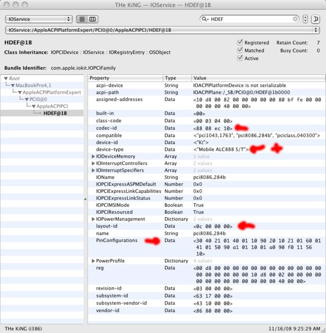

xgenius Posted May 13, 2009 Share Posted May 13, 2009 I re-installed 10.5.1 and then did a combo update to 10.5.7. That worked. Then applied Chameleon. I am using the bare minimum kexts in /Extra/Extensions, and I am back to where I was in 10.5.6 (except audio) Problems: Audio Kexts leads to Kernel Panic (already mentioned by others) My modified smbios.plist also gives me a kernel panic. If i delete that file, everything is fine, except that the About this mac is not correct, which is not a big deal. The big issue is to get the audio back. Link to comment https://www.insanelymac.com/forum/topic/141769-new-install-gigabyte-ga-ep45-ud3r/page/21/#findComment-1154417 Share on other sites More sharing options...
Squirrelf Posted May 13, 2009 Share Posted May 13, 2009 just came home OK so now we need dsdt to load the sound after reading this unfortunate problem I just looked around the answer to the problem is loading applehad using DSDT instead of HDAEnabler but first we need to get dsdt to work without carring about sound yet Anyone want to try playing around with me to be sure we get the same result ? seanmcd ? so first go to http://www.insanelymac.com/forum/index.php?showtopic=133683 and get your dsdt patched put the generated dsdt.aml in the extra folder cross your finger and hopes it boot , if it doesn't work rename it to DSDT.aml (case sensitive), if it still doesn't work we are temporarly screwed... I'll do the same in 10.5.6 for now and hope it works too for those people who wants to stay at 10.5.6 I'll probably be updating to 10.5.7 as soon as sound works (I want to watch a movie tonight ) as soon as this is done say so ? and will go on the next step Link to comment https://www.insanelymac.com/forum/topic/141769-new-install-gigabyte-ga-ep45-ud3r/page/21/#findComment-1154419 Share on other sites More sharing options...
xgenius Posted May 13, 2009 Share Posted May 13, 2009 just came home OK so now we need dsdt to load the sound after reading this unfortunate problem I just looked around the answer to the problem is loading applehad using DSDT instead of HDAEnabler but first we need to get dsdt to work without carring about sound yet Anyone want to try playing around with me to be sure we get the same result ? seanmcd ? so first go to http://www.insanelymac.com/forum/index.php?showtopic=133683 and get your dsdt patched put the generated dsdt.aml in the extra folder cross your finger and hopes it boot , if it doesn't work rename it to DSDT.aml (case sensitive), if it still doesn't work we are temporarly screwed... I'll do the same in 10.5.6 for now and hope it works too for those people who wants to stay at 10.5.6 I'll probably be updating to 10.5.7 as soon as sound works (I want to watch a movie tonight ) as soon as this is done say so ? and will go on the next step Eliade, I got the dsdt patched and booted successfully. You can have my machine to experiment. Let me know what I should do next. Link to comment https://www.insanelymac.com/forum/topic/141769-new-install-gigabyte-ga-ep45-ud3r/page/21/#findComment-1154426 Share on other sites More sharing options...
seanmcd Posted May 13, 2009 Share Posted May 13, 2009 Mine reboots ok with the dsdt.aml file in the Extra folder. (without HDAEnabler.kext) Link to comment https://www.insanelymac.com/forum/topic/141769-new-install-gigabyte-ga-ep45-ud3r/page/21/#findComment-1154429 Share on other sites More sharing options...
Squirrelf Posted May 13, 2009 Share Posted May 13, 2009 Eliade,I got the dsdt patched and booted successfully. You can have my machine to experiment. Let me know what I should do next. ok great basically what we need to try is there: http://www.insanelymac.com/forum/index.php...mp;#entry912132 DSDT.dsl should be in the the patcher folder, in the debug folder but I'll copy the interesting part here: (original info from THe KiNG) Open the DSDT.dsl and go to your HDEF entry(if you don't have HDEF entry modd it), also open IORegistryExplorer(install XCode if you dont have it yet): You need to add these entry(bolded) on your DSDT under Device (HDEF) based on info you get from IOReg(red marks)as I did: Device (HDEF) { Name (_ADR, 0x001B0000) Method (_PRW, 0, NotSerialized) { Return (GPRW (0x0D, 0x03)) } <b>Method (_DSM, 4, NotSerialized) { Store (Package (0x08) { "codec-id", Buffer (0x04) { 0x88, 0x08, 0xec, 0x10 }, "layout-id", Buffer (0x04) { 0x0c, 0x00, 0x00, 0x00 }, "device-type", Buffer (0x11) { "Mobile ALC888 S/T" }, "PinConfigurations", Buffer (0x20) { /* 0000 */ 0x30, 0x40, 0x21, 0x01, 0x40, 0x01, 0x10, 0x90, /* 0008 */ 0x20, 0x10, 0x21, 0x01, 0x60, 0x01, 0x41, 0x01, /* 0010 */ 0x50, 0x90, 0xA1, 0x01, 0x10, 0x01, 0xA0, 0x90, /* 0018 */ 0xf0, 0x11, 0x56, 0x10 } }, Local0) DTGP (Arg0, Arg1, Arg2, Arg3, RefOf (Local0)) Return (Local0) }</b> } Quick explain on what is those terms/entry: "Store (Package (0x08)" - This is how many entry u have to inject, in my case there are 4, multiply with 2=8 dec to hex= 0x08 "Buffer (0x04)" this is how many data is under it, 0x88, 0x08, 0xec, 0x10 that means 4 dec to hex=0x04 "}," the comma means that another entry comes, when its "}" that mean no more entry after "/* 0018 */" As you can see we have 3 complete entry of 8 =24 dec to hex= 0x18, if you need to add another one then will be 32 dec to hex=0x20 result "/* 0020 */" for the next line of 8, when you finish to add remove "," after last one. Pay attentions to all this, they are very important! ------------ could you two post your "orginal" dsdt.dsl I'd like to know if it's exactly the same file considering we have the same board ----- I booted without hdaenabler and HDEF does not show up in the IORegistryExplorer.app so I suppose you don't either I booted with the enabler now it shows up so use my values, since it should be the same sound device wether it's REV1 or REV1.1 of the board edit values are missing.... Link to comment https://www.insanelymac.com/forum/topic/141769-new-install-gigabyte-ga-ep45-ud3r/page/21/#findComment-1154433 Share on other sites More sharing options...

Squirrelf Posted May 13, 2009 Share Posted May 13, 2009 HOW TO UPDATE TO 10.5.7 (when using retail install) before updating you must remove: HDAEnabler, LegacyHDAPlatformDriver, LegacyHDAController found in previous kext pack and use the ones from this pack then a simple software update will do! you may replaces all the ones from this pack before or after the update... Updated MAY 20: new sound kext Pack_for_10.5.7.zip edit May 20: I added a bunch of readme I just made, how to use this pack, tips and tricks, how to install from retail disk don't hesitate to edit/update/add more detail to the readmes and how to's, I did it quickly and I'm sure it can be improved... then post them so that I can replace them in the pack that will lower the number of repeated usual questions... in this thread delete all the kext you have in your extra/Extensions and replace with the ones in this pack... (except of course for special ones you added yourself for special hardware) ich10 kext are not needed any more (10.5.7 fully supports ich10) so LegacyAppleAHCIPort, LegacyAppleIntelPIIXATA, can and should be deleted (they are not in this pack) but keep LegacyIOAHCIBlockStorage (fix HD icon) if timed sleep doesn't when firefox is running use this fix thanks to xgenius: "Fireup Firefox, type in about:config in the address bar. It will open up the config values, after a warning. Type in "places.frecency.updateIdleTime" in the Filter text box. You should see the parameter to 60,000. Click on the parameter and modify the value to 0. Basically, you are disabling the parameter." ---- WHAT WAS FIXED AFTER THE ORIGINAL 10.5.7 pack: everything should be in Extra/Extensions rear sound now works front output audio now works sleep now works WHAT IS NOT WORKING YET in 10.5.7: front microphone (never worked even before 10.5.7) since 10.5.7, if I have a 400Mhz FBS, the system doesn't wake up from sleep... (other overclokers noticed that) -------- if you install from scratch, use grub dfe to update up to 10.5.7 and use this pack this pack can be used temporarily in previous version too (at least from 10.5.4 and up) same drill - if you use jmicronATA don't forget to disable "HD sleep" (if you don't your system will panic once and a while) and use -f in the apple.boot.plist (or you won't get everything working) Link to comment https://www.insanelymac.com/forum/topic/141769-new-install-gigabyte-ga-ep45-ud3r/page/21/#findComment-1154564 Share on other sites More sharing options...
Edkroket Posted May 13, 2009 Share Posted May 13, 2009 all the typical updates usually work, but the question for you will be - will the 10.5.7 update download and install without breaking anything . (that will be the question for everyone really...) Well that question is answered. It works just fine with only two small problems after update to 10.5.7. The first is Orange Icon of the HD and second the audio didn't worked anymore. I just removed AppleHDA.kext and installed the one from this post with OSX86Tools and for the orange icon I copied pasted it from another disk. Just running fine so far! after installing, during the first run, it should ask you if you want to install somekind of plugin for intel cpu temperature, if you refused it then you won't get cpu temp...or could it be because of the Xeon... You should check your Bios-settings in advance-section; Advanced Settings Limit CPUID Max. to 3.....................: [Disabled] No-Execute Memory Protect............: [Enabled] CPU Enhanced Halt (C1E)................: [Disabled] C2/C2E State Support....................: [Disabled] x C4/C4E State Support..................: [Disabled] CPU Thermal Monitor 2(TM2) ...........: [Enabled] CPU EIST Function.........................: [Disabled] Virtualization Technology................: [Disabled] Enabled if you use Vmware/Virtual PC I think you should check it there. I'm not shure how exactly but i'll check it when I'm at home again. Link to comment https://www.insanelymac.com/forum/topic/141769-new-install-gigabyte-ga-ep45-ud3r/page/21/#findComment-1154576 Share on other sites More sharing options...
grice Posted May 13, 2009 Share Posted May 13, 2009 Hi, Updated to 10.5.7. This is what worked for me. Did clean install of 10.5.6 from the retail Leopard disc on my spare Sata harddrive testbed. Used UInstaller to intall PC_EFI v9 Chameleon & essentials. Fixed permissions, rebooted without grub.iso. Updated with 10.5.7 update (the 442 mb one, not the 729 mb combo) rebooted, fixed permissions again, install NVInstaller v52.pkg, reboot, fix permissions, used OSX_86 tools to enable QuartzGL, fix permissions, reboot. Reinstall ALC889a with UInstaller, reboot fix permissions. At this point, video, audio, networking are already all working fine. Install remainder of updates thru software update. Reboot fix permissions. Just remember to backup your home folder first. Link to comment https://www.insanelymac.com/forum/topic/141769-new-install-gigabyte-ga-ep45-ud3r/page/21/#findComment-1154669 Share on other sites More sharing options...
seanmcd Posted May 13, 2009 Share Posted May 13, 2009 What happened to DSDT?? I'm holding off on the older audio kexts. I've read in at least two threads about audio for 889A that you don't need the alcinject.kext. I got my audio to work again last night without it, just not the headphones but i've tried so many things I had to stop and goto bed. Also one of the ICH10 files fixed the orange drive icons I thought... And, I think I need to repair permissions after each change I make. I think sometimes my changes don't take affect if I don't? Back to the drawing board! Link to comment https://www.insanelymac.com/forum/topic/141769-new-install-gigabyte-ga-ep45-ud3r/page/21/#findComment-1154904 Share on other sites More sharing options...

Squirrelf Posted May 13, 2009 Share Posted May 13, 2009 What happened to DSDT?? I'm holding off on the older audio kexts. I've read in at least two threads about audio for 889A that you don't need the alcinject.kext. I got my audio to work again last night without it, just not the headphones but i've tried so many things I had to stop and goto bed. Also one of the ICH10 files fixed the orange drive icons I thought...And, I think I need to repair permissions after each change I make. I think sometimes my changes don't take affect if I don't? Back to the drawing board! DSDT is the solution, but the instruction I found do not match what I see, and I don't know enough to keep going (actually I don't know anything ) I have a 3D animation to start and finish and render by tomorrow night so I really don't have time until the day after tomorrow but I wanted to update and get sound, that's why I'm using the older kext at least for now could you please post the original AppleHDA from 10.5.7, thanks But I like it because it sounds that if done correctly there would never be any need to have an extension fix for the audio (or any hardware mapped correctly with DSDT) and instead OSX would always (no matter what was updated in a system update) recognize how to use the audio hardware of our mobo. it's above my head too... but I'm not letting down the idea It's actually not too much of a bummer that 10.5.7 broke the our "best/cleanest" setup. The concept of keeping everything clean in the s/l/e folder is still the right approach because doing the update (even with the current workaround) is a heck of a lot easier than doing a full blown reinstall and replacing all the extensions. yeah Link to comment https://www.insanelymac.com/forum/topic/141769-new-install-gigabyte-ga-ep45-ud3r/page/21/#findComment-1155103 Share on other sites More sharing options...
