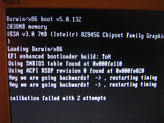

I just installed EFI 9 and after rebooting I got an error, "No Boot Device Found -- ...."
I fixed this by running
fdisk -e /dev/rdisk0
flag 2
update
write
quit
reboot
This made the partition I had OSX installed on bootable again.
Then after the reboot I get a black screen with a blinking cursor.
(Safemode boots without error.)
Restoring with Time Machine does nothing, and I'm guessing I could just re-install and backup from Time Machine but that would not take me forward only back.
Anyone have any ideas why I'm having this problem?
I uploaded a photo of the boot error.
I haven't done anything else, not updated or anything just applied PC_EFIv9 using UOI.
Thanks in advance for any help you can provide. I've been searching the forums for the last 12 hours lol but I'm learning so much I'm almost glad this happened.

Try the attached ACPIPlatform attached or get the open halt restart .kext from the Psystar website.
That took care of my broken restart. Thank you.
