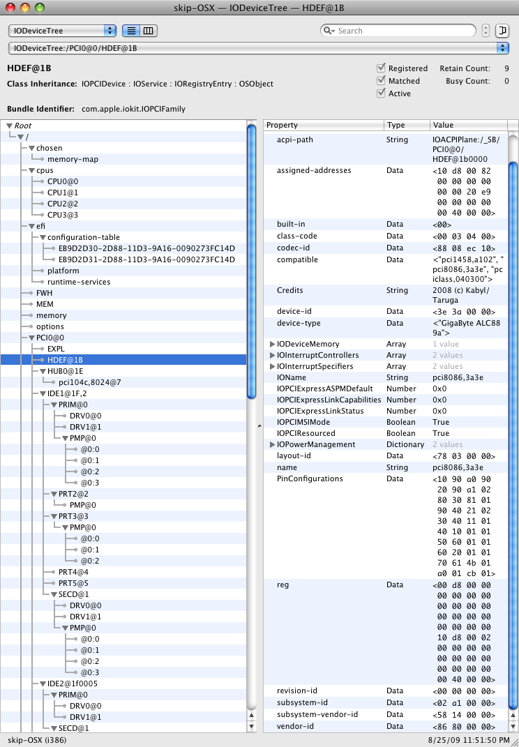

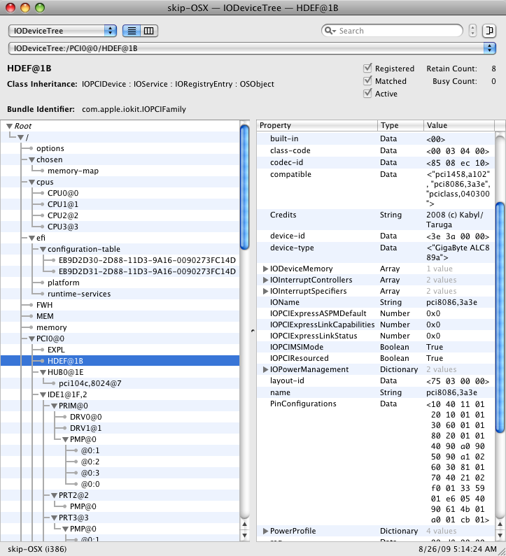

SkipG Posted August 26, 2009 Share Posted August 26, 2009 Friends, I need your help. About a week ago I became frustrated with trying to get my old onboard audio chip, an ALC883, working with the new drivers. I purchased an EP45-UD3P board with an ALC889a chip, I think, because support for the chip is much better. At the time I powered down my system, I had two drives, one used for backup and the other used for daily use and testing (two partitions). I also purchased a new drive for development and testing SL. I installed Retail 10.5.6 following Auzigog's guide on the new drive and then migrated the new drivers and setting back to my 10.5.8 installation. Getting sound to work, particularly through the headphone jack, has remained an issue. I have successfully mastered patching my DSDT.aml for the onboard ethernet and for the audio chip. I can inject PinConfigurations, device-id, layout-id and device-type, and insert ConfigData via LegacyHDA located in /Extra/Extensions. I'm using Chameleon 2.0 RC1 with Netkas' 10.2 bootloader. The main issue I'm having is getting the Headphone jack to show up in the audio preferences. The pin is defined in ConfigData, and shows up in the System Profiler. Depending on what I do with the Green Line Out jack in the rear, I can make it show up as a jack or an External port. I have, in the past couple of hours, ripped out the LegacyHDA + HDAEnabler solution, and gone with the HDAEnabler+AppleHDA solution for the 888 chip. That hasn't worked either. I also tried injecting a layout-id of 66 (also 12, 36, 63, 64 and 77), none of which resulted in a working headphone jack. Here are the results from my last try: 1) My HDEF code in dsdt.aml Device (HDEF) { Name (_ADR, 0x001B0000) Method (_PRW, 0, NotSerialized) { Return (Package (0x02) { 0x0D, 0x05 }) } Method (_DSM, 4, NotSerialized) { Store (Package (0x08) { "codec-id", Buffer (0x4) { 0x88, 0x08, 0xEC, 0x10 // 889 }, "layout-id", Buffer (0x04) { 0x88, 0x08, 0x00, 0x00 // 888, IM, t=149941 }, "device-type", Buffer (0x12) { "GigaByte ALC889a" }, "PinConfigurations", Buffer (0x01) { 0x00 } }, Local0) DTGP (Arg0, Arg1, Arg2, Arg3, RefOf (Local0)) Return (Local0) } } After booting, here's what shows up in System Profiler: Audio (Built In): Intel High Definition Audio: Device ID: 0x1458A102 Audio ID: 888 Available Devices: Internal Microphone: Connection: Internal External Microphone: Connection: 1/8-Inch Jack Line In: Connection: 1/8-Inch Jack Headphone: Connection: 1/8-Inch Jack Speaker: Connection: 1/8-Inch Jack Line Out: Connection: 1/8-Inch Jack Line Out: Connection: 1/8-Inch Jack Line Out: Connection: 1/8-Inch Jack S/P-DIF Out: Connection: Combo S/P-DIF In: Connection: Combo Looking at the situation in the IORegistry, we find this: Good news stops at this point, as the code to build the audio engine failed during the boot process. Here's the relevant information from the System Log: Sound assertion "0 == pathMap_aDriverInstance" failed in "/SourceCache/AppleHDA/AppleHDA-162.1.37/AppleHDA/AppleHDADriver.cpp" at line 1327 goto Exit Sound assertion "0 != createAudioEngines ( fPathMap_aDriverInstance )" failed in "/SourceCache/AppleHDA/AppleHDA-162.1.37/AppleHDA/AppleHDADriver.cpp" at line 127 goto Exit Sound assertion "0 == pathMap_aDriverInstance" failed in "/SourceCache/AppleHDA/AppleHDA-162.1.37/AppleHDA/AppleHDADriver.cpp" at line 1327 goto Exit Sound assertion "0 != createAudioEngines ( fPathMap_aDriverInstance )" failed in "/SourceCache/AppleHDA/AppleHDA-162.1.37/AppleHDA/AppleHDADriver.cpp" at line 127 goto Exit Can anyone please help me out? What other tools do I have to help me understand what's going wrong? I've looked at some of the ConfigData for some stock Apple layouts, and they don't even include microphone pins in their layouts! Since I really don't have an internal speaker, is there a way to eliminate that from the description? Here's what I'd like to see for outputs: Line Out Headphone Out S/PDIF Out Here's what I'd like for Inputs Front Mic Rear Mic Line In S/PDIF In The outputs don't need to autoswitch, but it would be OK if they did. I tried eliminating the internal speaker from the layout, but then I couldn't parse the PathMap and determine how to fix it. Thanks, --Skip Link to comment https://www.insanelymac.com/forum/topic/140941-alc889a-gigabyte-intel-now-having-a-working-front-mic/page/17/#findComment-1235956 Share on other sites More sharing options...

SkipG Posted August 26, 2009 Share Posted August 26, 2009 @SkipG You made the wrong layout-id of DSDT. You need to know which layout-id has CodecID of ALC889a (0x10EC0885). The important thing is CodecID in info.plist of AppleHDAPlatformDriver. If you follow my guide and use my kexts, it should not be any problem. After that, when you learn more about DSDT and how to patch AppleHDA, you will be able to rewrite your DSDT and edit info.plists of AppleHDA.kext. Gigabyte ALC889a (0x10EC0885) is not ALC889 (0x10EC0889). Sir, You are a kind, patient and gentle man. Thank you for helping me. I went back to the your suggested approach: Using the LegacyHDA.kext from Series of LegacyHDA/series of LegacyHDA 885 (ALC889a)/3out2in HDA headphone (in /Extra/Extensions) and the HDAEnabler in the parent directory (in /S/L/E) with the vanilla AppleHDA.kext, I edited my dsdt.aml to specify a layout-id of 0x75 0x03, and a codec-id of 0x85 0x08 0xEC 0x10. On booting, I got no errors about mapping the pins or building the audio engine, but I still have the problem of the headphones not showing up in the Audio Preferences panel. What I see is a list consisting of Internal Speakers, 2 entries labeled Line Out, and one labeled Digital Out. Here are the relevant screen grabs for my System Profile and IORegistry in hopes they will be of some help in solving the problem. Again, thank you for helping me... --Skip Link to comment https://www.insanelymac.com/forum/topic/140941-alc889a-gigabyte-intel-now-having-a-working-front-mic/page/17/#findComment-1236168 Share on other sites More sharing options...

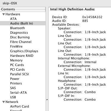

SkipG Posted August 26, 2009 Share Posted August 26, 2009 On booting, I got no errors about mapping the pins or building the audio engine, but I still have the problem of the headphones not showing up in the Audio Preferences panel. What I see is a list consisting of Internal Speakers, 2 entries labeled Line Out, and one labeled Digital Out. I have an update for folks that are following this thread: The HP jack and the corresponding rear Line Out are working the way they're supposed to be working! I plug in HP, and the rear Line Out is muted. Whatta construct! It actually works the way it's supposed to with the Jack Detect. Sigh... I've only been struggling with this for three or four days --Skip Link to comment https://www.insanelymac.com/forum/topic/140941-alc889a-gigabyte-intel-now-having-a-working-front-mic/page/17/#findComment-1236246 Share on other sites More sharing options...
VCH888 Posted August 26, 2009 Author Share Posted August 26, 2009 Sir, You are a kind, patient and gentle man. Thank you for helping me. I went back to the your suggested approach: Using the LegacyHDA.kext from Series of LegacyHDA/series of LegacyHDA 885 (ALC889a)/3out2in HDA headphone (in /Extra/Extensions) and the HDAEnabler in the parent directory (in /S/L/E) with the vanilla AppleHDA.kext, I edited my dsdt.aml to specify a layout-id of 0x75 0x03, and a codec-id of 0x85 0x08 0xEC 0x10. On booting, I got no errors about mapping the pins or building the audio engine, but I still have the problem of the headphones not showing up in the Audio Preferences panel. What I see is a list consisting of Internal Speakers, 2 entries labeled Line Out, and one labeled Digital Out. Here are the relevant screen grabs for my System Profile and IORegistry in hopes they will be of some help in solving the problem. Again, thank you for helping me... --Skip If you have HDEF enabler in DSDT.aml, you don't need HDAEnabler.kext. Please remove it. Please take time to learn how other people did on AppleHDA.kext. I took several months to understand how to edit info.plists of AppleHDA.kext. In registry should be like this. I really appreciate your help. Thank you, but still don't work. On windows of course each port is working the 5.1 system works fine but under Mac I can't get to work that orange port, and I don't understand why, I tried almost everything. Can you give me a link to the proper KEXT and the instructions? Because I've tried every single way to try to get work it. Thanks much @iNarancs May I have questions? Are you using Leo 10.5.8? What is version of AppleHDA.kext in /S/L/E, i.e. 1.7.1a2? Are you using DSDT.aml with patch HDEF? Please remove all legacy kexts (& HDAEnabler.kext, if have it) from /S/L/E or /E/E. It's weird that you could not get an orange port working. Link to comment https://www.insanelymac.com/forum/topic/140941-alc889a-gigabyte-intel-now-having-a-working-front-mic/page/17/#findComment-1236265 Share on other sites More sharing options...

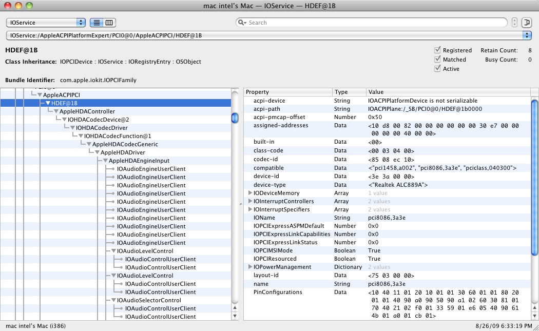

d00m42 Posted August 27, 2009 Share Posted August 27, 2009 So I recently compiled a DSDT to detect my LAN/HDA and it worked perfectly, except I think I'm using the wrong kexts so I'm not getting sound. Which kext(s) should I be using with this: Link to comment https://www.insanelymac.com/forum/topic/140941-alc889a-gigabyte-intel-now-having-a-working-front-mic/page/17/#findComment-1238158 Share on other sites More sharing options...
VCH888 Posted August 27, 2009 Author Share Posted August 27, 2009 So I recently compiled a DSDT to detect my LAN/HDA and it worked perfectly, except I think I'm using the wrong kexts so I'm not getting sound. Which kext(s) should I be using with this: @d00m42 I've read your thread that you solved your problems. For anyone, if you patch DSDT.aml with HDEF, you don't need such HDAEnabler.kext. You need to know which layout-id (LayoutID in info.plist) you're using. Then, you make your patched DSDT.aml to match your desire. A legacy kext is a kind of cosmetic and it contains only info.plist. So, you still need a vanilla kext. For example, my LegacyHDA.kext must be working with AppleHDA.kext. Link to comment https://www.insanelymac.com/forum/topic/140941-alc889a-gigabyte-intel-now-having-a-working-front-mic/page/17/#findComment-1238464 Share on other sites More sharing options...
