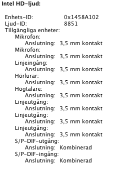

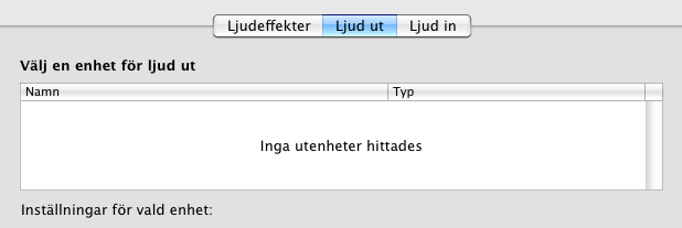

Koplimi Posted July 30, 2009 Share Posted July 30, 2009 Im having some trouble getting the sound device detected. I have a EP45-DS3R with 889A. As I have it now I have a DSDT.aml that has a HDEF-part exactly as the one in the guide. And I also have a AppleHDA.kext from your downloads. I have the "1.6.2a37 3outs2ins digital HDA headphone". (Since that is the desired config) So what I need is for someone more experienced to point me in the right direction of what I'm doing wrong. Thx in advance, and here are some pics. Link to comment https://www.insanelymac.com/forum/topic/140941-alc889a-gigabyte-intel-now-having-a-working-front-mic/page/14/#findComment-1212562 Share on other sites More sharing options...
VCH888 Posted July 30, 2009 Author Share Posted July 30, 2009 Im having some trouble getting the sound device detected. I have a EP45-DS3R with 889A. As I have it now I have a DSDT.aml that has a HDEF-part exactly as the one in the guide. And I also have a AppleHDA.kext from your downloads. I have the "1.6.2a37 3outs2ins digital HDA headphone". (Since that is the desired config) So what I need is for someone more experienced to point me in the right direction of what I'm doing wrong. Thx in advance, and here are some pics. @Koplimi please edit your layout-id from 0x93, 0x22, 0x00, 0x00 to 0x79, 0x03, 0x00, 0x00 in dsdt.dsl and recompile again. layout-id 889 => 0x79, 0x03, 0x00, 0x00 layout-id 885 => 0x75, 0x03, 0x00, 0x00 Link to comment https://www.insanelymac.com/forum/topic/140941-alc889a-gigabyte-intel-now-having-a-working-front-mic/page/14/#findComment-1212612 Share on other sites More sharing options...
Koplimi Posted July 30, 2009 Share Posted July 30, 2009 I actually did that, once i found the notice next to the download. But I still have the same result. I would also like to correct that Im using "1.5.7a24 3outs3ins digital HDA headphone". If I'm not mistaken this is the one to use för 10.5.7 and the one I said I used before is for some version of snow leopard? Any more ideas? To calarify my install i have 10.5.7 installed using Chameleon v2 RC2. And have the AppleHDA under EXTRA/Extensions along with some other kexts not related to audio. Link to comment https://www.insanelymac.com/forum/topic/140941-alc889a-gigabyte-intel-now-having-a-working-front-mic/page/14/#findComment-1212627 Share on other sites More sharing options...
VCH888 Posted July 30, 2009 Author Share Posted July 30, 2009 I actually did that, once i found the notice next to the download. But I still have the same result. I would also like to correct that Im using "1.5.7a24 3outs3ins digital HDA headphone". If I'm not mistaken this is the one to use för 10.5.7 and the one I said I used before is for some version of snow leopard? Any more ideas? To calarify my install i have 10.5.7 installed using Chameleon v2 RC2. And have the AppleHDA under EXTRA/Extensions along with some other kexts not related to audio. @Koplimi AppleHDA.kext must be installed in /System/Library/Extensions only. Otherwise, you may use legacy, it can be installed into /S/L/E or /Extra/Extensions and unpatched AppleHDA.kext is in /S/L/E. You don't need HDAEnable.kext if your DSDT.aml has HDEF code. Link to comment https://www.insanelymac.com/forum/topic/140941-alc889a-gigabyte-intel-now-having-a-working-front-mic/page/14/#findComment-1212629 Share on other sites More sharing options...
Koplimi Posted July 30, 2009 Share Posted July 30, 2009 Thank you very much! Now I have everything working. Digital, Automatic headphones etc. Now i just have to configure the 5.1 sound. And thanks again! Link to comment https://www.insanelymac.com/forum/topic/140941-alc889a-gigabyte-intel-now-having-a-working-front-mic/page/14/#findComment-1212634 Share on other sites More sharing options...
