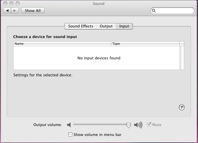

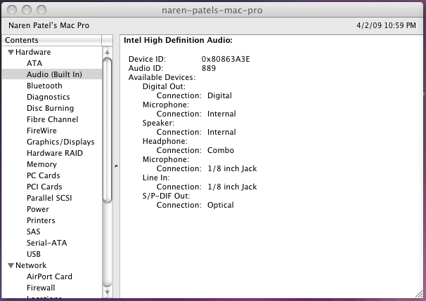

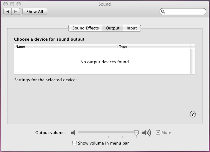

airwalk776 Posted April 4, 2009 Share Posted April 4, 2009 hello ALL 1st I want to thank you all for helping me . still new with this driver business. I have created a codec dump and from that created the verbs for my 889 on EVGA x58 mobo from that I have determined the node id's not that I have this info I dont know the correct place to plug into info in. 899A_verbs.rtf codec_dump_EVGA_x58.txt Link to comment https://www.insanelymac.com/forum/topic/140941-alc889a-gigabyte-intel-now-having-a-working-front-mic/page/10/#findComment-1123532 Share on other sites More sharing options...

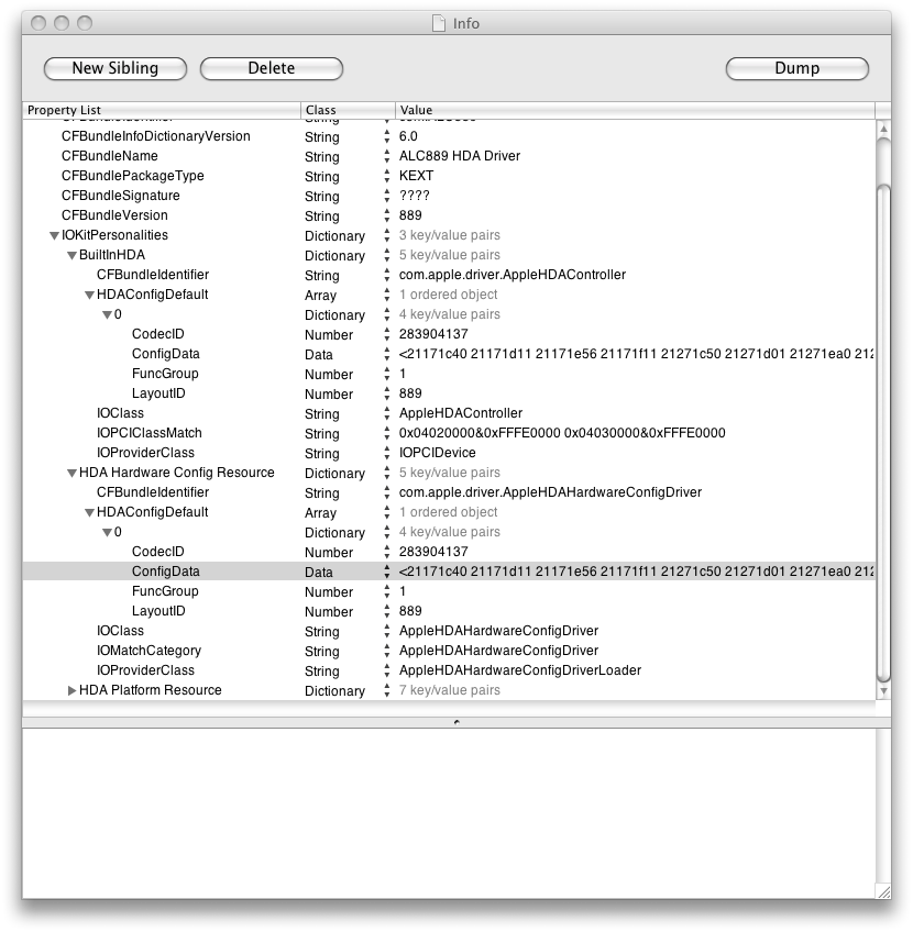

VCH888 Posted April 5, 2009 Author Share Posted April 5, 2009 @airwalk776 & alimn786 (I think you are not the same person. ) Try 1.5.7a24 EVGA X58.zip using KextHelper for installation. what I did: patched 85 08 ec 10 to 89 08 ec 10; change CodecID from 283904133 to 283904137 Link to comment https://www.insanelymac.com/forum/topic/140941-alc889a-gigabyte-intel-now-having-a-working-front-mic/page/10/#findComment-1124729 Share on other sites More sharing options...

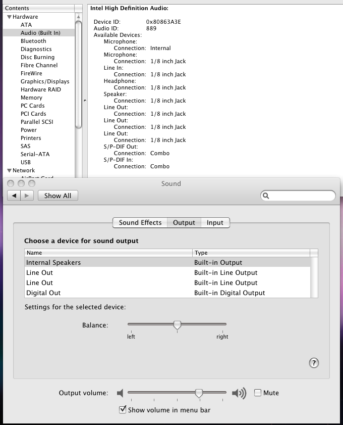

alimn786 Posted April 5, 2009 Share Posted April 5, 2009 @alimn786 You don't have to make any changes for now because I made them alrealy. I want you to try whether it works or not. see you tomorrow. Dear tmongkol Thank you very much, I can now see the input and output in the sound preferences. But no sound, as soon as I change the volume I start hearing beats coming out of speakers and the it freezes. i just need to use front sound-out (headphone) as I don't have 5.1 speakers What is wrong here? I would appreciate your help here. Thank you Malik Link to comment https://www.insanelymac.com/forum/topic/140941-alc889a-gigabyte-intel-now-having-a-working-front-mic/page/10/#findComment-1124829 Share on other sites More sharing options...
