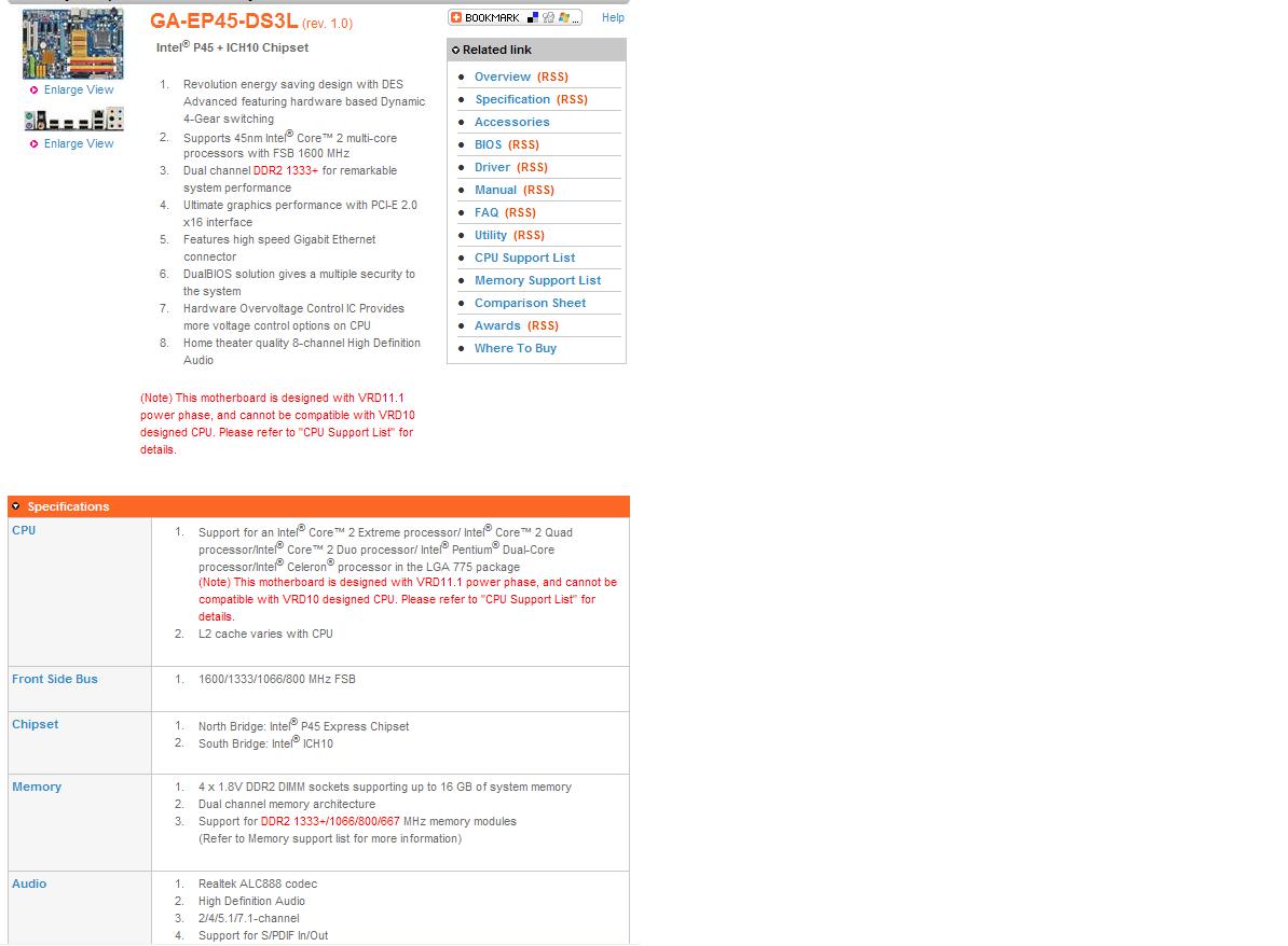

d3t0x Posted April 21, 2009 Share Posted April 21, 2009 Hi guys, There's great work going on here! I've spent many days trying to get my 889a to work. I keep having the same issue. I'm hoping someone here can help. I have 2 of these motherboards, 1 desktop where i'd like 5.1 analog and 1 htpc that needs spdif. info: -GA-EP45-DS3L (ALC889a) -currently using EFI-v9 (but also used chameleon 2 rc1 before i hosed my system) -theres no SMBios resolvers etc in my 'extra' folder (only AppleDecrypt, CPUDisabler, OpenHaltRestart & network files) -using AnV AppleSMBios.kext (33) -modded AppleHDA.kext is being placed into S/L/E w/ HDAEnabler to keep things simple for now (using 'extra' folder mkext made things worse) 1.6.2a37 4outs 3ins analog regular headphone: 1.6.2a37 4outs 3ins digital HDA headphone: 1.6.2a37 3outs 2ins analog regular headphone: 1.6.2a37 3outs 2ins digital HDA headphone: & 1.6.2a37 AppleHDA.kext from LS8v15 (Gigabyte board kext pkg): All give same result: -system profiler- Intel High Definition Audio: Device ID: 0x1458A002 Audio ID: 889 Available Devices: (none listed) error is: HDAEnabler: Copyright © 2008 by Kabyl HDAEnabler: 05/05/2008 Added SPAudio support:Taruga Sound assertion "0 == pathMap_aDriverInstance" failed in "/SourceCache/AppleHDA/AppleHDA-162.1.37/AppleHDA/AppleHDADriver.cpp" at line 1327 goto Exit Sound assertion "0 != createAudioEngines ( fPathMap_aDriverInstance )" failed in "/SourceCache/AppleHDA/AppleHDA-162.1.37/AppleHDA/AppleHDADriver.cpp" at line 127 goto Exit Now for my questions...... The 1st is obviously most important... 1) Can anyone tell me where to fix the "pathMap"? (i've read the kings guide and others, but its over my head)... 2) Is it possible to use coax instead of optical? (this is more for convenience, as my stereo doesnt have enough optical inputs, but not critical) 3) Can i use the same kext for both analog & digital outs? (again, more for convenience) Any help is GREATLY appreciated... I'm tired of banging my head on my desk.... Link to comment https://www.insanelymac.com/forum/topic/140941-alc889a-gigabyte-intel-now-having-a-working-front-mic/page/11/#findComment-1138769 Share on other sites More sharing options...
VCH888 Posted April 22, 2009 Author Share Posted April 22, 2009 Hi guys,There's great work going on here! I've spent many days trying to get my 889a to work. I keep having the same issue. I'm hoping someone here can help. I have 2 of these motherboards, 1 desktop where i'd like 5.1 analog and 1 htpc that needs spdif. info: -GA-EP45-DS3L (ALC889a) -currently using EFI-v9 (but also used chameleon 2 rc1 before i hosed my system) -theres no SMBios resolvers etc in my 'extra' folder (only AppleDecrypt, CPUDisabler, OpenHaltRestart & network files) -using AnV AppleSMBios.kext (33) -modded AppleHDA.kext is being placed into S/L/E w/ HDAEnabler to keep things simple for now (using 'extra' folder mkext made things worse) .............. @d3t0x GA-EP45-DS3L has Realtek ALC888, not ALC889a. For my understanding, any GA..w/DS3L UD3L UD3LR has ALC888. try these files. 1.5.7a24 888.zip 1.6.2a37 888.zip Link to comment https://www.insanelymac.com/forum/topic/140941-alc889a-gigabyte-intel-now-having-a-working-front-mic/page/11/#findComment-1138897 Share on other sites More sharing options...
d3t0x Posted April 22, 2009 Share Posted April 22, 2009 LOL !!!! OMG !!!! I'm building the EP45-UD3P for a friend, that must be where i got 889a. Well thanks man! I kinda feel like an idiot now, theres a few days i wont get back! I should have caught that!!! OK, I'll give it a try! Thanks again! edit: tmongkol, I owe a cold one my friend! I used the 1.6.2 version and 5.1 analog seems to work. However, after creating an aggregate audio device all channels work properly except for the subwoofer. The subwoofer (& test signal) comes out of my right & left channels and not the subwoofer. The result is unwanted distortion. Any ideas? I'll verify the digital outs in the morning.... Link to comment https://www.insanelymac.com/forum/topic/140941-alc889a-gigabyte-intel-now-having-a-working-front-mic/page/11/#findComment-1138912 Share on other sites More sharing options...

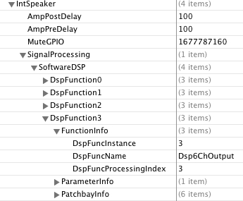

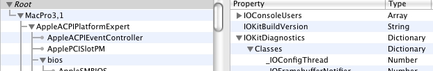

VCH888 Posted May 8, 2009 Author Share Posted May 8, 2009 Hi to all Today's Friday 8 May 2009 @ 9:30 am. I want to share my experience. I had tried to get 6ch outputs of GA-EP35-DS3P for 5 hours last night and it worked. It was not using aggregate devices. I will explain what I did. First, I openned IORegistryExplorer to see all registries (that I did many times). I expanded Classes, see picture below. I srolled down to see what they were. It showed me audio devices, see picture below. And I scrolled down again until I saw DspFunc6ChOutput. It was interesting. I tried to search information how to on Google but nothing. After that, I explored AppleHDAPlatformDriver.kext to see which LayoutID had this function and I found LayoutID 70. Then, I tried to edit LayoutID and PathmapID to be set to 8851, see attached file. I just copied SignalProcessing of LayoutID 70's IntSpeaker and patsed into LayoutID 8851 (item2 of my edited kext). I still don't know how to get numbers of SignalProcessing and what they are. 8851.zip Keep in mind; -- Layout and Pathmap must be related each other. My GA-EP35-DS3P's ALC889a is ALC885 (10EC0885). You may try other output functions. -- Got only Stereo thru 6Ch., not 5.1. -- I will not put this information on the first post. I really want to know which MAC system is using LayoutID 70. I want to get a codec dump of ALC885 and it's inputs & outputs. If anyone can, I appreciate that. Warning: When I started up my system, I heard annoying sound. So, I got to turn off my speakers. Or, if I unpluged my headphone, I heard the annoying sound one time. The sound was like sparking sound. This is for experiment only. TRY AT YOUR OWN RISK. 2 Link to comment https://www.insanelymac.com/forum/topic/140941-alc889a-gigabyte-intel-now-having-a-working-front-mic/page/11/#findComment-1150872 Share on other sites More sharing options...
