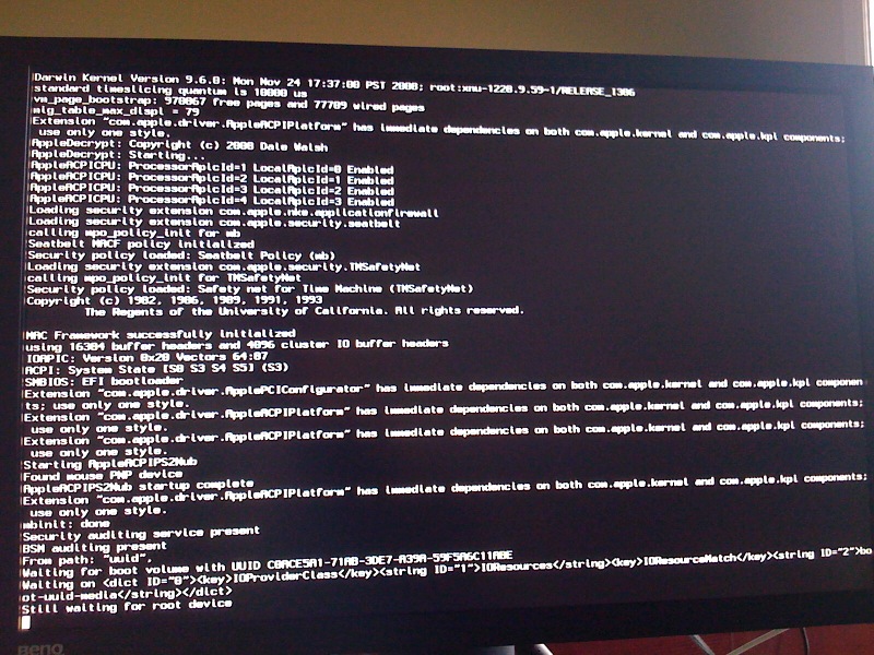

sparkdude Posted April 7, 2009 Share Posted April 7, 2009 Hi guys. I'm trying to do an install as well, here's what I have : Asus P5Q (plain) Q9550 SATA DVD IDE HD <--- installing on IDE, not SATA (which is why I have so much trouble finding someone having the same problems - everybody uses SATA) I'm using IDeneb 1.4 (10.5.6). I flashed JUZZI's mbios 1611, loaded defaults, set SATA to AHCI. Installer boots from DVD, I see the IDE hard disk. Do an 'erase...' in Disk Utility, choose MacOS Extended(Journaled) - I'm not sharing the drive with another OS. I tried picking the Marvell chipset driver for my IDE (and also NOT picking it, tried multiple installs, none worked). Each time, the installer completes fine. When I reboot, the OS starts loading (I use -v), but I get stuck at "waiting for root device...". Suggestions ? Thanks. Link to comment https://www.insanelymac.com/forum/topic/137296-mac-osx-on-asus-p5q-and-asus-p5q-pro-and-some-other-p5q-mobo-also/page/17/#findComment-1126547 Share on other sites More sharing options...

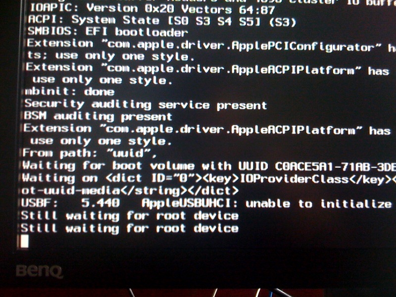

sparkdude Posted April 7, 2009 Share Posted April 7, 2009 Try to motherboard Fireware disableTry to motherboard sound card disabled Try to motherboard Network card disabled Went in and disabled all three. Tried booting, got this (seems like it got a bit further, but still waiting for root device) : I mentioned I selected the Marvell chipset from the available packages - I'm starting to wonder if I shouldn't try and inject + set perms using the specific package for the Marvel IDE on the P5Q. I'm also downloading iATKOS_5i, if I don't get any further I might try that tonight. EDIT: Just tried iATKOS, boots to the installer fine, but it doesn't see my IDE hard drive... bummer! Also, am I right in simply going into Disk Utility and using "erase..." with MacOS Extended(journaled)", or should I be using some manual partitioning ? Ideas are welcome, and thanks Fecso for the quick reply. Link to comment https://www.insanelymac.com/forum/topic/137296-mac-osx-on-asus-p5q-and-asus-p5q-pro-and-some-other-p5q-mobo-also/page/17/#findComment-1126627 Share on other sites More sharing options...
Slyrfecso Posted April 8, 2009 Share Posted April 8, 2009 I think you have problem with USB initializing. Please do not connect usb device, and try in bios all usb port off or automatical. Try with PS2 mouse and keyboard, i think you will use PS2 and USB patchs in install. Try only one element on motherboard on, and you can see what dos not boot! (Fireware, sound, Network, USB) Link to comment https://www.insanelymac.com/forum/topic/137296-mac-osx-on-asus-p5q-and-asus-p5q-pro-and-some-other-p5q-mobo-also/page/17/#findComment-1127183 Share on other sites More sharing options...

sparkdude Posted April 8, 2009 Share Posted April 8, 2009 I think you have problem with USB initializing.Please do not connect usb device, and try in bios all usb port off or automatical. Try with PS2 mouse and keyboard, i think you will use PS2 and USB patchs in install. Try only one element on motherboard on, and you can see what dos not boot! (Fireware, sound, Network, USB) Tried with all of the above turned off again (PS2 mouse and keyboard). Still not finding the root device. At this point I'm thinking of just running out and buying a 250-300gig SATA drive... I have a feeling the IDE is the problem here. Link to comment https://www.insanelymac.com/forum/topic/137296-mac-osx-on-asus-p5q-and-asus-p5q-pro-and-some-other-p5q-mobo-also/page/17/#findComment-1127425 Share on other sites More sharing options...
RoberT_XeS Posted April 9, 2009 Author Share Posted April 9, 2009 Tried with all of the above turned off again (PS2 mouse and keyboard). Still not finding the root device. At this point I'm thinking of just running out and buying a 250-300gig SATA drive... I have a feeling the IDE is the problem here. Yes IDE is the problem..... It is not that easy to install OSX on IDE....Even I used to look around many threads to find a solution for installing OSX on IDE... You can just buy a IDE to SATA Converter and then try to install and it will wrok... The converter is very cheap you can buy it easily..... Link to comment https://www.insanelymac.com/forum/topic/137296-mac-osx-on-asus-p5q-and-asus-p5q-pro-and-some-other-p5q-mobo-also/page/17/#findComment-1127890 Share on other sites More sharing options...
sparkdude Posted April 9, 2009 Share Posted April 9, 2009 Yes IDE is the problem..... It is not that easy to install OSX on IDE....Even I used to look around many threads to find a solution for installing OSX on IDE... You can just buy a IDE to SATA Converter and then try to install and it will wrok... The converter is very cheap you can buy it easily..... Alright - I solved the problem. The solution is very simple : Use the latest iPC 10.5.6 instead of iDeneb 1.4. iPC has the appropriate drivers to setup the ICH10R that's on the P5Q motherboard. It doesn't even need you to be in AHCI mode, you can simply have the standard IDE. You can install from an IDE DVD drive on an IDE hard drive... So Use iPC, and in the patches, select ICH10R, and also Marvell in the chipset section - you're good to go. I have it installed, IDE hard drive & DVD, sound works, SATA works, ethernel (Atheros Gb) works... beautiful. I recommend iPC 10.5.6 to anyone who's using a P5Q in general - and especially if you're considering installing on IDE (and also FROM an IDE optical drive). Now, if I can find working drivers for my 4870X2... Thanks for everybody's input, much appreciated. Happy OSX86'ing! Link to comment https://www.insanelymac.com/forum/topic/137296-mac-osx-on-asus-p5q-and-asus-p5q-pro-and-some-other-p5q-mobo-also/page/17/#findComment-1128259 Share on other sites More sharing options...
