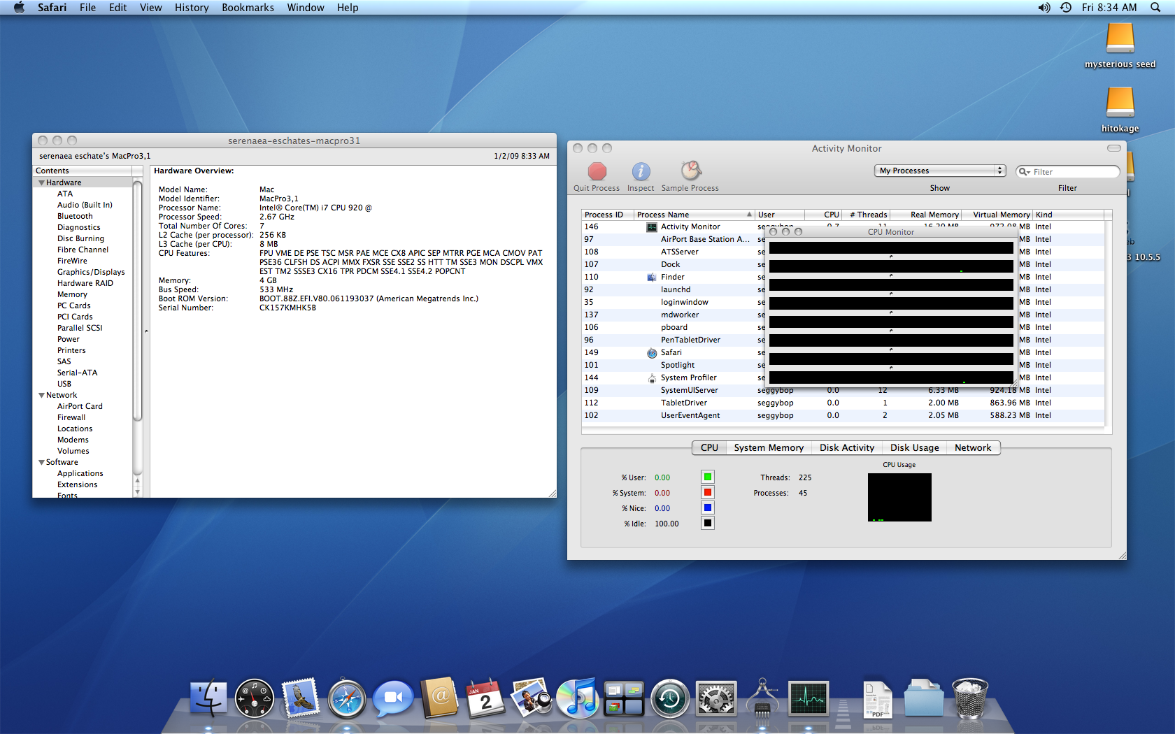

Seggybop Posted January 2, 2009 Share Posted January 2, 2009 MSI Platinum 8 cores working! DSDT patcher was successful. The reason it wasn't working before was that I was newbsauce and didn't realize that the version of Chameleon included with iDeneb 1.3 didn't include the modification to look for DSDT.aml. Everything motherboard-related that I've tested so far is working, except for sound. I think there are some specially modified files for the ALC888 made for older MSI boards around somewhere that might work but I haven't tried it yet because my m-audio 2496 PCI card is working with the audio-evolution envy24 driver. The only issue I'm encountering now is with the video card (G92 8800GTS). Strange texture corruption in WoW (the only thing I have to test 3D) where textures/menus are randomly replaced with garbage or stripes. It looks the same as you'd see if the gfx card memory was messed up, but I know this card is perfectly functional in Windows. I've tried nvinject and nvkush and both have the same result. nevermind, also seems to have been fixed by DSDT! palamosteliaro, I was getting the same MAC Framework error until I followed your instructions, which worked perfectly, so it is really strange. You were only doing two things differently: enabling ACPI fix and not enabling ICHx chipset driver. I think it was the ACPI fix that solved it. So, make sure you still have the ACPI fix, and that you didn't change any APIC / ACPI things in the bios. Link to comment https://www.insanelymac.com/forum/topic/132960-upcoming-intel-x58-mobos-core-i7-cpus/page/19/#findComment-1023469 Share on other sites More sharing options...
