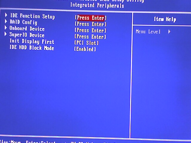

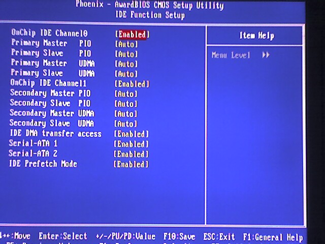

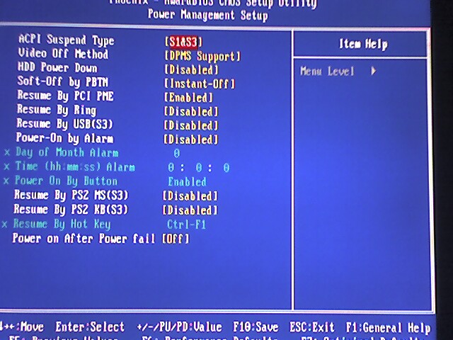

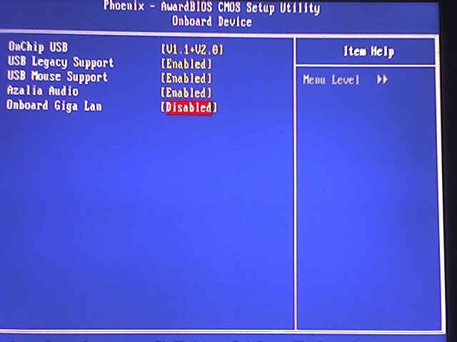

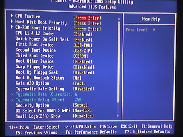

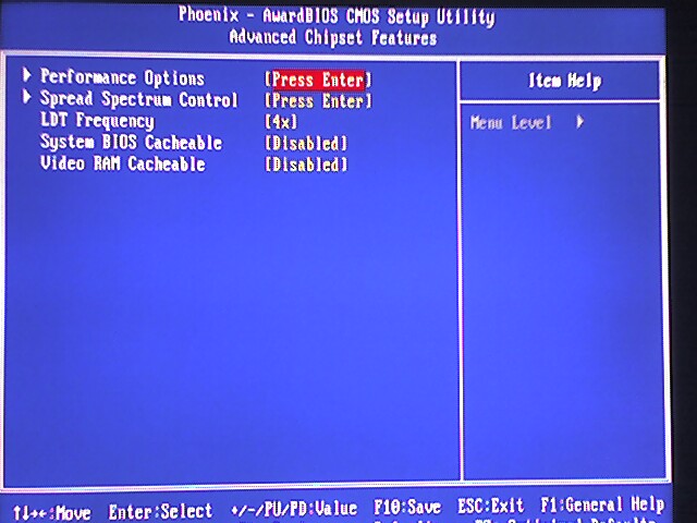

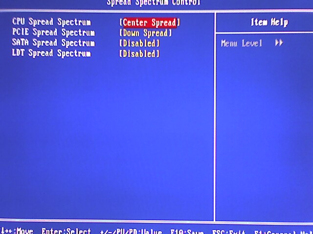

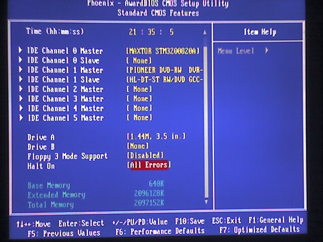

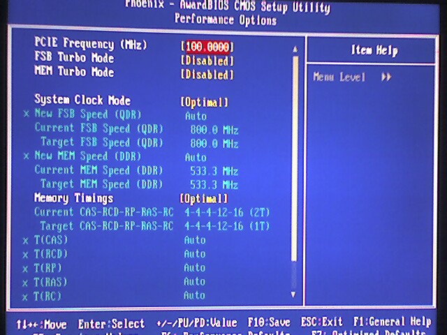

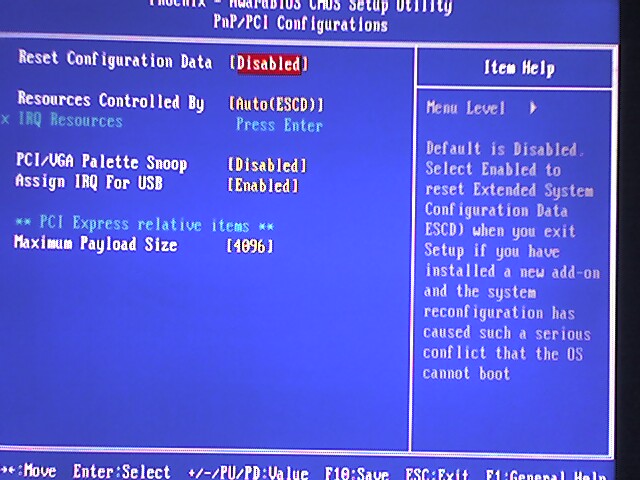

verdant, thanks for linking me to this guide. The only BIOS change I could find was disabling the onboard LAN. Any other ideas?
1. ecs nforce 570 slit-a v5.1
2. nForce 570 SLI northbridge, MCP51 southbridge
3. Pentium D 2.8GHz stock speed dual core
4. [see below]
5. Pioneer DVD-RW (DVR-111D), LG CD-RW (GCC-4482B)
6. Single 200 GB PATA drive, no raid
7. Partitioning [NTFS/Windows], [EXT3/Ubuntu], [Linux Swap], [HFS+/OSx86]
8. Windows XP, Ubuntu 8.04, OSx86 hoping to triple boot from Grub (not set in stone)
9. Leadtek 128MB GeForce 6200 PCIe (PX6200TD), no SLI
10. no expansion cards installed
11. Realtek ALC883 audio, Marvell 88E1116 LAN, 4 USB ports,
1. Attempted install of Kalyway 10.5.2 and iAtkos 5i.
2. Kalyway reboots shortly after OS selection. iAtkos gives gray loading screen with HDD activity for 15 seconds, then hangs.
1. In BIOS disable Resume by PCI......also check that you have ACPI APIC Support [Enabled]
2. Boot from Kalyway 10.5.2 DVD with "-v cpus=1" but if you have more than 2GB RAM installed then use "-v maxmem=2048"......
3. Suggest that you initially install Kalyway 10.5.2 without initially making any video, network or audio selections in Customize menu

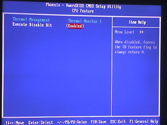

What is the model number of your Pentium D dual core......
If 920 then in BIOS you should have
Execute Disable Bit [Enabled]
Enhanced Intel SpeedStep Technology [Disabled]
Virtualisation [Disabled]
If 915 or 820 then in BIOS you should have
but may not have Virtualisation parameter but if you do, then set it to [Disabled]
Pentium D comparison chart
According to that, my chip only has disable execute bit. Is there a way I can unlock those other features? Just to verify, you think I should install Kalyway with no customization at all, as in sleepkernel and not nforcekernel.
Also, any possible explanation why when I boot the DVD in normal mode, I get 7's scrolling the screen after the kernel linker gets deployed? When I boot in safe mode, my keyboard goes dead. I'm using both ps/2 KB and mouse.
Those other features if present would be disabled.
Follow the Customize selections in my post so that we can hopefully get a basic system working......assuming your BIOS settings match the template for key settings
Limit CPUID MaxVal (Enabled, Disabled)
(Enhanced) Intel SpeedStep (Enabled, Disabled)
CPU (Internal) Thermal Control (Disabled, TM1 Only, TM2 Only, TM1 & TM2)
(Enhanced C1) C1E Enhanced Halt State (Enabled, Disabled)
Execute Disable Bit (Enabled, Disabled)
Virtualization Technology (Enabled, Disabled)
ACPI Suspend Type (S1&S3, S1(POS), S3(STR))
ACPI APIC Support (Disabled, Enabled)
Use a USB keyboard and mouse.......it will cause far fewer problems.......
Once system is working then video, audio and networking can be sorted.......
