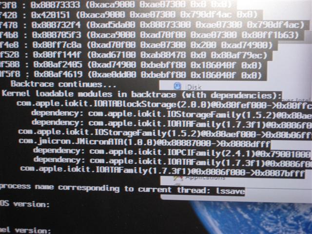

mikedually Posted January 29, 2009 Share Posted January 29, 2009 As in my previous post I cant boot the dvd. Does anyone know how i can boot the dvd. The BIOS boot priority is set to dvd and it won't boot. Is there another way for me to boot the DVD. This is the kernel panic Im getting after an accidental software update. PLEASE HELP! I can pay someone if thats what its going to take im desperate at this point. I am not versed in computers but I have a hackintosh running leopard 10.5.2 with 4 gigs of ram, intel quad core 2.4 ghz ddr2 800, nvidia 8500 gt 512 mb. 500gb SATA-II. Link to comment https://www.insanelymac.com/forum/topic/127611-appleviaata-over-4gb-ram-bug-solved-at-least-i-believe-so-jmicron-and-applenforceata-at-development/page/12/#findComment-1061333 Share on other sites More sharing options...

mikedually Posted January 30, 2009 Share Posted January 30, 2009 so nobody knows how to get the dvd to boot with the panic kernel i have pictured above. is it that bad that there is no fix??? Link to comment https://www.insanelymac.com/forum/topic/127611-appleviaata-over-4gb-ram-bug-solved-at-least-i-believe-so-jmicron-and-applenforceata-at-development/page/12/#findComment-1062579 Share on other sites More sharing options...

slashack Posted February 2, 2009 Author Share Posted February 2, 2009 As in my previous post I cant boot the dvd. Does anyone know how i can boot the dvd. The BIOS boot priority is set to dvd and it won't boot. Is there another way for me to boot the DVD. This is the kernel panic Im getting after an accidental software update. PLEASE HELP! I can pay someone if thats what its going to take im desperate at this point. I am not versed in computers but I have a hackintosh running leopard 10.5.2 with 4 gigs of ram, intel quad core 2.4 ghz ddr2 800, nvidia 8500 gt 512 mb. 500gb SATA-II. Can u boot any dvd? Maybe osx dvd is scratched, or doesn't work. U need to boot from dvd and remove AppleIntelCPUPowerManagement.kext. U can use either any osx dvd that boots in your system, or windows with macdrive, or any linux with hfs support. Link to comment https://www.insanelymac.com/forum/topic/127611-appleviaata-over-4gb-ram-bug-solved-at-least-i-believe-so-jmicron-and-applenforceata-at-development/page/12/#findComment-1066386 Share on other sites More sharing options...
mikedually Posted February 2, 2009 Share Posted February 2, 2009 thanks for responding slash....i bought a new osx leopard dvd and it won't boot. I dont hear the dvd even spool or spin up.... I don't have windows intalled on it so i cant use that.... i have never done linux or hfs...is there a way to force the dvd to boot? Link to comment https://www.insanelymac.com/forum/topic/127611-appleviaata-over-4gb-ram-bug-solved-at-least-i-believe-so-jmicron-and-applenforceata-at-development/page/12/#findComment-1066508 Share on other sites More sharing options...
slashack Posted February 3, 2009 Author Share Posted February 3, 2009 thanks for responding slash....i bought a new osx leopard dvd and it won't boot. I dont hear the dvd even spool or spin up.... I don't have windows intalled on it so i cant use that.... i have never done linux or hfs...is there a way to force the dvd to boot? Download ubuntu live cd, burn it at the lowest speed. try booting with that. Is your drive plugged correctly? Does the bios detect it? Link to comment https://www.insanelymac.com/forum/topic/127611-appleviaata-over-4gb-ram-bug-solved-at-least-i-believe-so-jmicron-and-applenforceata-at-development/page/12/#findComment-1066904 Share on other sites More sharing options...
