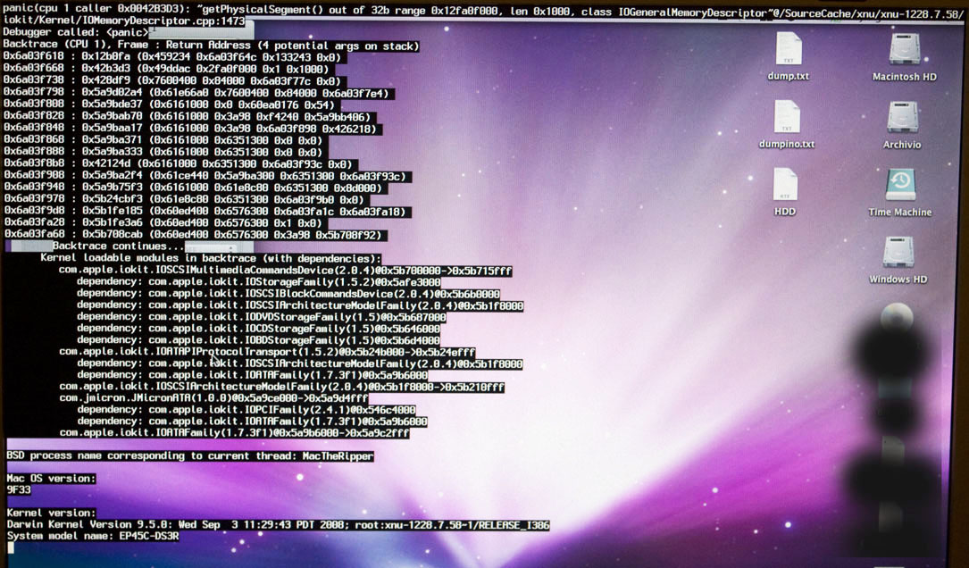

B612 Posted November 27, 2008 Share Posted November 27, 2008 Boot with -v debug=0x100 and force the panic. Then take a picture of the screen (the whole screen!) and post it. Thank you very much for your interest. Sorry for the delay of my reply, but I've been out for awhile. Here is a screen on my panic. Please let me know what you think. Link to comment https://www.insanelymac.com/forum/topic/127611-appleviaata-over-4gb-ram-bug-solved-at-least-i-believe-so-jmicron-and-applenforceata-at-development/page/7/#findComment-980139 Share on other sites More sharing options...

slashack Posted November 28, 2008 Author Share Posted November 28, 2008 Thank you very much for your interest. Sorry for the delay of my reply, but I've been out for awhile.Here is a screen on my panic. Please let me know what you think. It seems to be an issue with the ammount of ram u have, but it's the kernel who is having issues. The kext u need is JMicronATA. Try the last version (from googlecode). In the second line of the kp log (it's the last part of the first line) shows that the getPhysicalSegment() call that is failing, is being made from IOMemoryDescriptor.cpp at line 1473. JMicronATA is shown in the backtrace, but when i had issues with this driver, the getPhysicalSegment() failing call was made from JMicronATAChannel.cpp, not the kernel. I'm kind of busy right now, but as soon as i get some free time, i'll try to get involved with this issue. If u manage to get some more info, just tell me. Can someone help me?I have a Gigabyte X38-DQ6.. I don't know what kext should i use.. slashack here's dump.txt i used finder and found some references to JmicronATA in that file.. can you tell me what kext should i use? thanks You are right. JMicronATA.kext is the one for you. That would really help me too... And does anyone know how i can get dvd reading working again? It was working with the test Apple nForce but not with this kext? Thnx! Do you mean the AppleNForceATA kext that fixed some issues with some DVD drives and is somewhere in this forum? Found it: http://forum.insanelymac.com/index.php?showtopic=77071 It's from MeDevil. I posted in his thread, but got no answer. I need the source code to fix that kext, or fix my kext to solve your issue. The bad news is that i don't even know whats the problem and i don't have such hw, so the only thing i can do right now is to wait for the source (or for some god to start sending money to buy that hw). I'll keep waiting... Yes, its OK now. Better seperate the debug drivers from the normal drivers and add an information line to it. Now it works. The boot process looks much better now ;-) I'm actually using the Voodoo XNU 9.5.0 RC kernel, too. To fill the memory I didn't use Rember, I filled it with real applications. I was running Parallels, Logic, Motion, Mainstage, Final Cut, Aperture, Preview, Activity Monitor, Mail and the web browser iCab. So I filled up to 3,79 GB RAM. Then I opened Toast and created a 7,65 GB dvd with over 33.000 files from 3 different harddisks. (To get so many files I used the HVSC, the High Voltage SID Collection). Toast worked w/o problems and wrote the image in 2:45 mins. Great! Excellent work, slashack! Now if the driver would get a speedup boost you would have solved the last big problem I have. About the boost, what's the problem u are having? is it too slow? Keep in mind that this drivers are for ATA drives (they are pretty slow) and were made for some Tiger version. I didn't re wroted them, just used some IOKit api to make 64 bit DMA. But if u think it's a bug, or an issue that can be solved, just tell me more. Link to comment https://www.insanelymac.com/forum/topic/127611-appleviaata-over-4gb-ram-bug-solved-at-least-i-believe-so-jmicron-and-applenforceata-at-development/page/7/#findComment-980405 Share on other sites More sharing options...

B612 Posted November 28, 2008 Share Posted November 28, 2008 It seems to be an issue with the ammount of ram u have, but it's the kernel who is having issues. The kext u need is JMicronATA. Try the last version (from googlecode). In the second line of the kp log (it's the last part of the first line) shows that the getPhysicalSegment() call that is failing, is being made from IOMemoryDescriptor.cpp at line 1473. JMicronATA is shown in the backtrace, but when i had issues with this driver, the getPhysicalSegment() failing call was made from JMicronATAChannel.cpp, not the kernel. I'm kind of busy right now, but as soon as i get some free time, i'll try to get involved with this issue. If u manage to get some more info, just tell me. Slashack, how can it be the kernel, if I am using the Vanilla one? Isn't it very strange? I have already downloaded (and used) the last version of your JMicronATA from GoogleCode. I keep having the same results. Could it be something changeable from the BIOS? Link to comment https://www.insanelymac.com/forum/topic/127611-appleviaata-over-4gb-ram-bug-solved-at-least-i-believe-so-jmicron-and-applenforceata-at-development/page/7/#findComment-980582 Share on other sites More sharing options...

B612 Posted November 29, 2008 Share Posted November 29, 2008 Hey Slashack, I have solved my problem! THANK YOU. Apparently, it was not working because I was making a terribly stupid mistake. I was loading JMicron in a wrong way. At the moment, I am loading your version from the EFI partition. I have modified the strings, in order to load only the IOPCIPrimaryMatch I need (0x2368197b). The others were creating conflicts. I noticed the bin file is different from the one of Leopard. Is it from Tiger? Is there a way to use the bin from Leopard, so that I can load only the plist file from the EFI partition? Please let me know. Link to comment https://www.insanelymac.com/forum/topic/127611-appleviaata-over-4gb-ram-bug-solved-at-least-i-believe-so-jmicron-and-applenforceata-at-development/page/7/#findComment-981371 Share on other sites More sharing options...

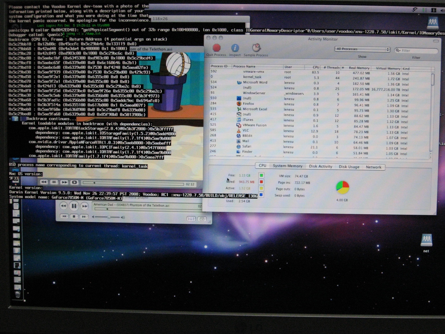

lenesu Posted December 5, 2008 Share Posted December 5, 2008 Hi slashack, thanks for your work I'm having kernel panics with your appleNforceAta . I didnt use the kexts but instead downloaded the source code and compiled with "forced 80pin cable detection" (unfortunately the standard nfroceAta doesnt detect it and gives me udma 2 instead of 6 so I had to correct some portions of the code. It worked for me well with meDevils driver but now when i added another 2Gb of Ram both yours and his versions give me kernel panics). Does the source code from code.google differ from the kexts that you've posted? here is my dump and screenshot. dump.txt Link to comment https://www.insanelymac.com/forum/topic/127611-appleviaata-over-4gb-ram-bug-solved-at-least-i-believe-so-jmicron-and-applenforceata-at-development/page/7/#findComment-988893 Share on other sites More sharing options...
slashack Posted December 5, 2008 Author Share Posted December 5, 2008 Hi slashack, thanks for your work I'm having kernel panics with your appleNforceAta . I didnt use the kexts but instead downloaded the source code and compiled with "forced 80pin cable detection" (unfortunately the standard nfroceAta doesnt detect it and gives me udma 2 instead of 6 so I had to correct some portions of the code. It worked for me well with meDevils driver but now when i added another 2Gb of Ram both yours and his versions give me kernel panics). Does the source code from code.google differ from the kexts that you've posted? here is my dump and screenshot. dump.txt You are having the same issue B612 had. Look in the picture, the panic is made from inside the kernel's iokit and not from the kext. Ask him the solution. Link to comment https://www.insanelymac.com/forum/topic/127611-appleviaata-over-4gb-ram-bug-solved-at-least-i-believe-so-jmicron-and-applenforceata-at-development/page/7/#findComment-988960 Share on other sites More sharing options...
