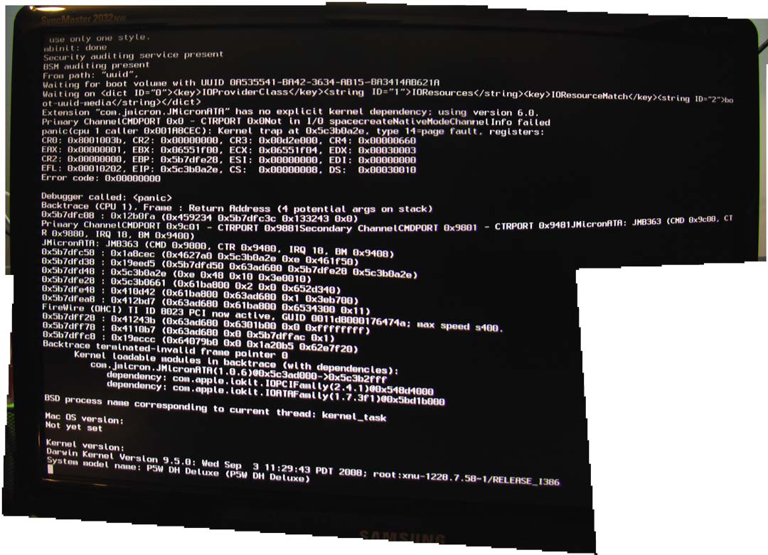

rsilves Posted December 20, 2008 Share Posted December 20, 2008 thatçs a kernel panic. boot with -v debug=0x100 and send another photo Ok. Maybe it makes some difference, so I'll tell you: After the last message I wrote, I downloaded JMicron's driver (from their ftp), installed it (has an installer), restarted (JMicron set as Basic on BIOS), same thing (doesn't show up), then installed your JMicron kext again (using Kext helper, but without using JMicron's uninstaller). Restarted, changed JMicron to AHCI on BIOS. So, there is the kernel panic. So, it should work on AHCI mode? Or in Basic? My BIOS vers. is 2704. Thank you, Rodrigo (Photoshop's Photomerge is the best!) Link to comment https://www.insanelymac.com/forum/topic/127611-appleviaata-over-4gb-ram-bug-solved-at-least-i-believe-so-jmicron-and-applenforceata-at-development/page/9/#findComment-1006771 Share on other sites More sharing options...

rsilves Posted December 22, 2008 Share Posted December 22, 2008 Any idea of what can that kernel panic error mean? Thanks, Rodrigo Link to comment https://www.insanelymac.com/forum/topic/127611-appleviaata-over-4gb-ram-bug-solved-at-least-i-believe-so-jmicron-and-applenforceata-at-development/page/9/#findComment-1010340 Share on other sites More sharing options...
slashack Posted December 22, 2008 Author Share Posted December 22, 2008 Any idea of what can that kernel panic error mean? Thanks, Rodrigo That's something related to ATA channel info creation. What's your dev id? What's your setting in bios (AKA are you using SATA in IDE or AHCI mode)? Link to comment https://www.insanelymac.com/forum/topic/127611-appleviaata-over-4gb-ram-bug-solved-at-least-i-believe-so-jmicron-and-applenforceata-at-development/page/9/#findComment-1010362 Share on other sites More sharing options...

slashack Posted December 24, 2008 Author Share Posted December 24, 2008 Did these commands: ioreg -l >dump.txt umane -a > uname.txt (both files attached here) Rodrigo I see u have 2 ata channels (that's what the JMicronATA.kext is being loaded). how are your drives connected? how many sata? hoy many ata? your dvd? I see u have 2 ata channels (that's what the JMicronATA.kext is being loaded). how are your drives connected? how many sata? hoy many ata? your dvd? Try this kext and show me a photograph of the panic. It will show more info for me to locate the problem. JMicronATA.kext.zip Link to comment https://www.insanelymac.com/forum/topic/127611-appleviaata-over-4gb-ram-bug-solved-at-least-i-believe-so-jmicron-and-applenforceata-at-development/page/9/#findComment-1012148 Share on other sites More sharing options...

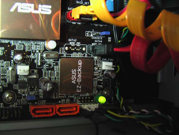

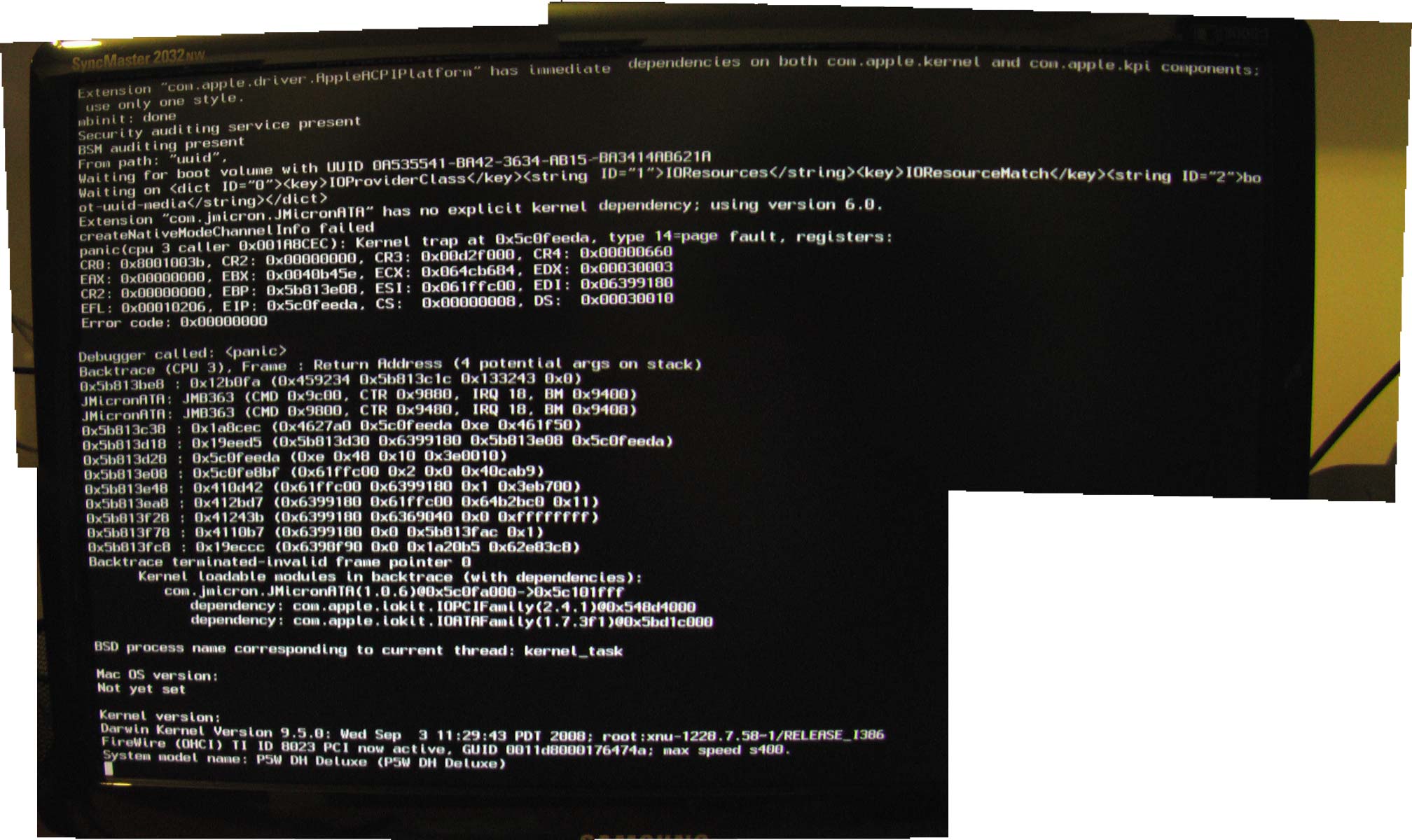

rsilves Posted December 24, 2008 Share Posted December 24, 2008 I see u have 2 ata channels (that's what the JMicronATA.kext is being loaded). how are your drives connected? how many sata? hoy many ata? your dvd? Try this kext and show me a photograph of the panic. It will show more info for me to locate the problem. My Mobo has 6 SATA ports and 1 eSATA. Pic1: 3 "normal" ICH7R SATA, named SATA1, SATA3 and SATA4. 2 SATA ports for RAID (Asus EZ_BACKUP, not in use), also related to ICH7R I think. SATA1: (Yellow) 250GB WD boot HD. SATA3: (Red, next to SATA1) Pioneer DVD-RW. SATA4: (Red) 1st Seagate 500GB. Pic2: 1 SATA port controlled by JMicron: 2nd Seagate 500GB. I installed the Kext you sent, restarted (JMicron was set as "Basic"), nothing new, computer works, new drive doesn't show up. Restarted, changed JMicron setting to AHCI. -v debug=0x100 Kernel panic (picture). Restarted, went back to "Basic". Thanks again, Rodrigo Edit: Forgot to say: This mobo has 2 IDE ports. 1 controlled by JMicron and 1 by ICH7R. I am using the one controlled by ICH7R for my CDRW. JMicron's one is free. Link to comment https://www.insanelymac.com/forum/topic/127611-appleviaata-over-4gb-ram-bug-solved-at-least-i-believe-so-jmicron-and-applenforceata-at-development/page/9/#findComment-1012177 Share on other sites More sharing options...
slashack Posted December 24, 2008 Author Share Posted December 24, 2008 My Mobo has 6 SATA ports and 1 eSATA.Pic1: 3 "normal" ICH7R SATA, named SATA1, SATA3 and SATA4. 2 SATA ports for RAID (Asus EZ_BACKUP, not in use), also related to ICH7R I think. SATA1: (Yellow) 250GB WD boot HD. SATA3: (Red, next to SATA1) Pioneer DVD-RW. SATA4: (Red) 1st Seagate 500GB. Pic2: 1 SATA port controlled by JMicron: 2nd Seagate 500GB. I installed the Kext you sent, restarted (JMicron was set as "Basic"), nothing new, computer works, new drive doesn't show up. Restarted, changed JMicron setting to AHCI. -v debug=0x100 Kernel panic (picture). Restarted, went back to "Basic". Thanks again, Rodrigo Edit: Forgot to say: This mobo has 2 IDE ports. 1 controlled by JMicron and 1 by ICH7R. I am using the one controlled by ICH7R for my CDRW. JMicron's one is free. What's happenin to you is really really weird. Try this one, it tries to use Legacy mode if native mode fails. JMicronATA.kext_Legacy_.zip Link to comment https://www.insanelymac.com/forum/topic/127611-appleviaata-over-4gb-ram-bug-solved-at-least-i-believe-so-jmicron-and-applenforceata-at-development/page/9/#findComment-1012198 Share on other sites More sharing options...
rsilves Posted December 24, 2008 Share Posted December 24, 2008 What's happenin to you is really really weird. Try this one, it tries to use Legacy mode if native mode fails. Hey it worked! I copiedo 20GB of files and had no problems at all... Do you think you need to improve it? I mean, because of the weird feeling you have about this case. Thank you!! Rodrigo Edit: Forgot to say that it worked under "AHCI" config. With "Basic" it did the same as always. Link to comment https://www.insanelymac.com/forum/topic/127611-appleviaata-over-4gb-ram-bug-solved-at-least-i-believe-so-jmicron-and-applenforceata-at-development/page/9/#findComment-1012206 Share on other sites More sharing options...
