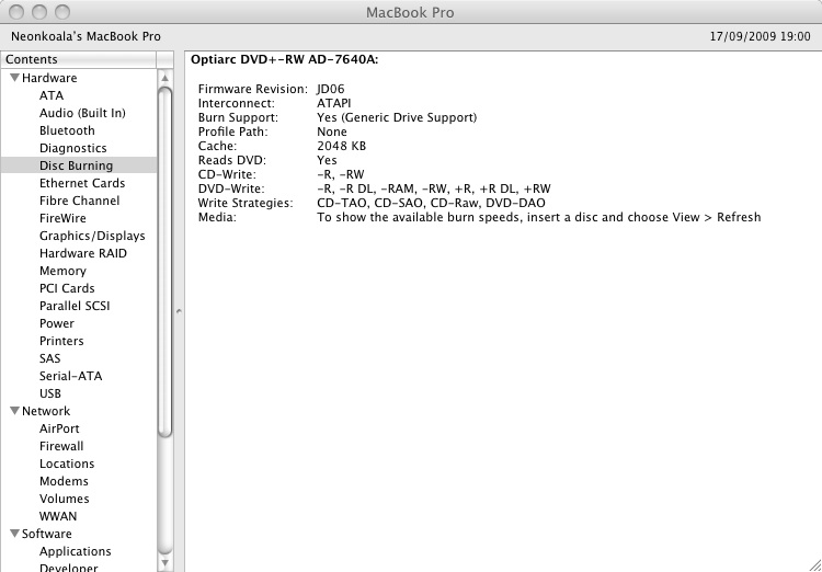

Neonkoala Posted September 17, 2009 Share Posted September 17, 2009 For Snow Leopard users, there's a fixed IOATAFamily compiled from Snow sources available in this thread from sigmaris which fixes the Secondary IDE channel disabled problem that laptop users have been encountering. Works great on my M1530 under snow. Haven't tested x64 as I don't see the point atm. Link to comment https://www.insanelymac.com/forum/topic/119654-guide-leopard-on-an-xps-13301530/page/31/#findComment-1270473 Share on other sites More sharing options...
Brett Whinnen Posted September 17, 2009 Share Posted September 17, 2009 For Snow Leopard users, there's a fixed IOATAFamily compiled from Snow sources available in this thread from sigmaris which fixes the Secondary IDE channel disabled problem that laptop users have been encountering. Works great on my M1530 under snow. Haven't tested x64 as I don't see the point atm. Works perfectly under 32 and 64 bit Hope this is the Script. Ill giveit a try. By the way if this help any one. I've modified "Brett's" DSDT for my CPU (T7250). Its Still on observation. At least I have kernel panics do to other stuff not cpu load. Use at your own risk: By the way if this help any one. I've modified "Brett's" DSDT for my CPU (T7250). Its Still on observation. At least I have kernel panics do to other stuff not cpu load. Use at your own risk (rename): That is the right script to get permissions right. Also with the LHS USB, I've found that if I run that script, then boot with a -f I seem to get the LHS USB back. However I need to kextlaod /Extra/Extensions/VoodooHDA.kext manually... I've attached a DSDT for you based on my current DSDT but has your _PSS tables and your main SSDT definition. Let me know how it goes. Just run it through iaslme or iasl whatever method you use and go from there. There should be zero errors and zero optimizations as I've cleaned it up. You will get speed step working but still no CST tables loaded DSDT_T7250.dsl.zip Cheers Brett Link to comment https://www.insanelymac.com/forum/topic/119654-guide-leopard-on-an-xps-13301530/page/31/#findComment-1270588 Share on other sites More sharing options...
overshoot Posted September 17, 2009 Share Posted September 17, 2009 Works perfectly under 32 and 64 bit Also with the LHS USB, I've found that if I run that script, then boot with a -f I seem to get the LHS USB back. However I need to kextlaod /Extra/Extensions/VoodooHDA.kext manually... Hi Neonkoala, Thanks for the tip, i've also seen the post from Superhai with this new kext. So thank you guys, ATA is back! ;-) Brett, I'm getting the same issue as yours. With the Brandon's DSDT, i've never got an issue with Usb but, with the Chrysaor's one (modified by yourself for our CPU) i can't get the left Usb Bus to work. As i'm not familiar with DSDT in general, i will need to do some test to get the Usb back as before but if somebody could tell us what to do, it would be very helpful. I do not have much time these days to spend for this... Just to be clear, i would like to thanks Chrysaor again for giving us the possibility to get vanilla speedstep on our hacks which is great (less mod kexts to be as vanilla as possible). Last, same issue here for voodoohda. My Hd break yesterday for which Dell replaced by a new one. So i decided to move totally from Leopard to SL using a vanilla DVD with the DellBoot cd from Superhai. Now voodoohda do not loads itself and i need to kextload it at every boot but i can't find why... Anyway, it's not a big problem. Josh. Link to comment https://www.insanelymac.com/forum/topic/119654-guide-leopard-on-an-xps-13301530/page/31/#findComment-1270704 Share on other sites More sharing options...

Brett Whinnen Posted September 17, 2009 Share Posted September 17, 2009 Hi Neonkoala, Thanks for the tip, i've also seen the post from Superhai with this new kext. So thank you guys, ATA is back! ;-) Brett, I'm getting the same issue as yours. With the Brandon's DSDT, i've never got an issue with Usb but, with the Chrysaor's one (modified by yourself for our CPU) i can't get the left Usb Bus to work. As i'm not familiar with DSDT in general, i will need to do some test to get the Usb back as before but if somebody could tell us what to do, it would be very helpful. I do not have much time these days to spend for this... Just to be clear, i would like to thanks Chrysaor again for giving us the possibility to get vanilla speedstep on our hacks which is great (less mod kexts to be as vanilla as possible). Last, same issue here for voodoohda. My Hd break yesterday for which Dell replaced by a new one. So i decided to move totally from Leopard to SL using a vanilla DVD with the DellBoot cd from Superhai. Now voodoohda do not loads itself and i need to kextload it at every boot but i can't find why... Anyway, it's not a big problem. Josh. You've rebuilt the kext caches? I found that when I don't do this the VoodooHDA fails to load due to a dependency not being found. As I tend to sleep my laptop more often than I actually reboot it I'm not overly concerned about having to manually load VoodooHDA.kext. I was wondering if moving it to /S/L/E would help matters (not that I want to do this as I want all third party kexts under /Extra)... As to the USB, it seems to be related to the HPET change rather than the USB (EHCI) changes in the DSDT. As I've backed out all the additional EHCI changes that were made and I still get the issue, but if I back out the HPET change and just use NullCPU it works everytime. I don't know why a flush of all caches makes a difference but if I boot with a -f I get the LHS USB working all the time. The other thing I noticed is when the LHS is not loaded the RHS reverts to USB 1 only, so no high speed. Obviously this is an issue in it's own right. I think there is more to it than it first looks like, but haven't tracked it down yet. Also after your rebuild make sure you remove /System/Library/Extensions/AppleHDA.kext if you are using VoodooHDA.kext, I found there are some conflicts as AppleHDA will still try to load up. Cheers Brett Link to comment https://www.insanelymac.com/forum/topic/119654-guide-leopard-on-an-xps-13301530/page/31/#findComment-1270856 Share on other sites More sharing options...
