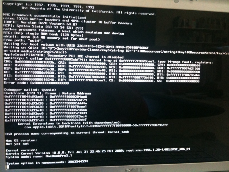

dnl tnx Posted October 23, 2009 Share Posted October 23, 2009 I tried to install SL to my Dell Inspiron 1720. I made an 8gb usb but when i boot from the usb no error message only the grey panic screen. If anyone installed SL successfully to a same or similar laptop, please help. My config: T7700 CPU, 160GB HDD, 3GB DDR2 RAM and GeForce 9600M GT VGA. Any small help would be good... Thanks. Link to comment https://www.insanelymac.com/forum/topic/119654-guide-leopard-on-an-xps-13301530/page/34/#findComment-1307556 Share on other sites More sharing options...

dnl tnx Posted October 23, 2009 Share Posted October 23, 2009 Boot with -V so you can give more info about hte panic screen. I'm guessing if you haven't made any install mods then its probably related to IOATA kext... a picture would be helpful. Thanks for the help. Here is my screenshot: Yes i need more info about the IOATA kext...I restored the SL to my usb and installed the EP45UD3P Snow Leopard install package. After the 9. step of Brett Whinnen's guide (http://www.insanelymac.com/forum/index.php?showtopic=119654&st=700&p=1253877entry1253877) i stopped. Thanks any helpful instructions... Link to comment https://www.insanelymac.com/forum/topic/119654-guide-leopard-on-an-xps-13301530/page/34/#findComment-1307586 Share on other sites More sharing options...

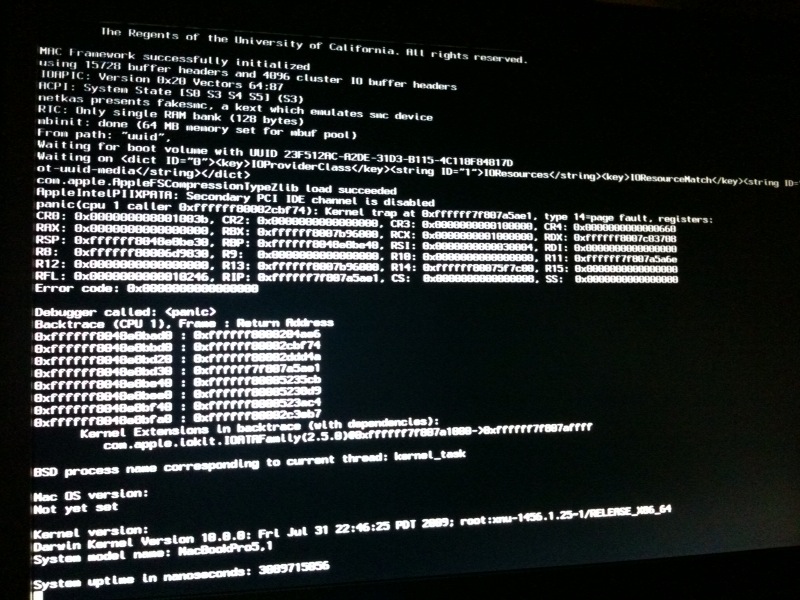

donkey Posted October 23, 2009 Share Posted October 23, 2009 Thanks for the help. Here is my screenshot: Yes i need more info about the IOATA kext...I restored the SL to my usb and installed the EP45UD3P Snow Leopard install package. After the 9. step of Brett Whinnen's guide (http://www.insanelymac.com/forum/index.php?showtopic=119654&st=700&p=1253877entry1253877) i stopped. Thanks any helpful instructions... Yea, it is IOATAFamily.kext related. Delete that kext from /S/L/E and proceed with the install. After you're done with the install, replace it with the one attached and you will have ur optical drive working again... you can place it in Extras/Extensions so it doesn't get deleted with future updates. Repair permissions with KextUtility and you're on ur way... IOATAFamily.kext_mod_by_the_edge_infinitemac.zip Link to comment https://www.insanelymac.com/forum/topic/119654-guide-leopard-on-an-xps-13301530/page/34/#findComment-1307604 Share on other sites More sharing options...
dnl tnx Posted October 23, 2009 Share Posted October 23, 2009 Yea, it is IOATAFamily.kext related. Delete that kext from /S/L/E and proceed with the install. After you're done with the install, replace it with the one attached and you will have ur optical drive working again... you can place it in Extras/Extensions so it doesn't get deleted with future updates. Repair permissions with KextUtility and you're on ur way... Thanks. Can you explain a little bit more how can i delete that kext file form /S/L/E? I downloaded the KextUtility but this part still really confusing for me. The /S/L/E is in the Snow Leopard image file or where is that folder? One more thing: I have Windows 7 and Ubuntu linux installed on my Dell Inspiron 1720 and i only have on hard drive with a few partition. Is it a problem? Thanks for all the help and sorry for my newbie questions... Link to comment https://www.insanelymac.com/forum/topic/119654-guide-leopard-on-an-xps-13301530/page/34/#findComment-1307606 Share on other sites More sharing options...
donkey Posted October 23, 2009 Share Posted October 23, 2009 Thanks. Can you explain a little bit more how can i delete that kext file form /S/L/E? I downloaded the KextUtility but this part still really confusing for me. The /S/L/E is in the Snow Leopard image file or where is that folder? One more thing: I have Windows 7 and Ubuntu linux installed on my Dell Inspiron 1720 and i only have on hard drive with a few partition. Is it a problem? Thanks for all the help and sorry for my newbie questions... you could use a existing Leopard install to delete the file. IOATAFamily.kext is located in /System/Library/Extensions. It is also in the Snow Leopard Image file, you have to show all hidden files and then delete it... I think it would be easiest to use a leopard install, stick in the usb go to System>Library>Extensions and delete the file you could try -v -s in boot prompt and then when IF you reach the single user prompt then use rm -rf /System/Library/Extensions/IOATAFamily.kext Link to comment https://www.insanelymac.com/forum/topic/119654-guide-leopard-on-an-xps-13301530/page/34/#findComment-1307612 Share on other sites More sharing options...
dnl tnx Posted October 23, 2009 Share Posted October 23, 2009 you could use a existing Leopard install to delete the file. IOATAFamily.kext is located in /System/Library/Extensions. It is also in the Snow Leopard Image file, you have to show all hidden files and then delete it... I think it would be easiest to use a leopard install, stick in the usb go to System>Library>Extensions and delete the file you could try -v -s in boot prompt and then when IF you reach the single user prompt then use rm -rf /System/Library/Extensions/IOATAFamily.kext I don't have existing leopard install and I didn't reach the single user prompt. So I will try the second option. What do you recommend if I want osx and win7 in one HDD? Format > Make two partition > Install osx first? Link to comment https://www.insanelymac.com/forum/topic/119654-guide-leopard-on-an-xps-13301530/page/34/#findComment-1307621 Share on other sites More sharing options...

donkey Posted October 26, 2009 Share Posted October 26, 2009 Thanks donkey, you were really helpful. But i'm still having difficulties. I removed de IOATA kext so now i could run the SL install (i bought a new HDD to my inspiron 1720, create 3 partition and install to the first one (case-sensitive journaled)). But after the install and the automatic restart when i boot from the HDD (the new partition) i get the grey mac screen again. I will upload a screenshot soon. And one more thing my laptop keyboard is not working. If i attach a usb keyboard, that is working. Is it normal? Thank you the help from anyone who can help me what is the next step. I hope i'm getting closer to my SL... BTW, some apps don't work correctly with case-sensitive journaled filesystem.... ex: Adobe Which DSDT and Voodoo PS2 file are you using? You have to use: VoodooPS2Controller.kext & AppleACPIPS2Nub.kext Link to comment https://www.insanelymac.com/forum/topic/119654-guide-leopard-on-an-xps-13301530/page/34/#findComment-1310661 Share on other sites More sharing options...
dnl tnx Posted October 26, 2009 Share Posted October 26, 2009 BTW, some apps don't work correctly with case-sensitive journaled filesystem.... ex: Adobe Which DSDT and Voodoo PS2 file are you using? You have to use: VoodooPS2Controller.kext & AppleACPIPS2Nub.kext After i removed the IOATAFamily.kext file from the install S/L/E the problem is still the same. Here is a screenshot: Which filesystem, what you recommand. I would like to install the Iphone Development SDK and maybe Adobe CS4. What does it mean i have to use: On the usb or after the install i have to add to that partition the DSDT file and the kext files? What i'm using? The AppleACIPS2Nub.kext is on my USB but the VoodooPS2Controller.kext is not (ApplePS2Controller.kext is on my USB stick). I'm using the Extra.zip content what i find in Brett Whinnen's guide (http://www.insanelymac.com/forum/index.php?showtopic=119654&st=700&p=1253877entry1253877). Thanks all the helps. Link to comment https://www.insanelymac.com/forum/topic/119654-guide-leopard-on-an-xps-13301530/page/34/#findComment-1310681 Share on other sites More sharing options...

donkey Posted October 26, 2009 Share Posted October 26, 2009 After i removed the IOATAFamily.kext file from the install S/L/E the problem is still the same. Here is a screenshot: Which filesystem, what you recommand. I would like to install the Iphone Development SDK and maybe Adobe CS4. What does it mean i have to use: On the usb or after the install i have to add to that partition the DSDT file and the kext files? What i'm using? The AppleACIPS2Nub.kext is on my USB but the VoodooPS2Controller.kext is not (ApplePS2Controller.kext is on my USB stick). I'm using the Extra.zip content what i find in Brett Whinnen's guide (http://www.insanelymac.com/forum/index.php?showtopic=119654&st=700&p=1253877entry1253877). Thanks all the helps. I can't recall Brett's install. I remember looking at it a while ago... but, to install SL, I hadto delete IOATAFamily.kext, this way you can install... AFTER installing I had to delete IOATAFamily.kext again, this time on the drive where you installed SL... I did this by using the terminal prompt from the USB installer.... keep ApplePS2Controller kext where it is... add VodooPS2Controller to /Extras along with AppleACPIPS2Nub Link to comment https://www.insanelymac.com/forum/topic/119654-guide-leopard-on-an-xps-13301530/page/34/#findComment-1311339 Share on other sites More sharing options...
dnl tnx Posted October 27, 2009 Share Posted October 27, 2009 I can't recall Brett's install. I remember looking at it a while ago... but, to install SL, I hadto delete IOATAFamily.kext, this way you can install... AFTER installing I had to delete IOATAFamily.kext again, this time on the drive where you installed SL... I did this by using the terminal prompt from the USB installer.... keep ApplePS2Controller kext where it is... add VodooPS2Controller to /Extras along with AppleACPIPS2Nub Thanks the help. My SL is working but not perfect. Thanks all the help, now i have a small smile on my face, but i didn't sleep too much last night... My Inspiron 1720 graphic card is working fine but i have problems the following important parts: keyboard (usb keyboard working only the laptop keyboard is not working), trackpad, wireless card, network card, shutdown-restart-sleep combo...and maybe some other small things... My config is: CPU: Intel Core 2 Duo T7700 2.4GHz; RAM: 3GB 667MHz; VGA: Nvidia Geforce 9600M GT 256MB; Bluetooth: Dell Wireless 355; Wireless: Intel PRO/Wireless 3945 Dual Band 802.11a/g. Thanks, thanks, thanks... Link to comment https://www.insanelymac.com/forum/topic/119654-guide-leopard-on-an-xps-13301530/page/34/#findComment-1311383 Share on other sites More sharing options...
