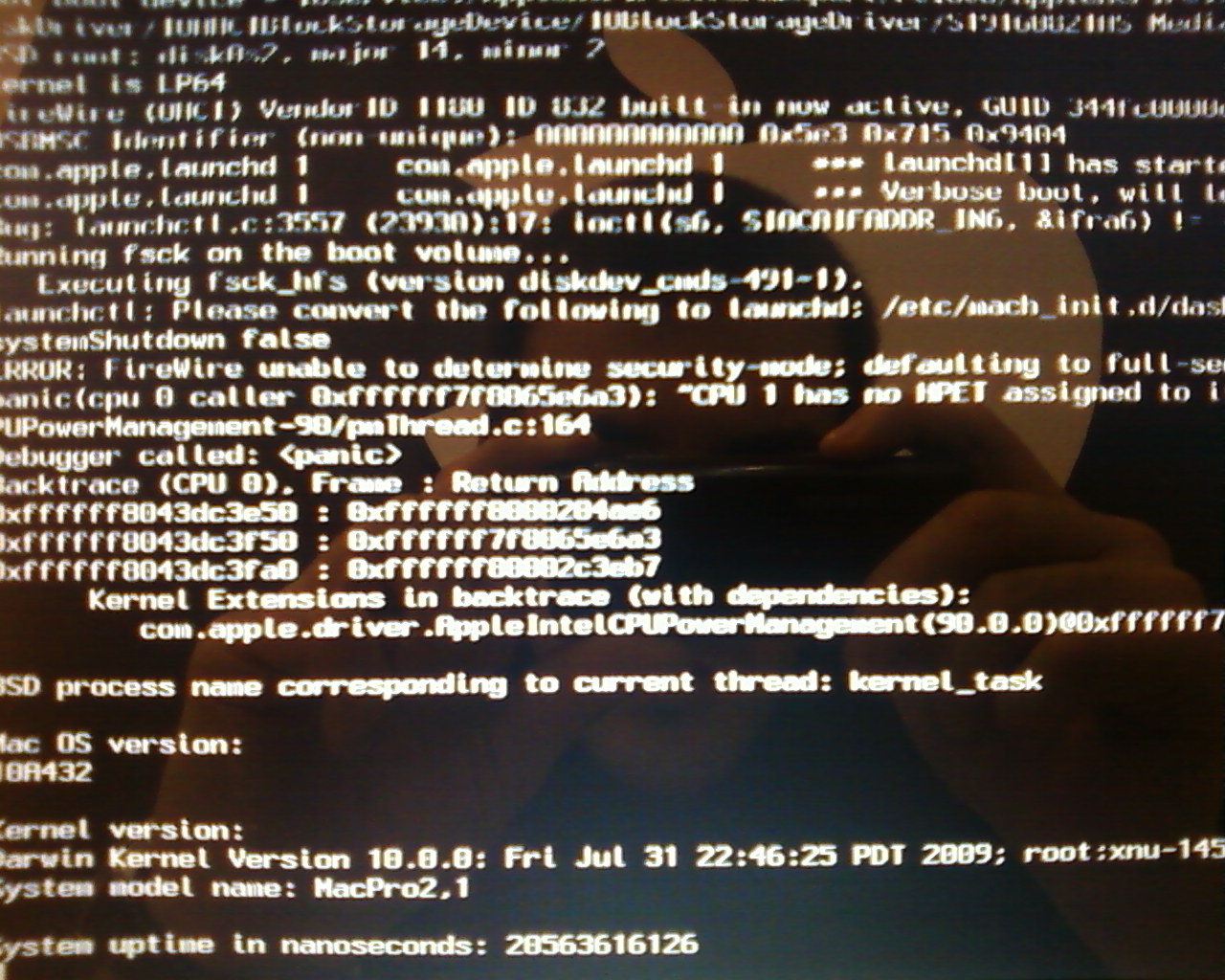

stimpy001 Posted September 11, 2009 Share Posted September 11, 2009 I'm trying to install SL to my M1330 (C2D 2.2GHz/8400GS). I booted from Suerhai's DellSnowCD for M1330, installed SL, then installed Chameleon RC3. After that copied Extension from bootcd to /System/Library/Extensions, then Repaired Disk Permissions with DiskUtility. The last thing I did is used DSDT patcher. After all this, I get kernel panic, screenshot attached. Please advise! Thank you! Link to comment https://www.insanelymac.com/forum/topic/119654-guide-leopard-on-an-xps-13301530/page/30/#findComment-1261488 Share on other sites More sharing options...
overshoot Posted September 11, 2009 Share Posted September 11, 2009 I'm trying to install SL to my M1330 (C2D 2.2GHz/8400GS). I booted from Suerhai's DellSnowCD for M1330, installed SL, then installed Chameleon RC3. After that copied Extension from bootcd to /System/Library/Preferences, then Repaired Disk Permissions with DiskUtility. The last thing I did is used DSDT patcher.After all this, I get kernel panic, screenshot attached. Please advise! Thank you! Hello, Check your dsdt (permissions, wrong directory) as it stuck on AppleIntelCPU... or try another dsdt which has speedstep support for M1330. Just had Superhai for that Tip : Put your added extensions in /Extra/Extensions and not in /System/Library/Extensions as Chameleon is able to load them from there. You will then be able to know which extensions you added and which are vanilla. Don't forget to do a kextcache with : kextcache -v 1 -t -m /Extra/Extensions.mkext /Extra/Extensions Last, if you don't successed in this, verify that you have the NullCPUPower kext. Good luck. Link to comment https://www.insanelymac.com/forum/topic/119654-guide-leopard-on-an-xps-13301530/page/30/#findComment-1261606 Share on other sites More sharing options...
stimpy001 Posted September 11, 2009 Share Posted September 11, 2009 Hello, Check your dsdt (permissions, wrong directory) as it stuck on AppleIntelCPU... or try another dsdt which has speedstep support for M1330. Just had Superhai for that Tip : Put your added extensions in /Extra/Extensions and not in /System/Library/Extensions as Chameleon is able to load them from there. You will then be able to know which extensions you added and which are vanilla. Don't forget to do a kextcache with : kextcache -v 1 -t -m /Extra/Extensions.mkext /Extra/Extensions Last, if you don't successed in this, verify that you have the NullCPUPower kext. Good luck. DSDT.aml file is in the root directory of Macintosh HD. Where should I copy it? Link to comment https://www.insanelymac.com/forum/topic/119654-guide-leopard-on-an-xps-13301530/page/30/#findComment-1261621 Share on other sites More sharing options...
overshoot Posted September 11, 2009 Share Posted September 11, 2009 DSDT.aml file is in the root directory of Macintosh HD. Where should I copy it? Then if it is in the root directory, your dsdt does not support speedstep. Check you have NullCPUPower kext in /Extra/Extensions or /System/Library/Extensions If yes, check permissions on it and re-do a kextcache. Link to comment https://www.insanelymac.com/forum/topic/119654-guide-leopard-on-an-xps-13301530/page/30/#findComment-1261638 Share on other sites More sharing options...
