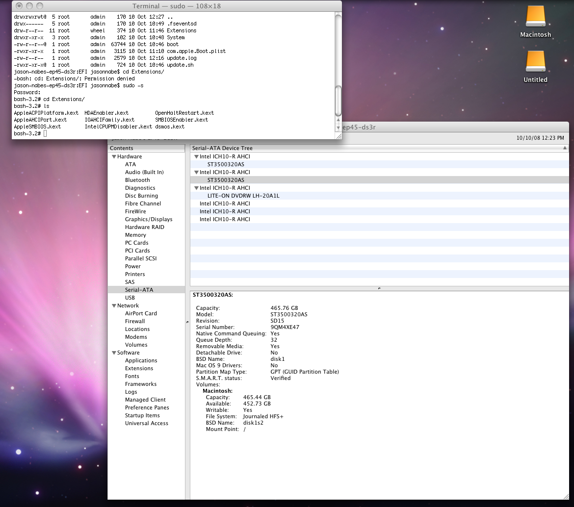

jnabe71 Posted October 10, 2008 Share Posted October 10, 2008 I had everything working in 10.5.4 but after the update to 10.5.5 my hard-drives became orange (external). Everything in my system uses SATA so I grabbed the two .kext files in the v2 zip that was posted and added them (using hidden EFI Partition method) with all my other kext (except for the AppleHDA.kext that goes in the /System/Library/Extensions folder). In System Profiler I can see them being recognized but for some reason they are showing up as orange. In 10.5.4 they were correct using your first fix. Any ideas? Attaching an image to show what I mean. Thanks in advance. Link to comment https://www.insanelymac.com/forum/topic/108479-solution-unknown-ahci-orange-disk-icons-in-1052-to-1056-for-intel-and-jmicron/page/2/#findComment-925246 Share on other sites More sharing options...
Gujal Posted October 14, 2008 Author Share Posted October 14, 2008 I had everything working in 10.5.4 but after the update to 10.5.5 my hard-drives became orange (external). Everything in my system uses SATA so I grabbed the two .kext files in the v2 zip that was posted and added them (using hidden EFI Partition method) with all my other kext (except for the AppleHDA.kext that goes in the /System/Library/Extensions folder). In System Profiler I can see them being recognized but for some reason they are showing up as orange. In 10.5.4 they were correct using your first fix. Any ideas? Attaching an image to show what I mean. Thanks in advance. Can you try backing up IOAHCIFamily.kext from your /System/Library/Extensions folder and install the one modified by me into /System/Library/Extensions folder, for testing. May be 10.5.5 expects the kext there. And there are no changes to IOAHCIFamily.kext between my earlier version and v2. I have only modified AppleAHCIPort.kext in the new version to support ICH10 and ICH10R Link to comment https://www.insanelymac.com/forum/topic/108479-solution-unknown-ahci-orange-disk-icons-in-1052-to-1056-for-intel-and-jmicron/page/2/#findComment-929313 Share on other sites More sharing options...
