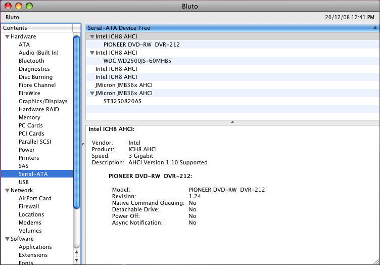

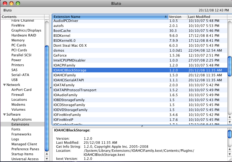

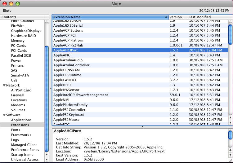

madhias Posted December 20, 2008 Share Posted December 20, 2008 Worked for me again on 10.5.6 - good work! Btw, i had a strange issue of getting silver disks with 10.5.5 without patched AppleAHCIPort or IOAHCIFamily: Installed 10.5.0 with Boot DFE-132, then crossupdated to 10.5.5 > had orange disks. Then i made a disk image with Carbon Copy Cloner, went over to my other Mac Install and installed this Retail image with Disk Utility Repair option onto an other disk, reinstalled Bootloader, rebooted and had silver disks with recognized Sata controller! Strange. What`s happening here? Link to comment https://www.insanelymac.com/forum/topic/108479-solution-unknown-ahci-orange-disk-icons-in-1052-to-1056-for-intel-and-jmicron/page/4/#findComment-1006996 Share on other sites More sharing options...

Gujal Posted December 21, 2008 Author Share Posted December 21, 2008 Worked for me again on 10.5.6 - good work! Btw, i had a strange issue of getting silver disks with 10.5.5 without patched AppleAHCIPort or IOAHCIFamily: Installed 10.5.0 with Boot DFE-132, then crossupdated to 10.5.5 > had orange disks. Then i made a disk image with Carbon Copy Cloner, went over to my other Mac Install and installed this Retail image with Disk Utility Repair option onto an other disk, reinstalled Bootloader, rebooted and had silver disks with recognized Sata controller! Strange. What`s happening here? Are you sure the SATA controller is in AHCI? It would be recognised as SATA Controller and Silver disks if it is in IDE mode. The orange icon and unknown AHCI controller issue is only when SATA is set to AHCI mode. Posted AppleAHCIport.kext 10.5.6 will crash the system because of Jmicron IDswhen this is used with other Vanilla IOATA etc I removed Jmicron id now this works fine try the one I attached should work fine Can you let me know which kext is clashing. I am running Retail install and dont have panic. I would presume this JMicron definition would clash with AppleVIAATA.kext (which is not part of Retail install) and nothing else. Thanks for your input Link to comment https://www.insanelymac.com/forum/topic/108479-solution-unknown-ahci-orange-disk-icons-in-1052-to-1056-for-intel-and-jmicron/page/4/#findComment-1007779 Share on other sites More sharing options...
