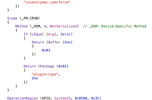

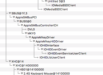

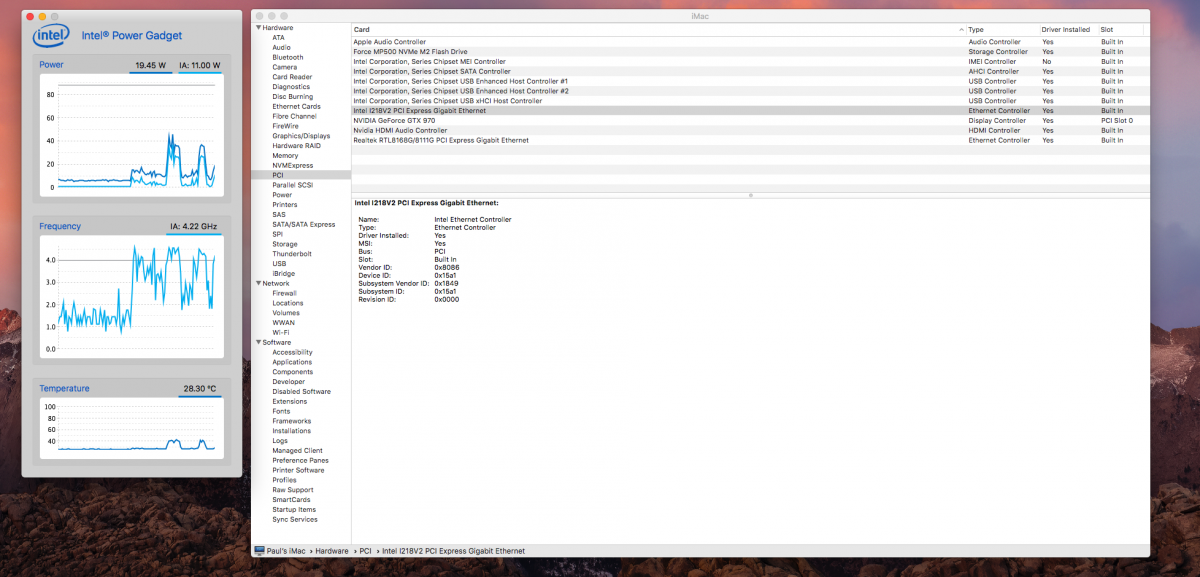

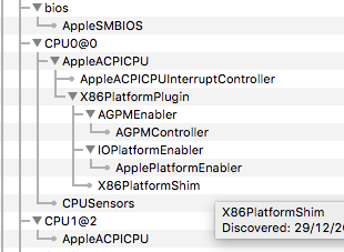

tikizondo94 Posted December 29, 2017 Share Posted December 29, 2017 dont need ssdt dont need plug in type send me new ioreg with new files So far everything is working like a dream! Amazing work! And so fast.. Idk how you do it lol. How did you get power management to work without clover ssdt/generate/plugintype? oh yeah.. Heres my new logs.. Paul’s iMac.ioreg.zip bootlog.log.txt.zip Send me Paul’s iMac.zip 1 Link to comment Share on other sites More sharing options...
MaLd0n Posted December 30, 2017 Author Share Posted December 30, 2017 So far everything is working like a dream! Amazing work! And so fast.. Idk how you do it lol. How did you get power management to work without clover ssdt/generate/plugintype? oh yeah.. Heres my new logs.. -LPC load -Plugin Type -Lmu -Ec -Full Sbus and many many others, like one real iMac, essentials and cosmetics patches Check cosmetics in AboutThisMac/Pci 1 Link to comment Share on other sites More sharing options...

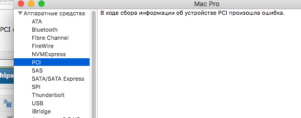

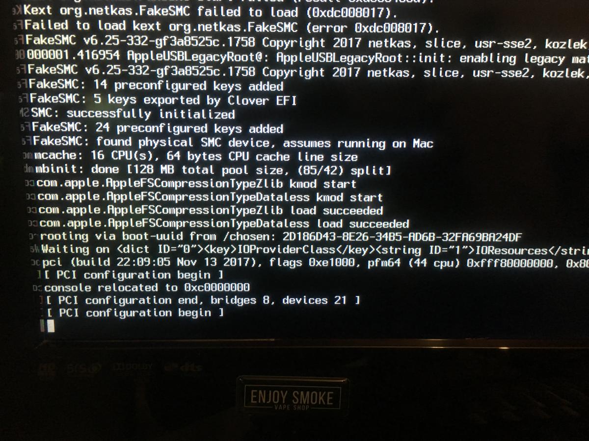

zipp0tm Posted January 2, 2018 Share Posted January 2, 2018 Happy New Year! Sorry for bad english (translate with google translator) I'm from Ukraine I ask for help. A computer was assembled for work. But it does not work stably. In the Cinema 4 and Oktan. Reboots arbitrarily without errors. Now it's 10.12.6, but it will need to be updated to 10.13.2. my configuration motherboard rampage 5 (modified bios 3701) processor 5960x memory 64gb dd4 3000 two video cards GTX1080 ti Hope only for you MaLd0n CLOVER 2.zip Send me Lekh.zip 1 Link to comment Share on other sites More sharing options...
MaLd0n Posted January 2, 2018 Author Share Posted January 2, 2018 Happy New Year! Sorry for bad english (translate with google translator) I'm from Ukraine I ask for help. A computer was assembled for work. But it does not work stably. In the Cinema 4 and Oktan. Reboots arbitrarily without errors. Now it's 10.12.6, but it will need to be updated to 10.13.2. my configuration motherboard rampage 5 (modified bios 3701) processor 5960x memory 64gb dd4 3000 two video cards GTX1080 ti Hope only for you MaLd0n extract original DSDT with F4 key in Clover Boot Screen, send me one ioreg too, check first post 1 Link to comment Share on other sites More sharing options...
zipp0tm Posted January 2, 2018 Share Posted January 2, 2018 extract original DSDT with F4 key in Clover Boot Screen, send me one ioreg too, check first post Thank you IORegistry.zip DSDT.aml.zip 1 Link to comment Share on other sites More sharing options...
MaLd0n Posted January 2, 2018 Author Share Posted January 2, 2018 Thank you for High Sierra CLOVER.zip check Processor patches for High Sierra, u can check here, Kernel and Kext Patches/KernelToPatch config.plist.zip 1 Link to comment Share on other sites More sharing options...

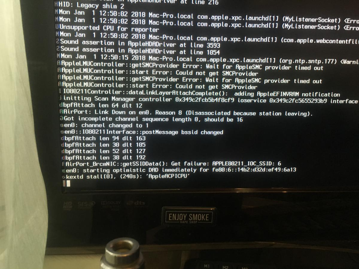

zipp0tm Posted January 2, 2018 Share Posted January 2, 2018 for High Sierra CLOVER.zip check Processor patches for High Sierra, u can check here, Kernel and Kext Patches/KernelToPatch config.plist.zip Clover 4063 loaded sysctl machdep.xcpm.mode = 0 Upgrade to 10.13.2 stops kextd stall [0], AppleACPICPU Clover 4359 . there is no update, and there is no download. stops . [ PCI configuration begin ] 1 Link to comment Share on other sites More sharing options...
