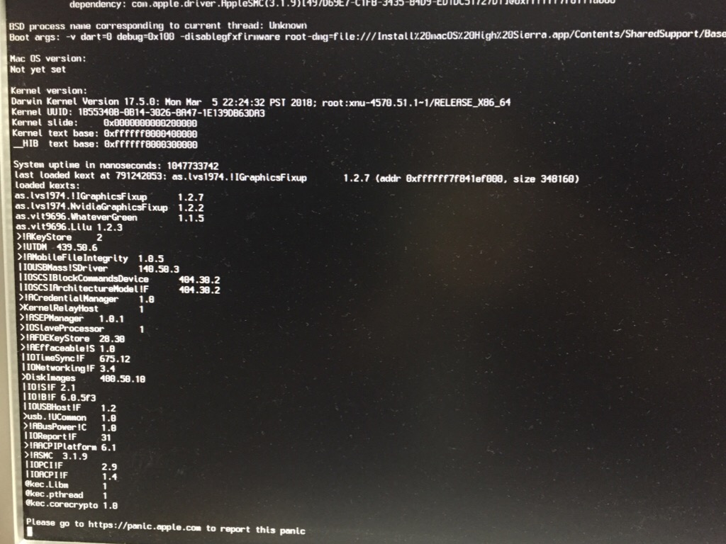

On 2018/4/15 at 12:07 AM, MaLd0n said:
put one DGPU and disable IGPU
There is no way to disable iGPU(HD610) in BIOS settings.
So I replaced RADEON HD5450 by GeForce GT710 Kepler (10.13.4 Genuine driver), but could not boot from USB installer....
Geforce9400 can boot and QE/CI is enabled, but it does not support UEFI, so the display-output is enable only after the driver has been loaded.
