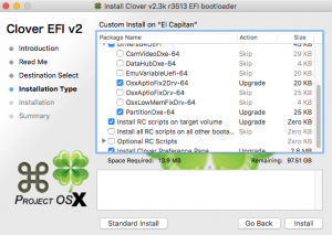

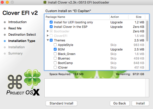

Intel Skylake NUC6i5SYH on El Capitan 10.11.6
Clover v2.3k r3526 UEFI
  • Install for UEFI booting only
  • Install Clover in the ESP
  • BGM Theme
  • Install OsxAptioFix2Drv-64, PartitionDxe-64 in Driver64UEFI
  • Install RC scripts on target volume
  • Install Clover Preference Pane
