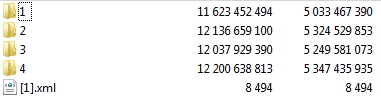

Use 7-zip to extract and you'll find a folder called "1" next to the xml file. Check attachment.
Hi modbin,
Thanks for that, it seems the issue is I was extracting in OSX not W7.
I replaced the the entire EFI folder with the one from '1' and I also replaced the bootmgr.efi that is in the main folder of the wininstall drive at separate times and tried to boot with no luck.
I'm guessing I'm doing something pretty dumb thats preventing this from working.
Thanks,
Matt

Sounds like you still don't use bootmgfw.efi to boot. But instead the old cdboot.efi. Navigate to efi\microsoft\boot\ on your usb stick and delete cdboot.efi. Then copy bootmgfw.efi from the install.wim there and rename it to cdboot.efi.

Sounds like you still don't use bootmgfw.efi to boot. But instead the old cdboot.efi. Navigate to efi\microsoft\boot\ on your usb stick and delete cdboot.efi. Then copy bootmgfw.efi from the install.wim there and rename it to cdboot.efi. Or just burn a DVD :P
Worked perfect, thanks for your help!
Now I'm of course getting problems with windows telling me it won't install because my partition isn't GPT (it is).
It's rather funny thy the most challenge part of building this computer is getting windows to run. Osx has been running perfect since the first attempt.
Cool that it finally worked for you! You get the error message from Windows Setup because DiskUtility creates a hybrid MBR on GPT disks. MS Windows fails to handle this (on install). But it's a simple fix. Download gptfdisk aka gdisk and write a new protective MBR.
