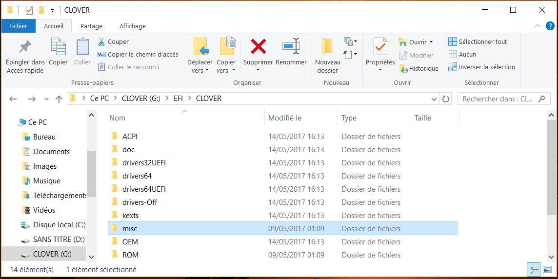

You enabled Boot/Debug and there was no debug.log? Or you just assume?
No, there was nothing, I will follow your advice to get better information.
thank you
@apianti,
no files debug.log
thanks
"Debug
<key>Debug</key><false/>
Formerly known as "Log" before revision 3064
If you are unable to boot into the Clover you can use this setting to produces a debug output to /EFI/CLOVER/misc/debug.log. This log then can be assessed to find out what the problem is. !WARNING turning on this log will dramatically increase loading time as it has to write the log to the disk as it goes. So please be patient and give plenty of time before reseting your computer."

You need to set Boot/Debug=true.......... And make sure that the directory EFI/CLOVER/misc exists and is writable (i.e. FAT)

@papiercul,
I didn't see that the EFIAPI was removed from those functions, still not sure why removed though, it should still be EFIAPI with VA_LIST - that's a change from CryptoPkg. Copied those options from CryptoPkg. As for the ==, that was probably Andy, I meant to remove all the extra non-sense but forgot. I don't think any of that is needed, as it's not in CryptoPkg.
the files misc is empty with debug=true
thanks
Are you booting from a FAT volume or an HFS+ volume? You need to boot from a FAT volume, so you might have to create a USB. If the file is not created that seems to point to that it's not loading, could be that it's crashing trying to determine the TSC but that seems unlikely. You may have to enter the shell and load the driver to dump efi calls and then enter the gui.
Yes, FAT but 32
attached small video
