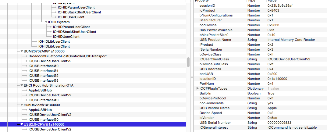

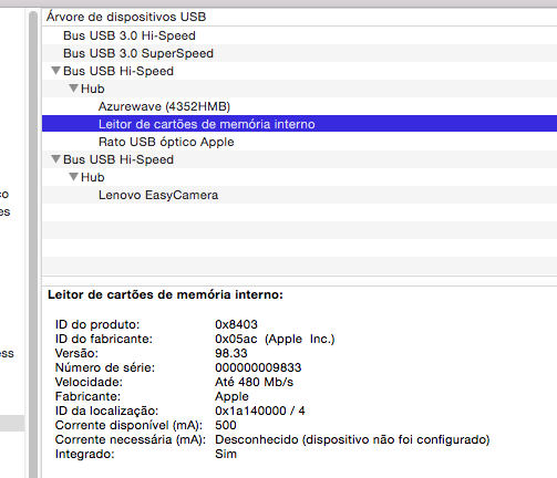

artur_pt Posted February 6, 2015 Share Posted February 6, 2015 hello Andy good day i have this sd card reader Product ID: 0x0129 Vendor ID: 0x0bda (Realtek Semiconductor Corp.)Speed: Up to 480 Mb/secManufacturer: GenericLocation ID: 0x1a140000 / 4Current Available (mA): 500Current Required (mA): Unknown (Device has not been configured) i try to use ur kext and now i have this i attach the kext can u see if it have anything wrong AnyCardReader.kext.zip so many ppl have problems with this new sd card readers thanks 1 Link to comment Share on other sites More sharing options...
Allan Posted February 6, 2015 Share Posted February 6, 2015 I have the same problem Exactly like the Artur. Link to comment Share on other sites More sharing options...
Andy Vandijck Posted February 6, 2015 Author Share Posted February 6, 2015 hello Andy good day i have this sd card reader Product ID: 0x0129 Vendor ID: 0x0bda (Realtek Semiconductor Corp.) Speed: Up to 480 Mb/sec Manufacturer: Generic Location ID: 0x1a140000 / 4 Current Available (mA): 500 Current Required (mA): Unknown (Device has not been configured) i try to use ur kext and now i have this null null i attach the kext can u see if it have anything wrong AnyCardReader.kext.zip so many ppl have problems with this new sd card readers thanks Driver override works. Doesn't it attach any cards? Link to comment Share on other sites More sharing options...
