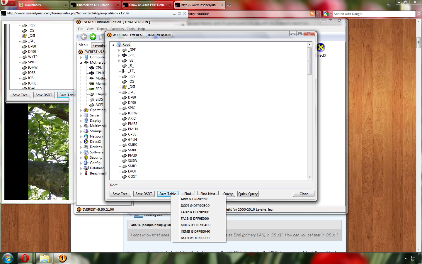

You can try dumping your SSDT tables and have Chameleon load them.
Set DropSSDT=y in /extra/com.apple.Boot.plist and place the SSDT tables in /Extra, follow the instructions and naming conventions outlined in the first post.
You can use Lavalys Everest to dump all your ACPI tables under Windows - see screenshots here:
http://www.insanelymac.com/forum/index.php...p;#entry1468558

How far did you get? Did you install Everest?
I just don't know how to dump SSDT. I'm a quick learner I just need to see it one time and I'll get it.
:) I guess you don't like to click on links. You better get over it because the Internets are full of them.

You're the one saying you need to see things. The screenshots were there the whole time and yet you didn't see them. I can't open your eyes for you.
i did the extraction of the ACPI tables with the everest and i place them in the extra folder
You only need the SSDT tables. And maybe you don't need them at all. Make sure they are named like mojo says in the very first post.
