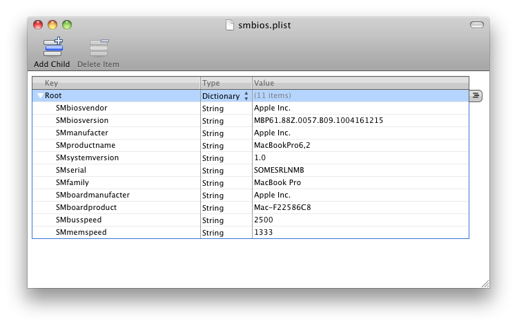

anibalin Posted August 26, 2010 Share Posted August 26, 2010 Correct me please. With a core i7 processor, shouldnt the bootloader (without smbios) detect a box as a macbookpro6,2 instead of a imac11,1? http://www.everymac.com/systems/by_process...re-i7-macs.html Link to comment https://www.insanelymac.com/forum/topic/225766-chameleon-rc5-mode-with-mem-detection-enabled-and-automatic-p-states-c-states-generation-for-native-power-managment/page/24/#findComment-1537565 Share on other sites More sharing options...
kellis Posted August 26, 2010 Share Posted August 26, 2010 that is also what i thought. but then, 6.2 i think is for laptop 6.2, which mine is, but still reported as 11,1 not sure.. Correct me please. With a core i7 processor, shouldnt the bootloader (without smbios) detect a box as a macbookpro6,2 instead of a imac11,1? http://www.everymac.com/systems/by_process...re-i7-macs.html Link to comment https://www.insanelymac.com/forum/topic/225766-chameleon-rc5-mode-with-mem-detection-enabled-and-automatic-p-states-c-states-generation-for-native-power-managment/page/24/#findComment-1537649 Share on other sites More sharing options...

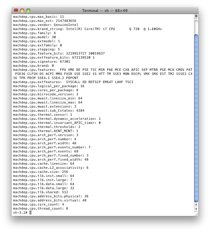

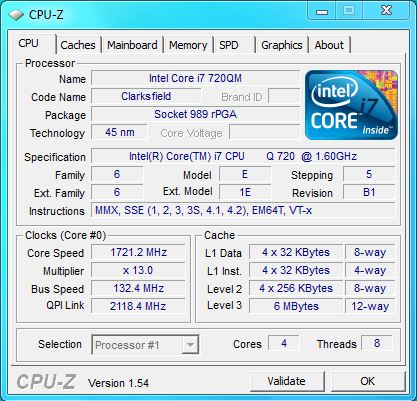

Jingu Posted August 26, 2010 Share Posted August 26, 2010 I'm having the same issue. Chameleon bootloader (without smbios) is detecting my Core i7 laptop as iMac11,1 Core i7 instead of MacbookPro6,1 or MacbookPro6,2 Core i7. Looks like the developers have not included yet the subroutine to recognize Core i7/i5 notebooks. Cpu-type shows up as 0x0701 in ioreg. Link to comment https://www.insanelymac.com/forum/topic/225766-chameleon-rc5-mode-with-mem-detection-enabled-and-automatic-p-states-c-states-generation-for-native-power-managment/page/24/#findComment-1537754 Share on other sites More sharing options...
