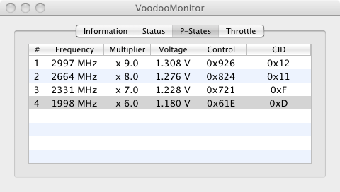

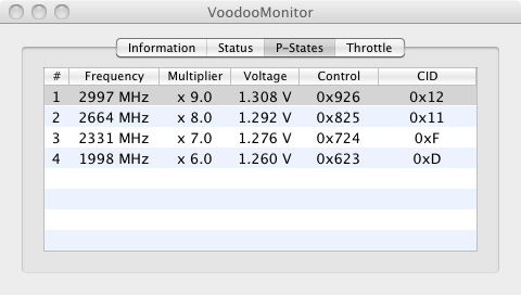

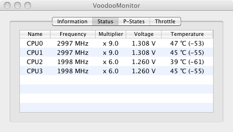

Hey Master Chief, thanks for the great explanation.

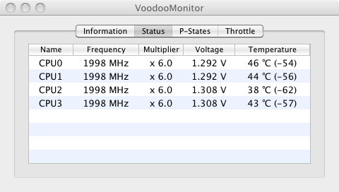

I followed your steps and got very close results (4 values under PerformanceStateArray after adding _PSS for my CPU and Step2_0), except that after adding _CST from MacPro3,1 temperatures are still high (> 60º C idle). The main difference here is that my SSDT doesn't have PDC0 so I gave a shot in the dark and used 0x80000000.
Using NullCPUPowerManagement.kext and C1E enabled in BIOS I have decent temperatures (40-43º C idle) and CPU-i shows changes in frequency/multiplier/voltage, but only for cores 1 and 2, and between 2 states (my CPU has 4).
In Leopard SpeedStep works for all cores using Superhai's VoodooPowerMini.kext, waiting for 64 bit version.

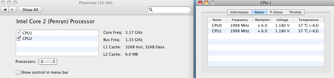

Well I had some interesting findings this morning...
I've stripped all the SSDT related information out of my DSDT (also removed the DropSSDT=Y from com.apple.Boot.plist) as I wanted to start over again from the beginning...
Well lo and behold I have full speedstep enabled. CoolBook Controller lists the same states, the IORegistryExplorer reports the same 6 power states. I do get the "ACPI_SMC_PlatformPlugin::registerLPCDriver - WARNING - LPC device initialization failed: C-state power management not initialized" error still but I'll start on that again later...
Under ACPITables I can see my DSDT loaded as well as a separate SSDT.
I'm confused! The only difference between this DSDT and the old one that was used for us M1530 laptop owners is the HPET is actually closer to that of a real Mac and thus the AppleIntelCPUPowerManagement now loads fine.
This is my _PR scope now...

Well, the P-States provided by the system are wrong, as I explained in a PM. Not only is there not a proper entry for IDA, but it doesn't allow one to use the 600MHz P-State either.
Was that to me? If so I don't have a PM from you outlining any issues with the system _PSS values, just one asking about getting _PSS values working ;)
Even searching Intel's site I didn't see a 600MHz pstate for the T9300, the lowest I saw was 800MHz...
But anyways any further info you have found is always good :)
ASUS uses TYPE instead of PDC0 and I think that was why FormelyKnownAs asked you to read the thread ;)

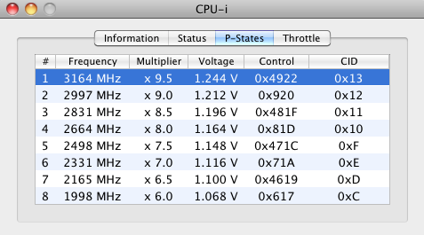

Well, it turned out the first reboot after IRQ modification happened to be the rare case where there is no KP. Following reboots result in KP just like before. Sadly it does not solve my KP problem.
I'm here to confirm that this works for me, no more KP.
Thanks THe King a lot for the tip.
My PSS contains 4 states, now the question is why the cpu frequency only changed between the highest and lowest although cpu-i shows 7 states here:
Posted Image
<snip />
Yeah, that can be misleading: CPU-i shows calculated values, not the values you've added. This data however can be pretty helpful in combination with the P-State Calculator.
Also, I'm afraid that I had bad news for you. You may have fixed the KP, but you apparently still only have two functional P-States. More work to be done so to speak.
you can add all the pstates (and just the _PSS) to your dsdt and will get perfect switching between them. i had only three in my ssdt, but added 6 more to my dsdt and it is working alright
