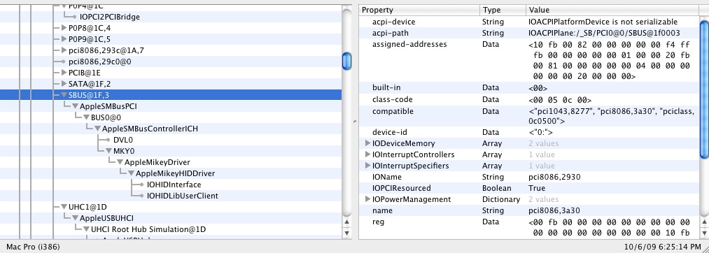

I added code for SBUS (from a MacPro1,1) to my DSDT. It shows in the ioreg, but none of those kexts are shown with kextstat. In my case only com.apple.driver.AppleIntelMeromProfile is loaded from the above mentioned kexts
That's because it doesn't match. Let's first have a look at AppleSMBusPCI.kext
			<key>IONameMatch</key>
		<array>
			<string>pci10de,aa2</string>
			<string>pci8086,3a30</string>
		</array>
No match with our board so we have to fix it by either adding the device id of our SMBUS controller to this kext (pci8086,2930 for P5K PRO) or by changing the device id in our dsdt.dsl Which is what I did.
Note: For people who don't know how to get this ID – you can use lspci -nn (Google/Search for it).
After this change AppleSMBusPCI.kext will load and initialize properly, daisy chaining AppleSMBusController.kext by setting some properties. And by loading this kext, and setting more properties, the other two kexts will also load.

Right! I used the code from your dsdt v2.2 at the P5K Pro thread
The kexts you said are loaded now. Also got three 'sound assertion' errors but soud seems to work fine. I'll be testing it out
