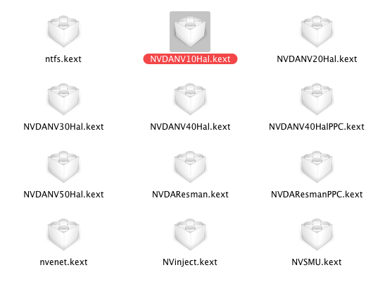

Guilevv Posted May 15, 2009 Share Posted May 15, 2009 I'm Using 10.5.6 What kexts do I have to Install on Nvidia 9000 series? (All of them?) What kexts do I have to delete (in the image) to install Nvdarwin? Link to comment Share on other sites More sharing options...

507brewery Posted May 22, 2009 Share Posted May 22, 2009 Thanks for the instructions. I tried using these to get my PNY 9400GT 512MB working. I can't seem to get past a kernel panic when I have NVDAResman.kext loaded. My PNY 9400GT 512MB has NVCAP: 04000000000003000c0000000000000700000000 Device ID: 0641 Vendor ID: 10de I'm using 10.5.6 right now, vanilla kernel. I modified the kexts you supplied to reflect my NVCAP and device ID. I loaded these into the extensions folder with OSx86 tools and updated the EFI strings similarly. Same problem - kernel panic! No matter what I do, NVDAResman.kext crashes the computer. It seems to occur when I would expect the computer to switch from the grey screen to the blue login screen. I do not see details when booting with -V or checking out the kernel panic logs. There's no indication of what might be happening. If I use nvinject.kext or nvdarwin.kext properly modified, I can see the device details change to reflect 512MB, but I still can't load NVDAResman.kext. I always get a kernel panic. Any ideas? Link to comment Share on other sites More sharing options...
idefix09152006 Posted May 23, 2009 Share Posted May 23, 2009 i don´t really know what i have done, but the pn from jjduro has helped me a little bit. i installed the core vivis driver, but nothiong. change the resolution: blue screen, no 3d, no quartz. then i read, that the 9500gt the renamed 8800gt. efi-studio started an a little bit play (i was really bored to this time...) found the 8800gt with 1024mb. i think... ok, what to loose. if it not goes: reinstall leo. then change the resolution... arghhh... blue screen... next day i start and wonder: the icons are little bit snall. what now ??? profiler says: resolution 1280x1024x32bit, 3d on, quartz too. yeah.... Link to comment Share on other sites More sharing options...
507brewery Posted May 25, 2009 Share Posted May 25, 2009 OK Fellas, thanks to Hagar|Away on #osx86, All that's necessary is to use STOCK kexts from 10.5.6 Then just load NVinject, properly updated with the NVCAP and Device ID for the PNY GeForce 9400 GT 512MB 100% working. Edited NVinject.kext posted here for your convenience: NVinject.kext.zip Link to comment Share on other sites More sharing options...

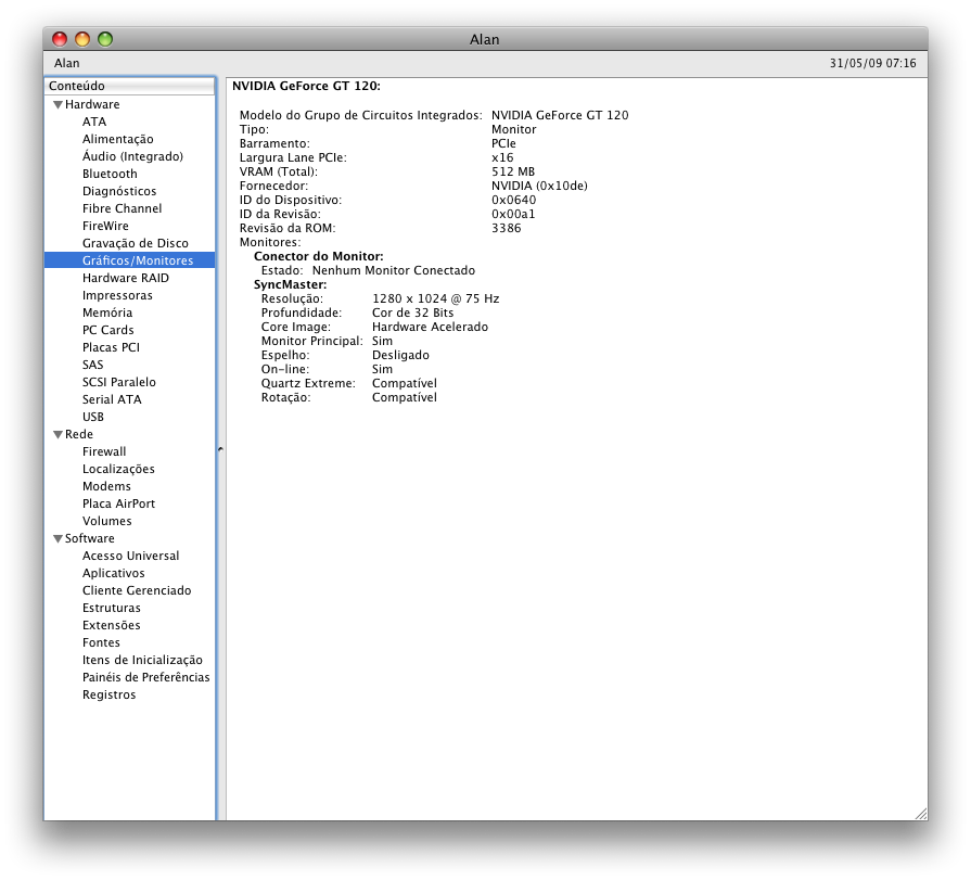

alanlcarlos Posted May 28, 2009 Share Posted May 28, 2009 With Qe/CI the random screen freeze. Mouse can be put into motion, after some time the screen comes back. In the Windows it functions normally with games as COD4, Crysis and gpu temp show 45%C. Some solution for freeze? Sorry my bad english Link to comment Share on other sites More sharing options...
