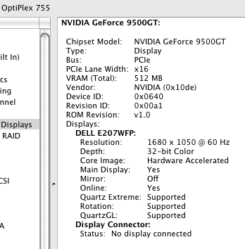

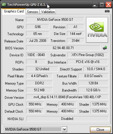

I will attach GPUz output here for my card, as well as what System Profiler sees under Graphics/Displays.

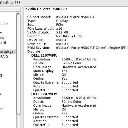

OMFG you are awesome! What you said about putting in my string didn't really work (actually could not use DVI port at all, all black or garbled and wrong resolution usually). What DID work was going to OSx86 Tools Utility - http://######.com/osx86tools/
Then click "Add EFI Strings/Boot Flag".
Then click GFX Strings along the top.
Choose Graphics Card drop down (Custom GeForce for me) - named "nVidia GeForce 9500 GT"
Choose 512MB
Then the screen where it says "Please choose your display output configuration (NVCAP)", I had to choose VGA / DVI-I. I tried all of them, but that one was the one that worked. I would have thought the Custom selection where you put in 0400000000000100060000000000000700000000 which was pulled straight from the bios via nibitor on a PC would have worked. On my xfx 9500 gt 512mb, which is a low profile, the VGA is on a ribbon cable, and the DVI is on the board. NVdarwin kext (info.plist) now shows 04000000 00000100 0E000000 00000007 00000000 which I tried before from krazubu's post. IOPCIMatch is exactly the same too. Weird.
So if this helps someone else get dual monitors working after getting QE/CI working on their 9500 GT, that will be great. Thanks everyone!
Now to figure out why the nic Intel 82566DM on the Optiplex 755 doesn't work in VMWARE. I think it's not even recognized as gigabit. I think the problem is, the driver that is available for it, is the 82566MM, which is for notebooks, and the DM is for desktops, which differ in power saving/speed reduction modes.
Attached is shot of system profile with two monitors connected (and it works with or without DVI-VGA adapter)
