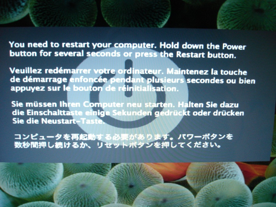

sonotone Posted November 16, 2008 Author Share Posted November 16, 2008 Give a screenshot of your kernel panic please. So, i've just testes PC_EFI V9 right now and Deep sleep is working well on my inspiron 9400. (also GUID osx/xp dual boot with /extra support) here the new one: http://netkas.org/ Link to comment https://www.insanelymac.com/forum/topic/97966-dell-laptops-post-installer-xps-inspiron-vostro-lattitude/page/24/#findComment-968109 Share on other sites More sharing options...

moregain Posted November 16, 2008 Share Posted November 16, 2008 Give a screenshot of your kernel panic please. Here it is... /edit/ lol... here's the info: Last login: Sun Nov 16 22:28:35 on console juans-mac-pro:~ juan$ sudo dmesg Password: de by ToH:xnu-1228/BUILD/obj/RELEASE_I386 standard timeslicing quantum is 10000 us vm_page_bootstrap: 897260 free pages and 151316 wired pages mig_table_max_displ = 79 HTT: 2 cores per package; 2 logical cpus per package Extension "com.apple.driver.AppleACPIPlatform" has immediate dependencies on both com.apple.kernel and com.apple.kpi components; use only one style. AppleACPICPU: ProcessorApicId=0 LocalApicId=0 Enabled AppleACPICPU: ProcessorApicId=1 LocalApicId=1 Enabled Loading security extension com.apple.nke.applicationfirewall Loading security extension com.apple.security.seatbelt calling mpo_policy_init for mb Seatbelt MACF policy initialized Security policy loaded: Seatbelt Policy (mb) Loading security extension com.apple.security.TMSafetyNet calling mpo_policy_init for TMSafetyNet Security policy loaded: Safety net for Time Machine (TMSafetyNet) Copyright © 1982, 1986, 1989, 1991, 1993 The Regents of the University of California. All rights reserved. MAC Framework successfully initialized using 16384 buffer headers and 4096 cluster IO buffer headers IOAPIC: Version 0x20 Vectors 64:87 ACPI: System State [s0 S3 S4 S5] (S3) Extension "com.apple.driver.AppleACPIPlatform" has immediate dependencies on both com.apple.kernel and com.apple.kpi components; use only one style. mbinit: done Security auditing service present BSM auditing present From path: "uuid", Waiting for boot volume with UUID 08C97BAE-C6E7-372B-A7DD-EE0FEB8C7F2A Waiting on IOProviderClassIOResourcesIOResourceMatchboot-uuid-media Extension "com.apple.driver.AppleACPIPlatform" has immediate dependencies on both com.apple.kernel and com.apple.kpi components; use only one style. BTCoexistence feature not supported! wl0: Broadcom BCM432b 802.11 Wireless Controller 5.10.38.9 FireWire (OHCI) VendorID 1180 ID 832 built-in now active, GUID 484fc00015c06dc1; max speed s400. USBF: 0.673 Attempting to get EHCI Controller from BIOS USBF: 0.673 USBLEGCTLSTS value c0040000 USBF: 0.673 Found USBLEGSUP_ID - value 0x1 - writing OSOwned USBF: 0.673 acquireOSOwnership done - value 0x1000001 Extension "com.apple.driver.AppleACPIPlatform" has immediate dependencies on both com.apple.kernel and com.apple.kpi components; use only one style. USBF: 0.677 Attempting to get EHCI Controller from BIOS USBF: 0.677 USBLEGCTLSTS value c0000000 USBF: 0.677 Found USBLEGSUP_ID - value 0x1 - writing OSOwned USBF: 0.677 acquireOSOwnership done - value 0x1000001 Starting AppleACPIPS2Nub Found mouse PNP device AppleACPIPS2Nub startup complete ERROR: FireWire unable to determine security-mode; defaulting to full-secure. Got boot device = IOService:/AppleACPIPlatformExpert/PCI0@0/AppleACPIPCI/IDE1@1F,2/AppleAHCI/PRI@0/IOAHCIDevice@0/AppleAHCIDiskDriver/IOAHCIBlockStorageDevice/IOBlockStorageDriver/WDC WD2500BEVS-75UST0 Media/IOFDiskPartitionScheme/Untitled 4@4 BSD root: disk0s4, major 14, minor 3 jnl: unknown-dev: replay_journal: from: 1169408 to: 4679680 (joffset 0x1b0000) jnl: unknown-dev: journal replay done. HFS: Removed 1 orphaned unlinked files or directories Jettisoning kernel linker. BCM5751Enet: Ethernet address 00:21:70:86:54:7c AirPort_Brcm43xx: Ethernet address 00:22:69:7c:ac:31 Resetting IOCatalogue. VID: family specific matching fails Matching service count = 0 VID: family specific matching fails VID: family specific matching fails ACPI_SMC_CtrlLoop::initCPUCtrlLoop - pmCPUControl (PMIOCSETPSTATETABLE) returned 0xffffffff HDAEnabler: Copyright © 2008 by Kabyl HDAEnabler: 05/05/2008 Added SPAudio support:Taruga HDAEnabler: Copyright © 2008 by Kabyl HDAEnabler: 05/05/2008 Added SPAudio support:Taruga dsmos: Initializing... dsmos: Hook and decryption contexts set! dsmos: Starting... AirPort: Link Down on en0 AppleBCM5751Ethernet: a 0 interruptOccurred - Not my interrupt MAC AUTH succeeded AirPort: Link Up on en0 ApplePS2Mouse: Unexpected data from PS/2 controller. ApplePS2Mouse: Unexpected data from PS/2 controller. ApplePS2Mouse: Unexpected data from PS/2 controller. juans-mac-pro:~ juan$ Link to comment https://www.insanelymac.com/forum/topic/97966-dell-laptops-post-installer-xps-inspiron-vostro-lattitude/page/24/#findComment-968332 Share on other sites More sharing options...

sonotone Posted November 17, 2008 Author Share Posted November 17, 2008 Here it is... Your ApplePS2Controller seem's to give you some errors. So, try to replace with this one: http://forum.insanelymac.com/index.php?act...st&id=24495 If you have installed EHCISleepEnabler, try to remove it. I don't think 5 will work, that mode uses secure virtual memory. Netkas said that is not supported yet. 0 = suspend to ram (sleep) 1 = suspend to disk (deep sleep/hibernate) 3 = suspend to ram and disk (safe sleep) 5, 7 = same as 1 and 3 with secure vm but 5 is the default mode of deepsleep app, and it works for me. (i've patched my dsdt, so maybe it's connected...) edit 3: btw. how can I confirm that the new boot is actually working? all I see when it loads for a split second is sth about efi bootloader by ToH. that doesn't sound right to me..... the chameleon version should be 1.012 in bootloader infos. Link to comment https://www.insanelymac.com/forum/topic/97966-dell-laptops-post-installer-xps-inspiron-vostro-lattitude/page/24/#findComment-968710 Share on other sites More sharing options...
moregain Posted November 17, 2008 Share Posted November 17, 2008 Your ApplePS2Controller seem's to give you some errors. So, try to replace with this one: http://forum.insanelymac.com/index.php?act...st&id=24495 If you have installed EHCISleepEnabler, try to remove it. With ApplePS2Controller replaced, those errors at boot are gone, but it's the same with kernel panic. A few seconds after booting, the system freezes. I didn't find EHCISleepEnabler so I think it's not installed, I've checked for it at system/library/extensions Here's the verbose boot after installing the new ApplePS2Controller: Last login: Mon Nov 17 12:12:28 on console juans-mac-pro:~ juan$ sudo dmesg Password: red pages mig_table_max_displ = 79 HTT: 2 cores per package; 2 logical cpus per package Skipping duplicate extension "com.apple.driver.ApplePS2Keyboard" with older/same version (1.1.0 -> 1.1.0). Extension "com.apple.driver.AppleACPIPlatform" has immediate dependencies on both com.apple.kernel and com.apple.kpi components; use only one style. AppleACPICPU: ProcessorApicId=0 LocalApicId=0 Enabled AppleACPICPU: ProcessorApicId=1 LocalApicId=1 Enabled Loading security extension com.apple.nke.applicationfirewall Loading security extension com.apple.security.seatbelt calling mpo_policy_init for mb Seatbelt MACF policy initialized Security policy loaded: Seatbelt Policy (mb) Loading security extension com.apple.security.TMSafetyNet calling mpo_policy_init for TMSafetyNet Security policy loaded: Safety net for Time Machine (TMSafetyNet) Copyright © 1982, 1986, 1989, 1991, 1993 The Regents of the University of California. All rights reserved. MAC Framework successfully initialized using 16384 buffer headers and 4096 cluster IO buffer headers IOAPIC: Version 0x20 Vectors 64:87 ACPI: System State [s0 S3 S4 S5] (S3) Extension "com.apple.driver.AppleACPIPlatform" has immediate dependencies on both com.apple.kernel and com.apple.kpi components; use only one style. USBF: 0.483 Attempting to get EHCI Controller from BIOS USBF: 0.483 USBLEGCTLSTS value c0040000 USBF: 0.483 Found USBLEGSUP_ID - value 0x1 - writing OSOwned USBF: 0.483 acquireOSOwnership done - value 0x1000001 Extension "com.apple.driver.AppleACPIPlatform" has immediate dependencies on both com.apple.kernel and com.apple.kpi components; use only one style. mbinit: done Security auditing service present BSM auditing present USBF: 0.531 Attempting to get EHCI Controller from BIOS USBF: 0.531 USBLEGCTLSTS value c0000000 USBF: 0.531 Found USBLEGSUP_ID - value 0x1 - writing OSOwned USBF: 0.531 acquireOSOwnership done - value 0x1000001 From path: "uuid", Waiting for boot volume with UUID 08C97BAE-C6E7-372B-A7DD-EE0FEB8C7F2A Waiting on IOProviderClassIOResourcesIOResourceMatchboot-uuid-media Extension "com.apple.driver.AppleACPIPlatform" has immediate dependencies on both com.apple.kernel and com.apple.kpi components; use only one style. Starting AppleACPIPS2Nub Found mouse PNP device AppleACPIPS2Nub startup complete BTCoexistence feature not supported! wl0: Broadcom BCM432b 802.11 Wireless Controller 5.10.38.9 FireWire (OHCI) VendorID 1180 ID 832 built-in now active, GUID 484fc00015c06dc1; max speed s400. ERROR: FireWire unable to determine security-mode; defaulting to full-secure. Got boot device = IOService:/AppleACPIPlatformExpert/PCI0@0/AppleACPIPCI/IDE1@1F,2/AppleAHCI/PRI@0/IOAHCIDevice@0/AppleAHCIDiskDriver/IOAHCIBlockStorageDevice/IOBlockStorageDriver/WDC WD2500BEVS-75UST0 Media/IOFDiskPartitionScheme/Untitled 4@4 BSD root: disk0s4, major 14, minor 3 jnl: unknown-dev: replay_journal: from: 3104256 to: 1134592 (joffset 0x1b0000) jnl: unknown-dev: journal replay done. HFS: Removed 1 orphaned unlinked files or directories Jettisoning kernel linker. BCM5751Enet: Ethernet address 00:21:70:86:54:7c AirPort_Brcm43xx: Ethernet address 00:22:69:7c:ac:31 Resetting IOCatalogue. VID: family specific matching fails Matching service count = 0 VID: family specific matching fails HDAEnabler: Copyright © 2008 by Kabyl HDAEnabler: 05/05/2008 Added SPAudio support:Taruga HDAEnabler: Copyright © 2008 by Kabyl HDAEnabler: 05/05/2008 Added SPAudio support:Taruga ACPI_SMC_CtrlLoop::initCPUCtrlLoop - pmCPUControl (PMIOCSETPSTATETABLE) returned 0xffffffff HDAEnabler: Copyright © 2008 by Kabyl HDAEnabler: 05/05/2008 Added SPAudio support:Taruga HDAEnabler: Copyright © 2008 by Kabyl HDAEnabler: 05/05/2008 Added SPAudio support:Taruga VID: family specific matching fails dsmos: Initializing... dsmos: Hook and decryption contexts set! dsmos: Starting... AirPort: Link Down on en0 AppleBCM5751Ethernet: a 0 interruptOccurred - Not my interrupt MAC AUTH succeeded AirPort: Link Up on en0 juans-mac-pro:~ juan$ Link to comment https://www.insanelymac.com/forum/topic/97966-dell-laptops-post-installer-xps-inspiron-vostro-lattitude/page/24/#findComment-968872 Share on other sites More sharing options...

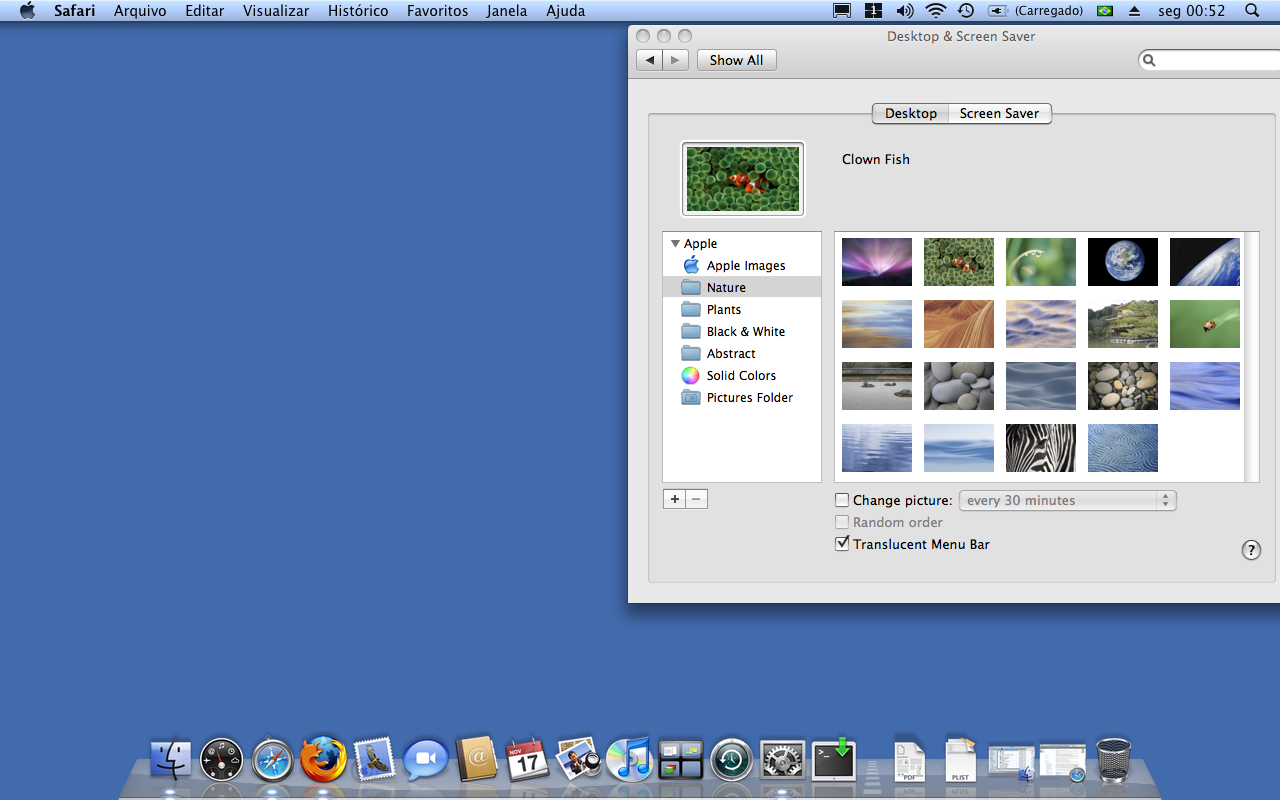

walteram Posted November 18, 2008 Share Posted November 18, 2008 very good. works perfectly in my Dell Inspiron 1252 (GMA X3100). But, after i install i can't change my desktop picture.. only works if i change my resolution to 1024 and returns to 1280. And when i reboot the screen is blue, without the picture. Please see the image below. What wrong am i doing? : Link to comment https://www.insanelymac.com/forum/topic/97966-dell-laptops-post-installer-xps-inspiron-vostro-lattitude/page/24/#findComment-969662 Share on other sites More sharing options...
TheGreatDeceiver Posted November 18, 2008 Share Posted November 18, 2008 very good. works perfectly in my Dell Inspiron 1252 (GMA X3100).But, after i install i can't change my desktop picture.. only works if i change my resolution to 1024 and returns to 1280. And when i reboot the screen is blue, without the picture. Please see the image below. What wrong am i doing? I think I've replied just recently to sb else here with almost identical problem. This happened to me when I had autologin enabled or didn't use a password to login. when this happened to me a quick logoff/login fixed the problem. it went away after I got rid of autologin. apparently some script that doesn't run properly when autologin is enabled. Link to comment https://www.insanelymac.com/forum/topic/97966-dell-laptops-post-installer-xps-inspiron-vostro-lattitude/page/24/#findComment-969692 Share on other sites More sharing options...

walteram Posted November 18, 2008 Share Posted November 18, 2008 I think I've replied just recently to sb else here with almost identical problem. This happened to me when I had autologin enabled or didn't use a password to login. when this happened to me a quick logoff/login fixed the problem. it went away after I got rid of autologin. apparently some script that doesn't run properly when autologin is enabled. yes! is this. i disable the autologin and works. thanks the great deceiver Link to comment https://www.insanelymac.com/forum/topic/97966-dell-laptops-post-installer-xps-inspiron-vostro-lattitude/page/24/#findComment-970469 Share on other sites More sharing options...
