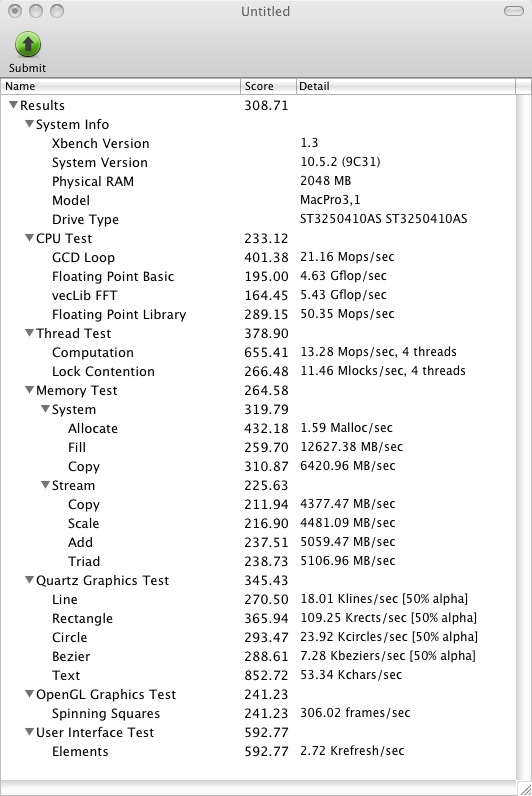

MacUser2525 Posted February 26, 2008 Share Posted February 26, 2008 Edit:Sorry it might just be you are CPU limited? My 7900GS KO pretty much gets close to beating your card I get 304 Quartz, 268 OpenGL and 537 User interface. When I put in my new 8800gt today I got similar to what you have which is not the performamce increase you would expect ie almost none at all in my situation. This is just not in Xbench either as the followup poster notes in the OpenGL Extension Viewer Test it is actually even worse 7900GS KO gets ~1800s for lowest score of the tests 8800GT gets ~1300s on all of them so that is roughly a third drop in performance not impressive at all. Link to comment https://www.insanelymac.com/forum/topic/89001-gfx-efi-string-for-nvidia-geforce-8800gt-512mb-g92/page/2/#findComment-643770 Share on other sites More sharing options...

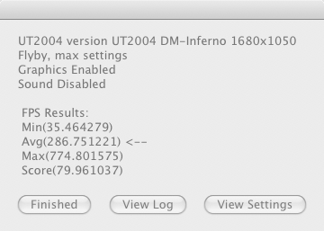

PPZ Posted February 26, 2008 Share Posted February 26, 2008 OMG, noone is LISTENING to what I am saying.I said about three times that I get WORSE performanse from 8800GT than from X1800GTO!!! I don't care about Xbench, I say what I see generally.I sticked to one game, but the rest too is not playing very well.Sims 2 should work flawlessly now, but they are choppy worst than before! CoD 2 too! Colin mcRae Rally is so-so, but it was BLASTING with old card... I could say that plenty of games and apps are not any faster, even worst than before.THAT is my problem, not the Xbench results.... After all, anyone could make better results.I just OC-ed my E6600 to 3GHz, raised PCI Express fsb to 110, and got result of Xbench over 250! But again those games I just said, and I am taking for reference, are playing the same.This will say that bottleneck is not the processor, it's something else that it is braking the system.But I don't know what.... Link to comment https://www.insanelymac.com/forum/topic/89001-gfx-efi-string-for-nvidia-geforce-8800gt-512mb-g92/page/2/#findComment-643807 Share on other sites More sharing options...

PPZ Posted February 26, 2008 Share Posted February 26, 2008 Yes, CoD 2 IS BUGGY, but it was working fine with ATI card.Colin mcRae Rally is working ok, but again I can see that it has no framerate as it had with old card.WoW I am not playing, so I can't say anything.Do we know for some good benchmark for Mac ? I still have old card, I will just make an experiment.I will install on external HDD Leopard with ATI drivers, and pop-in my old card to see the difference.Then we can speak. Don't get me wrong.I had X1800GTO, then I gave 200 euro for new card, which is suppose to be at least 200% faster than the old one, and finally I dont see any improvement.It's killing me.... Thank you, that was indeed the problem! Interesting! My card was recognized automatically.I did no corrections to VRAM size... Link to comment https://www.insanelymac.com/forum/topic/89001-gfx-efi-string-for-nvidia-geforce-8800gt-512mb-g92/page/2/#findComment-644110 Share on other sites More sharing options...

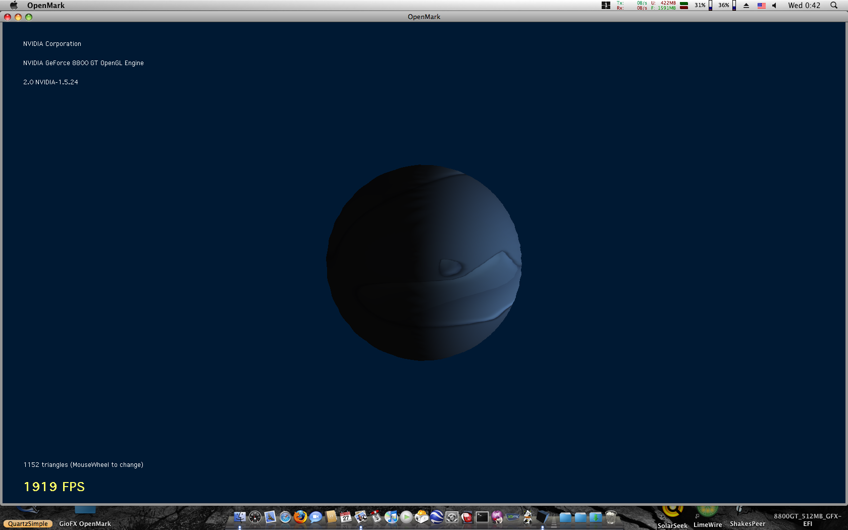

agrafuese Posted February 26, 2008 Author Share Posted February 26, 2008 cyclonefr, PPZ, & LTL: Can you guys give OpenMark a try and post your scores? It's by no means a complete or contemporary test of your system, but it will at least give all of us some idea of what you guys are experiencing. If cyclonefr's 8800GT performance is really all that much better than PPZ's & LTL's, then we should see some kind of difference between the two. It's really important to do things like this instead of just simply saying, "my graphics are great!" or "my graphics are not great!"...those are subjective statements that hold no means of comparison. What seems like good performance to one person could be totally {censored}e performance for another. HINT: PLEASE run OpenMark after a fresh reboot and no other programs running! Link to comment https://www.insanelymac.com/forum/topic/89001-gfx-efi-string-for-nvidia-geforce-8800gt-512mb-g92/page/2/#findComment-644448 Share on other sites More sharing options...
dnjmarlboro Posted February 26, 2008 Share Posted February 26, 2008 Just for comparison: -> orderd a 8800gt and will post Results with new one as soon as possible. - E6600 - 4GB Ram - MSI 7900 GTO Openmark 1.6 NVIDIA GeForce 7900 GT/GTO OpenGL Engine 1920x1200x32 Score 23557 1152 triangels = 1002 FPS Xbench 1.3 Results 211.43 System Info Xbench Version 1.3 System Version 10.5.2 (9C31) Physical RAM 4096 MB Model Mac Pro Drive Type WDC WD5000AAKS-00TMA0 WDC WD5000AAKS-00TMA0 CPU Test 202.69 GCD Loop 377.96 19.92 Mops/sec Floating Point Basic 182.81 4.34 Gflop/sec vecLib FFT 150.30 4.96 Gflop/sec Floating Point Library 201.40 35.07 Mops/sec Thread Test 302.36 Computation 291.96 5.91 Mops/sec, 4 threads Lock Contention 313.54 13.49 Mlocks/sec, 4 threads Memory Test 243.84 System 289.30 Allocate 382.07 1.40 Malloc/sec Fill 241.01 11718.31 MB/sec Copy 277.54 5732.43 MB/sec Stream 210.73 Copy 195.42 4036.38 MB/sec Scale 204.34 4221.61 MB/sec Add 224.30 4778.02 MB/sec Triad 221.61 4740.78 MB/sec Quartz Graphics Test 306.77 Line 235.81 15.70 Klines/sec [50% alpha] Rectangle 329.50 98.37 Krects/sec [50% alpha] Circle 266.67 21.74 Kcircles/sec [50% alpha] Bezier 254.88 6.43 Kbeziers/sec [50% alpha] Text 740.78 46.34 Kchars/sec OpenGL Graphics Test 267.11 Spinning Squares 267.11 338.84 frames/sec User Interface Test 522.11 Elements 522.11 2.40 Krefresh/sec Disk Test 84.41 Sequential 135.10 Uncached Write 135.83 83.40 MB/sec [4K blocks] Uncached Write 129.54 73.29 MB/sec [256K blocks] Uncached Read 121.67 35.61 MB/sec [4K blocks] Uncached Read 158.53 79.68 MB/sec [256K blocks] Random 61.38 Uncached Write 23.38 2.47 MB/sec [4K blocks] Uncached Write 203.63 65.19 MB/sec [256K blocks] Uncached Read 90.61 0.64 MB/sec [4K blocks] Uncached Read 155.24 28.81 MB/sec [256K blocks] Link to comment https://www.insanelymac.com/forum/topic/89001-gfx-efi-string-for-nvidia-geforce-8800gt-512mb-g92/page/2/#findComment-644595 Share on other sites More sharing options...
PPZ Posted February 26, 2008 Share Posted February 26, 2008 Ok, here it is.Full screen, with default number of triangles (1152).But this benchmark is not very reliable.It's changing speed as you open some window or do anything (eg move mouse).... But however, here it is... Link to comment https://www.insanelymac.com/forum/topic/89001-gfx-efi-string-for-nvidia-geforce-8800gt-512mb-g92/page/2/#findComment-644832 Share on other sites More sharing options...

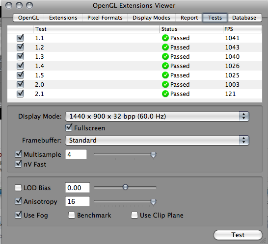

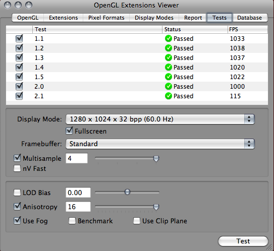

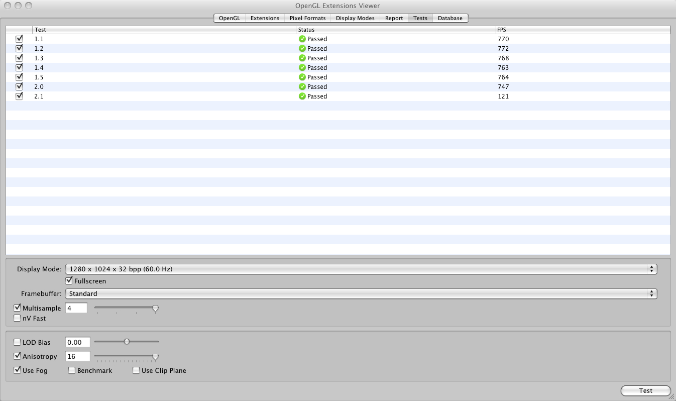

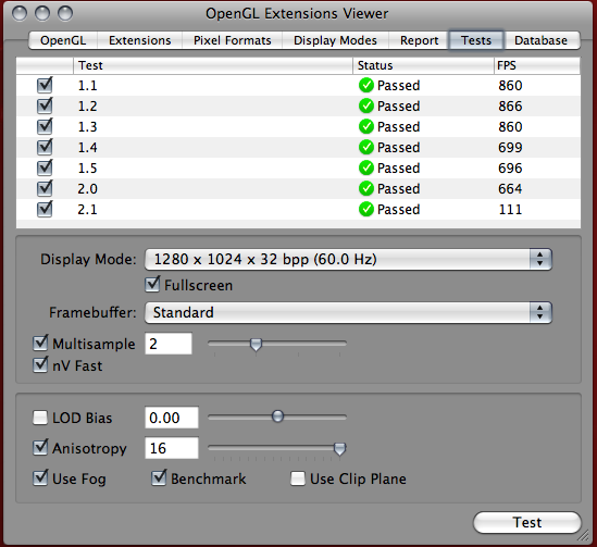

Headrush69 Posted February 27, 2008 Share Posted February 27, 2008 Select test, use these settings so everyone tests the same 1280X1024X32 (60Hz) Display Mode Tick multisample set to 4 Untick LOD, set slider to 0 Anistropy set to 16 Tick Use Fog What does the benchmark checkbox do? (Since you still need to click the test button) consolation, on your second 2 pics you used multisample 2, not 4 like you suggested. Maybe a better OpenGL benchmarking tool would be using SantaDuck which works with both UT2004 Retail and Demo and gives an average FPS which is easier to translate into end user experience. Here's an example from my system: Link to comment https://www.insanelymac.com/forum/topic/89001-gfx-efi-string-for-nvidia-geforce-8800gt-512mb-g92/page/2/#findComment-644952 Share on other sites More sharing options...
consolation Posted February 27, 2008 Share Posted February 27, 2008 What does the benchmark checkbox do? (Since you still need to click the test button) consolation, on your second 2 pics you used multisample 2, not 4 like you suggested. It seems to generate more items at set settings - so the results are more meaningful. IRC it was added in one of the revisions and that's why it wasn't used as it would make it difficult to compare benchies. But, it does seem like a more meaningful test... Fixed the pic, nVFast makes marginal difference now, bugger... BTW, when running 2.1 spec, do your cube textures look like noise? I think it used to show a mandlebrot (sp?) fractal in previous versions. Link to comment https://www.insanelymac.com/forum/topic/89001-gfx-efi-string-for-nvidia-geforce-8800gt-512mb-g92/page/2/#findComment-644986 Share on other sites More sharing options...
