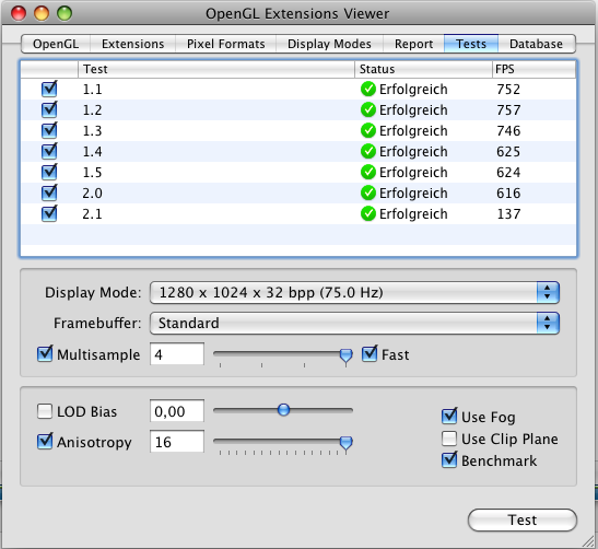

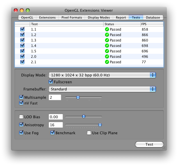

agrafuese Posted February 27, 2008 Author Share Posted February 27, 2008 Thanks for the news on this consolation. Let's hope this catches on. I want to see Mr. cyclonefr's scores most of all, since he apparently has the best running 8800GT system here I've attached my scores with benchmark checked. One is with multisample @ 4 and one is with it @ 2. The strange thing is, my 2.1 scores are higher with it set to 4. Shouldn't it be the other way around? Fixed the pic, nVFast makes marginal difference now, bugger...BTW, when running 2.1 spec, do your cube textures look like noise? I think it used to show a mandlebrot (sp?) fractal in previous versions. Yeah NVfast only gave me a difference of +/- 2 points haha. And yes, the 2.1 test is a little funky looking. Not sure if they meant to do that or not. It's just a bunch of moving lines. Looks like a bad TV reception or something Another thing I'd like all of us to include if possible is a link to their card, or if they are OCing their card, provide the new clock speeds, etc. For example, I don't OC my card and here is the newegg link to it: http://www.newegg.com/Product/Product.aspx...N82E16814130318 Link to comment https://www.insanelymac.com/forum/topic/89001-gfx-efi-string-for-nvidia-geforce-8800gt-512mb-g92/page/3/#findComment-645019 Share on other sites More sharing options...

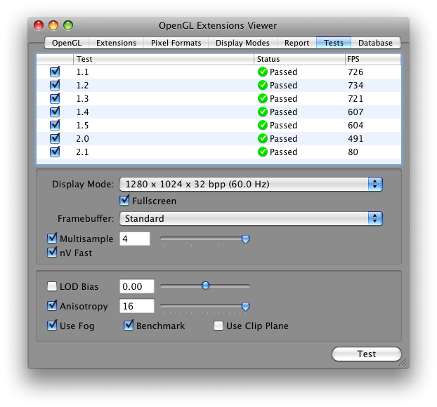

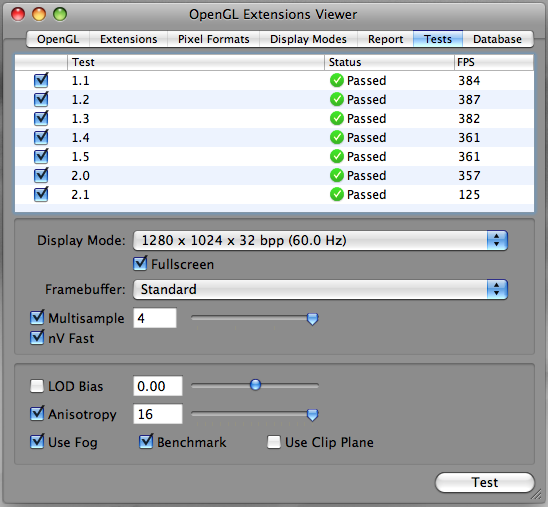

PPZ Posted February 27, 2008 Share Posted February 27, 2008 So, I made two tests.Someone said maybe the CPU is bottleneck, so I oc-ed to 3GHz and made tests.Then I returned to default speed (2.4GHz) and made test again.Seems there's no significant difference... OK, so here they are.First picture is with overclocked system, and second default speed... Link to comment https://www.insanelymac.com/forum/topic/89001-gfx-efi-string-for-nvidia-geforce-8800gt-512mb-g92/page/3/#findComment-645640 Share on other sites More sharing options...

cyclonefr Posted February 27, 2008 Share Posted February 27, 2008 @PPZ, I have about the same results as you with FSAA 4x, etc except OpenGL 2.1 where I have 153 and you have 80 or so, but i'm sure it's just a bug from this benchmark. Yes, IMO this benchmarks is {censored} because X1900 gets something around 3200 fps in "normal test" without touching anything and we get smthg like 2200 fps. You'd tell me : then X1900 is faster and more optimized... It isn't, I asked someone to try Age of Empires 3 with 8800 GT and X1900 and even with the naked eye, he could see the difference. I (yes I) tried WoW with X1900XT and 8800 GT and 8800 GT is a lot faster. BTW, let me give you a link where some site did some benchmarks to compare cards : http://www.barefeats.com/harper8.html Yep, it seems G92 drivers suck for Pro apps (wtf ?) but they rock for games... Weird. I couldn't try OpenMark since every dl/ link is down, so I can't find it (but as someone said, this benchs seems {censored} and old). So yeah, you are gonna tell me : every bench is {censored} for you.... Well I use 3D Mark 03 using Crossover, I get 10909 points in Game tests with default settings whereas X1900XT gets something around 6000, and HD3870 around 9000 points. Seems pretty logical to me, and a good bench to prove it's more powerful. I won't post my WoW screens all over again, but I can tell you I get about the SAME FPS I have in Windows (in D3D !), and sometimes even more : I just need to disable FSAA cause FSAA + bloom = real slow on OSX 10.5.2 (but that's true on every card, it should be fixed in a future leopard opengl update...). So if I listen you guys telling me 8800 GT is slow as hell, then I guess as I have the same FPS in WoW windows, 8800 GT drivers for Windows are {censored}... And yeah I guess you guys get sometimes 350 fps with 7300GT.... Link to comment https://www.insanelymac.com/forum/topic/89001-gfx-efi-string-for-nvidia-geforce-8800gt-512mb-g92/page/3/#findComment-645746 Share on other sites More sharing options...

PPZ Posted February 27, 2008 Share Posted February 27, 2008 @PPZ, I have about the same results as you with FSAA 4x, etc except OpenGL 2.1 where I have 153 and you have 80 or so, but i'm sure it's just a bug from this benchmark. MY OC'ed have 153, and non-overclocked 129 :censored2: However, the card is more slow than the old one and I can see it.I can see it on playing games.I guess that I will just wait to get some better drivers from Apple.Since they let go 8800GT for Mac Pro, they will probably work now on drivers in the future... Link to comment https://www.insanelymac.com/forum/topic/89001-gfx-efi-string-for-nvidia-geforce-8800gt-512mb-g92/page/3/#findComment-646142 Share on other sites More sharing options...
cyclonefr Posted February 27, 2008 Share Posted February 27, 2008 PPZ, in your latest bench you forgot to check NVFast so i'm not sure you realy get 153 or 129 :censored2: @dnjmarlboro : 391x9, everything off in CPU features except NX of course, DRAM Read Static Control = Disabled, the two Spread Spectrum things = Disabled, PCIe freq = 107MHz (else it gets recognized as x1 and not x16), ram = 782Mhz (1:1), timing 4 4 4 12, FSB Termination voltage = 1,4V, DRAM Voltage = 2V, CPU voltage = 1.525 V and everything else is set to the default settings. Never noticed any problem running at this frequency. Link to comment https://www.insanelymac.com/forum/topic/89001-gfx-efi-string-for-nvidia-geforce-8800gt-512mb-g92/page/3/#findComment-646326 Share on other sites More sharing options...

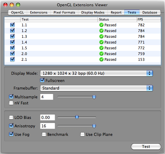

PPZ Posted February 27, 2008 Share Posted February 27, 2008 PPZ, in your latest bench you forgot to check NVFast so i'm not sure you realy get 153 or 129 You seem to me like some kind of philosopher.... btw, I don't remember seeing any of benchmark of YOUR system So, look once more if you wish.First one is normal, NON-overclocked.Second one is OVERCLOCKED, 3.2GHz, CPU Voltage 1.3625 V, PCI Express frequency 105MHz. Whatever.I can pump those benchmarks as you like, but I still don't see any REAL improvement.So, I am starting to think that you are payed by some 8800GT dealer to make commercial for good OS X cards Just joking of course, but I don't see some TERRIBLE difference with that NV thing on.... As Agrafuese said, last test depends alot from CPU, and here is proof: Link to comment https://www.insanelymac.com/forum/topic/89001-gfx-efi-string-for-nvidia-geforce-8800gt-512mb-g92/page/3/#findComment-646445 Share on other sites More sharing options...
agrafuese Posted February 28, 2008 Author Share Posted February 28, 2008 Woah PPZ, those are your scores WITHOUT the benchmark option checked? I just saw that in your screenshots. Is that wrong somehow? Those should be your scores WITH it checked. Without it checked, you should have MUCH higher scores (each one in the 1000s range) if I'm not mistaken. Let me know if I'm missing something, but that doesn't seem right. Also, make sure you aren't running any other programs. btw, I don't remember seeing any of benchmark of YOUR system Seriously! Cough them up cyclone! Let's see this magical system in action (otherwise you ARE a spokesman for Nvidia!) Haha Link to comment https://www.insanelymac.com/forum/topic/89001-gfx-efi-string-for-nvidia-geforce-8800gt-512mb-g92/page/3/#findComment-646668 Share on other sites More sharing options...

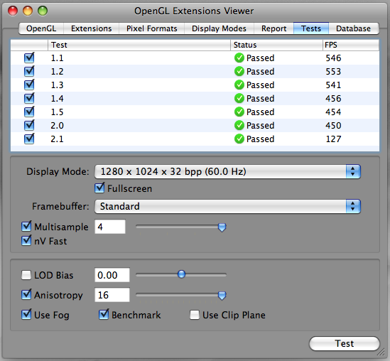

PPZ Posted February 28, 2008 Share Posted February 28, 2008 Oh man, you are torturing me! OK, here are results after I played some time with bios settings and so.... FIRST picture is WITH benchmark on, and PCI Express frequency of standard 100MHz.Second one is also WITH benchmark on, but with PCI Express freq set to 107MHz.As you can see it makes quite a difference.In both cases CPU was clocked to 3GHz. Link to comment https://www.insanelymac.com/forum/topic/89001-gfx-efi-string-for-nvidia-geforce-8800gt-512mb-g92/page/3/#findComment-646806 Share on other sites More sharing options...

agrafuese Posted February 28, 2008 Author Share Posted February 28, 2008 PPZ, I'm really surprised at how bad your scores are. Did you see mine at all? My system is nowhere near as powerful as yours and the scores are about twice as high in some cases. The only one that isn't is the 2.1 score (because of my slower CPU). But the others...you should look into that. Here are some questions for you: Do you have the 512MB or 256MB version of the 8800GT? (I assume 512, but I have to ask to make sure) Did you try switching your monitor to the other output on the card? Are you running ANY programs while benchmarking? With scores like that, it's no wonder you're having such poor performance with your card. Something isn't right. Perhaps your overclocking isn't right? I noticed a significant drop in my scores when I tried to push my FSB the wrong way, so I set it back. When you say "without overclocking" do you mean that you're setting all of your BIOS settings back to default, or only some of them? What is your PCI Express frequency default? Perhaps you need to stay on that...I've heard that that setting is better left untouched in most cases. @LTL: I'm sorry to hear about all of your troubles too. Wish I could suggest something. Are you also overclocking your system? Perhaps this is an issue for you too? EDIT: Just to reinforce what I mean, here are my newest scores when I am overclocked to 2200MHz. The first one is with benchmark turned ON, the second is with it OFF: Link to comment https://www.insanelymac.com/forum/topic/89001-gfx-efi-string-for-nvidia-geforce-8800gt-512mb-g92/page/3/#findComment-646900 Share on other sites More sharing options...
