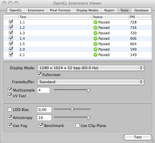

consolation Posted February 28, 2008 Share Posted February 28, 2008 Oh man, you are torturing me! OK, here are results after I played some time with bios settings and so.... FIRST picture is WITH benchmark on, and PCI Express frequency of standard 100MHz.Second one is also WITH benchmark on, but with PCI Express freq set to 107MHz.As you can see it makes quite a difference.In both cases CPU was clocked to 3GHz. You're getting about 30~50% of what you should be scoring. It's almost as if your PCIe bus (100MHz) is being throttled to PCI(33MHz) frequency for some reason. Link to comment https://www.insanelymac.com/forum/topic/89001-gfx-efi-string-for-nvidia-geforce-8800gt-512mb-g92/page/4/#findComment-647009 Share on other sites More sharing options...

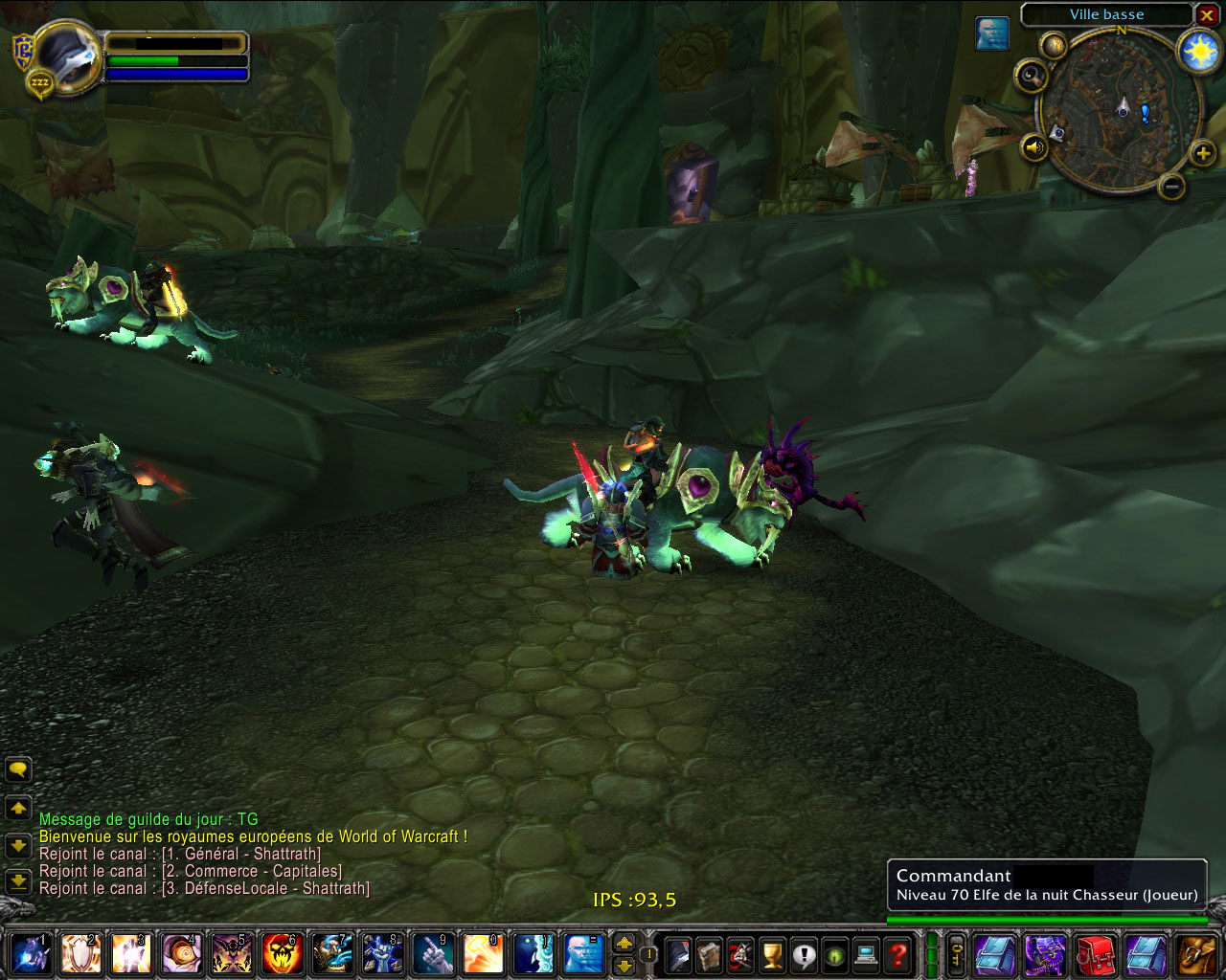

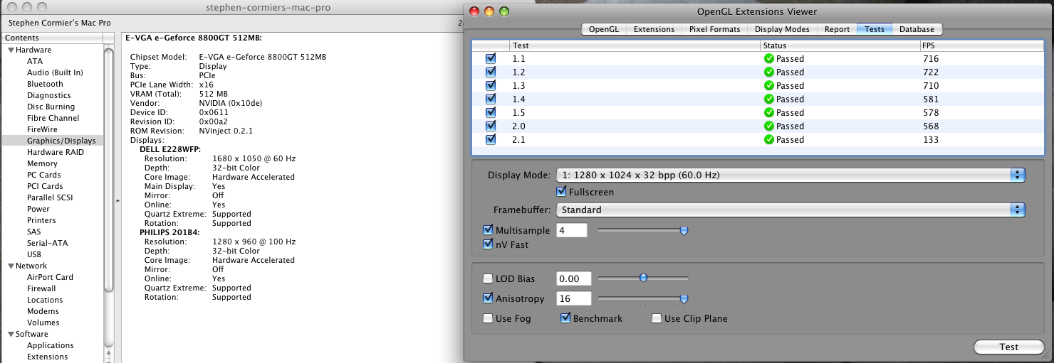

cyclonefr Posted February 28, 2008 Share Posted February 28, 2008 Here are my benchs, pretty much the same as everybody here except PPZ. @LTL : and if you put your 7300GT, you can play the SAME WoW folder just fine ? Are you sure ? If so, you must have a problem on your 8800 GT, I'd suggest you get a replacement real quick. And here is some WoW screenshot in 1280x1024 FSAA 1X, everything else to the MAX (anisotropic x16 etc) Try to get the same FPS I get in this screenshot with anything else than 8800 GT, 'cuz you won't ! And this particular zone is known to be one of the most low FPS zone, even in Windows. If you have WoW, go try at the EXACT same place using your GeForce 7300GT and you'll see how GOOD is the 8800GT compared to it. EDIT : my GeForce isn't o/c at all. It's a plain normal one, one of the first. Of course i'm not a nvidia spokeperson, it's just i'm fed up about people coming around there and crying cause some {censored} benchs tells him he has a 7300GT result. Yes, Call of Duty 2 is buggy on NVIDIA, so if you wanna play it go buy an ATI.... Link to comment https://www.insanelymac.com/forum/topic/89001-gfx-efi-string-for-nvidia-geforce-8800gt-512mb-g92/page/4/#findComment-647065 Share on other sites More sharing options...

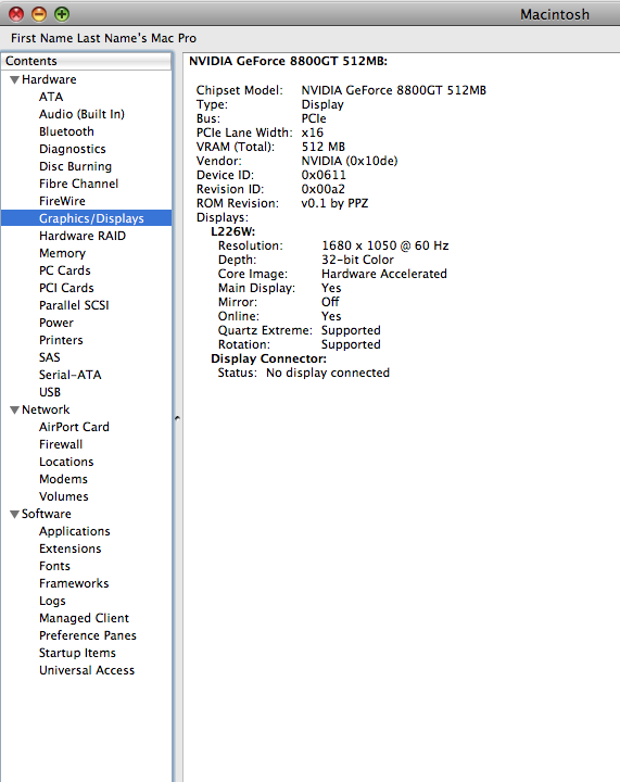

PPZ Posted February 28, 2008 Share Posted February 28, 2008 @Agrafuese , I don't touch anything else except CPU and PCI Express FSB when overclocking.Then setting is 333 x 9 for CPU and 107MHz PCI Express FSB. When everything is default, then I return CPU speed to default (266 x 9) and PCI express FSB to 100MHz. I see that my card is not performing as well as it should, so, here are my full specs: Mobo : Gigabyte G33M-DS2R CPU : Core2Duo E6600 (2.4GHz default) GPU : Gigabyte GV-NX88T512HP (8800GT/512MB , turboforce edition, factory oc'ed) RAM : 2 x 1GB Supertalent 667MHz DDR2 (dualchannel) PSU : Chieftec 550W with active PFC HDD's : 1 x 500GB, 1 x 320GB , 1 x 250GB , all Seagate, SATA DVDRW: NEC 7170S (SATA, not PATA) and ofcourse, Kalyway Leopard 10.5.2 (with GFX strings just for GPU) In windows card is performing better than most of similar cards, so I exclude possibility od problematic card.Also I don't think CPU is bottleneck, nor any component of the system.I say, meybe I could take 800MHz DDR2, but that is certainly not reason why card is performing worst than it should. Link to comment https://www.insanelymac.com/forum/topic/89001-gfx-efi-string-for-nvidia-geforce-8800gt-512mb-g92/page/4/#findComment-647174 Share on other sites More sharing options...

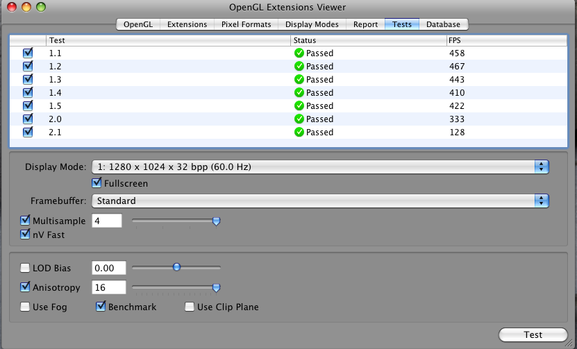

LTL Posted February 28, 2008 Share Posted February 28, 2008 Here are my benchs, pretty much the same as everybody here except PPZ. @LTL : and if you put your 7300GT, you can play the SAME WoW folder just fine ? Are you sure ? If so, you must have a problem on your 8800 GT, I'd suggest you get a replacement real quick. And here is some WoW screenshot in 1280x1024 FSAA 1X, everything else to the MAX (anisotropic x16 etc) Try to get the same FPS I get in this screenshot with anything else than 8800 GT, 'cuz you won't ! And this particular zone is known to be one of the most low FPS zone, even in Windows. If you have WoW, go try at the EXACT same place using your GeForce 7300GT and you'll see how GOOD is the 8800GT compared to it. EDIT : my GeForce isn't o/c at all. It's a plain normal one, one of the first. Of course i'm not a nvidia spokeperson, it's just i'm fed up about people coming around there and crying cause some {censored} benchs tells him he has a 7300GT result. Yes, Call of Duty 2 is buggy on NVIDIA, so if you wanna play it go buy an ATI.... I have not even taken the 7300GT out of the box... its there as a back up. I would hate to have to go thru the whole process of testing out... but maybe I have to do that to see if the 8800GT has some issues..which is always possible. It crashes my entire system even when I run the tests you guys are running. Maybe I will go trade it in for an Asus or something, its a Gigabyte As well, you guys are lucky to be playing close to WOW servers, out here in Thailand I get horrible latency Link to comment https://www.insanelymac.com/forum/topic/89001-gfx-efi-string-for-nvidia-geforce-8800gt-512mb-g92/page/4/#findComment-647479 Share on other sites More sharing options...
agrafuese Posted February 28, 2008 Author Share Posted February 28, 2008 @PPZ: That is very odd. Have you changed the Info.plist of all your video kext files? I think I listed the ones to change for someone else earlier in this thread. You have to do this even if you are running GFX-EFI. I personally overwrote all of the other Device IDs with mine (instead of adding it to the end of the list like some people do). This is all I can think of right now... Link to comment https://www.insanelymac.com/forum/topic/89001-gfx-efi-string-for-nvidia-geforce-8800gt-512mb-g92/page/4/#findComment-647666 Share on other sites More sharing options...
cyclonefr Posted February 28, 2008 Share Posted February 28, 2008 @LTL : Having two GeForce in your PC might be the problem ? I dunno, you need to do tests. And for your information, I don't play WoW anymore, I just use it as a bench Thanks to a friend I can actually connect to the server, but I don't play it Correct me if i'm wrong but I don't think there is a more populated aera than Shattrah. Btw with the same settings I get about 250 fps in Ironforge Link to comment https://www.insanelymac.com/forum/topic/89001-gfx-efi-string-for-nvidia-geforce-8800gt-512mb-g92/page/4/#findComment-647786 Share on other sites More sharing options...

LTL Posted February 29, 2008 Share Posted February 29, 2008 @LTL : Having two GeForce in your PC might be the problem ? I dunno, you need to do tests. And for your information, I don't play WoW anymore, I just use it as a bench Thanks to a friend I can actually connect to the server, but I don't play it :)Correct me if i'm wrong but I don't think there is a more populated aera than Shattrah. Btw with the same settings I get about 250 fps in Ironforge Thanks again for your help and feedback, people like you make this community great! Your right I need to do more testing. I don't have a second card in my box, its only that one 8800GT, i'm using your dump, but will try agrafuse's now. I wonder if it is my card? Easy way to figure that out would be to install windows on my machine and see how it performs.I have not had the time to play WoW in a long time...sadly .. it was a lot of fun a few years ago, but now its tough living in Asia and trying to play ... plus work is very demanding I will do some testing today...lazy friday at the office and get back to you ASAPthanks!!!!!Hey guys, should I make any mods under system/library/extensions/GeForice8xxxGLDriver.bundle?Hey guys, should I make any mods under system/library/extensions/GeForice8xxxGLDriver.bundle?Prob a dumb question since i'm wading into unknown waters... should I make any mods under system/library/extensions/GeForice8xxxGLDriver.bundle? Link to comment https://www.insanelymac.com/forum/topic/89001-gfx-efi-string-for-nvidia-geforce-8800gt-512mb-g92/page/4/#findComment-648303 Share on other sites More sharing options...

PPZ Posted February 29, 2008 Share Posted February 29, 2008 @agrafuese , No, I didn't modify info.plist files.I tried now but I forgot to modify Geforce.kext and screwed my installation.So, I am reinstalling right now and then I will try again.Can you explain which exactly kexts should be modified and how do we put device id inside.I mean, I know all the procedure, but I want to know in which order you are putting device id. The files I have to modify are NVDAResman.kext, Geforce.kext and NVDANV50Hal.kext , right? Now, my device id iz 0x0611 and revision ID is 0x00a2.Should I put in info.plist in order : 0x061100a2 or 0x00a20611 ? long time ago I had an issue with reversed ID and rev. number, that's why I ask.But back then, it was other vga card... But It's just a thought, how everything was working without modifying those plists? I mean, I had 3D acceleration, and everything was functioning? Link to comment https://www.insanelymac.com/forum/topic/89001-gfx-efi-string-for-nvidia-geforce-8800gt-512mb-g92/page/4/#findComment-648528 Share on other sites More sharing options...

agrafuese Posted March 1, 2008 Author Share Posted March 1, 2008 Ofcourse, you could just answer my question, but never mind.You decided to write a tutorial I am finishing now installation, as I was out of home 'till now, so will be back with news... sorry about that. i actually didn't read your whole post at first. you're right about which files to edit the Info.plists for. I also did the other HAL files too (not just 50) The only thing is, you're wrong on the device ID. you're supposed to do device ID + vendor ID, which is 0x061110de. Add that to all of the kexts and be sure to just overwrite the other IDs you see in there, to be safe. make sure NVinject.kext is deleted too. that should be enough info for now. if you can't get it to run, the tutorial will be coming soon. @DWells55: Glad I could help. Have fun with it Link to comment https://www.insanelymac.com/forum/topic/89001-gfx-efi-string-for-nvidia-geforce-8800gt-512mb-g92/page/4/#findComment-649420 Share on other sites More sharing options...
PPZ Posted March 1, 2008 Share Posted March 1, 2008 Just a fast report.I did fresh install, modified all the kexts, installed gfx strings again, but no luck.Card is running the same as before.I can't think of anything else.Except those bad results on benchmark, card is working ok.Hardware acceleration, games, applications.Just not as fast as it should be.At least I think it should be faster.Never mind.I have no time to experiment further.I am travelling tomorrow, so I will deal with the card after I come back.Then I will try to drop in some borrowed card with same chipset, but other manufacturer, to see is it card issue.Again I repeat that under windows is working normal.I get better FPS in games under windows than many of other similar cards.That would say or drivers under OS X have problem, or there is some other kind of incompatibility between mobo and card (or OS X and card).Maybe it has to do because my card is PCIx 2.0 compatible? it should not be a problem, since Gigabyte sais it's backward compatible... Link to comment https://www.insanelymac.com/forum/topic/89001-gfx-efi-string-for-nvidia-geforce-8800gt-512mb-g92/page/4/#findComment-649622 Share on other sites More sharing options...
