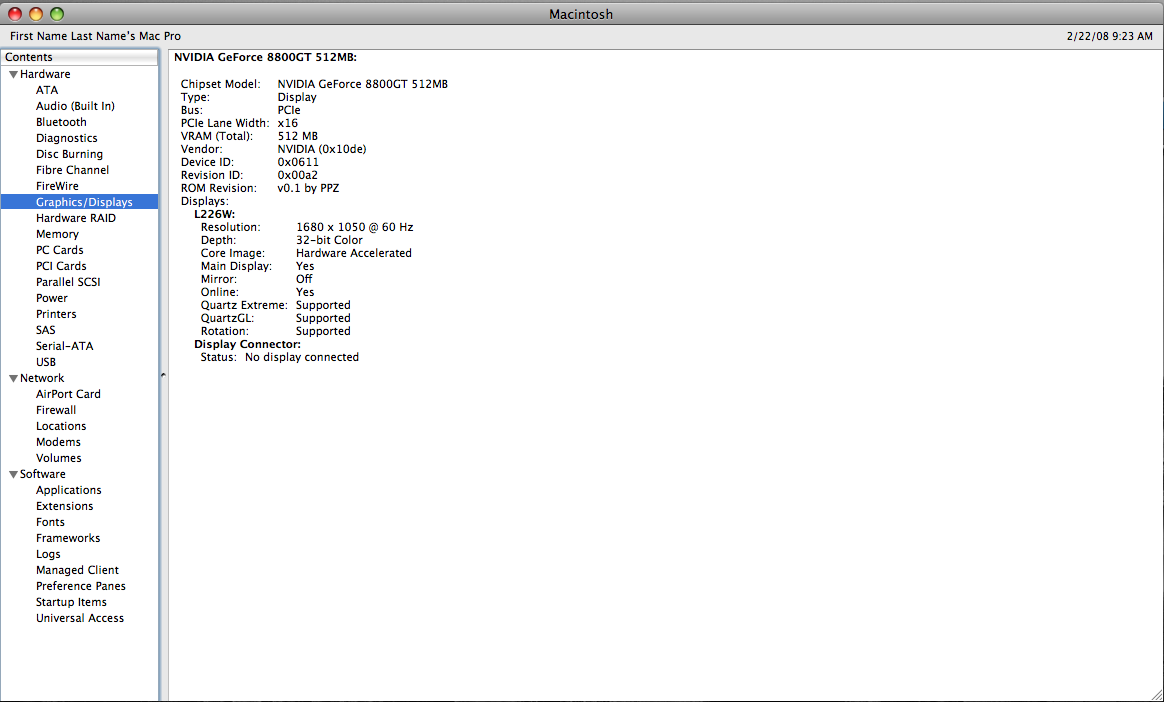

PPZ Posted February 22, 2008 Share Posted February 22, 2008 I made it by your instructions.It works like a charm!!! Thanks! I had exactly the same problem with device path, but found it with help of gfxutil, made my own gfx string and now it's working! Quite better than with NVinject. My card is Gigabyte GV-NX88T512HP (G92, with Zalman cooler) Here is snapshot (sorry for changing information in ROM Revision.All credists go to you!) And for those who want to try out ready string, here it is: d80300000100000001000000cc0300001500000002010c00d041030a01000000010106000001010160000007fff040014000000400032002c006e0061006d00650000001100000073656e736f722d706 72656e74220000005600520041004d002c0074006f00740061006c00730069007a00650000000800 0000000002036000000400032002c00680077006300740072006c002d0070006100720061006d007 002d00760065007200730069006f006e00000008000000000000021c000000640065007600690063 065005f0074007900700065000000100000004e5644412c4765466f7263650e0000006e0061006d0 650000000f0000004e5644412c506172656e7422000000400030002c006400650076006900630065 05f00740079007000650000000b000000646973706c6179100000006d006f00640065006c0000001 0000004e5649444941204765466f72636520383830304754203531324d4222000000400031002c00 400650076006900630065005f00740079007000650000000b000000646973706c617912000000400 32002c007200650067000000080000000000000222000000400032002c0064006500760069006300 5005f0074007900700065000000120000004e5644412c6770752d64696f646520000000400032002 0063006f006d00700061007400690062006c0065000000160000004e5644412c73656e736f722d70 172656e7422000000400032002c002300730069007a0065002d00630065006c006c0073000000080 00000000000020000000400031002c0063006f006d00700061007400690062006c00650000000e00 0004e5644412c4e564d616314000000400030002c006e0061006d0065000000120000004e5644412 446973706c61792d413a000000400032002c0068007700730065006e0073006f0072002d00700061 0720061006d0073002d00760065007200730069006f006e000000080000000000000226000000400 32002c0023006100640072006500730073002d00630065006c006c00730000000800000000000001 4000000400031002c006e0061006d0065000000120000004e5644412c446973706c61792d4220000 00400030002c0063006f006d00700061007400690062006c00650000000e0000004e5644412c4e56 d61631e00000072006f006d002d007200650076006900730069006f006e0000000f00000076302e3 2062792050505a100000004e00560043004100500000001800000004000000000003000c00000000 00007000000000e0000004e00560050004d000000200000000100000000000000000000000000000 000000000000000000000000 Link to comment https://www.insanelymac.com/forum/topic/89001-gfx-efi-string-for-nvidia-geforce-8800gt-512mb-g92/#findComment-637261 Share on other sites More sharing options...

agrafuese Posted February 22, 2008 Author Share Posted February 22, 2008 @PPZ - I notice that you have QuartzGL enabled. Does that work well for you? I was actually experimenting with it today and I found out that it killed my performance and gave me terrible slow downs... Link to comment https://www.insanelymac.com/forum/topic/89001-gfx-efi-string-for-nvidia-geforce-8800gt-512mb-g92/#findComment-637552 Share on other sites More sharing options...

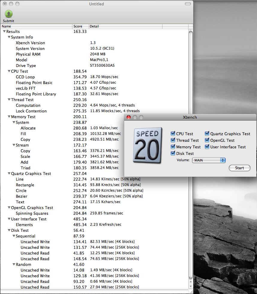

PPZ Posted February 22, 2008 Share Posted February 22, 2008 Hmmmm, I didn't test WITHOUT QuartzGL, but I didn't notice any slowdown.Before I had ATI X1800GTO which I must tell you was better performing in my system, but I was into experimenting so I took 8800GT.With nvinject, card had choppy graphics, not exactly good.Now everything is good.I will try it without QuartzGL and let you know... [edit]Actually, you are right.I tried now with and without QuartzGL, and system is better performing WITHOUT.Here are results[/edit] @cyclonefr , I tried your string but no luck on my card.I changed device path, but again nothing.If I will have time I will test it at my friend's system, which differs only by motherboard (945 chipset) and let know about results. Link to comment https://www.insanelymac.com/forum/topic/89001-gfx-efi-string-for-nvidia-geforce-8800gt-512mb-g92/#findComment-638324 Share on other sites More sharing options...

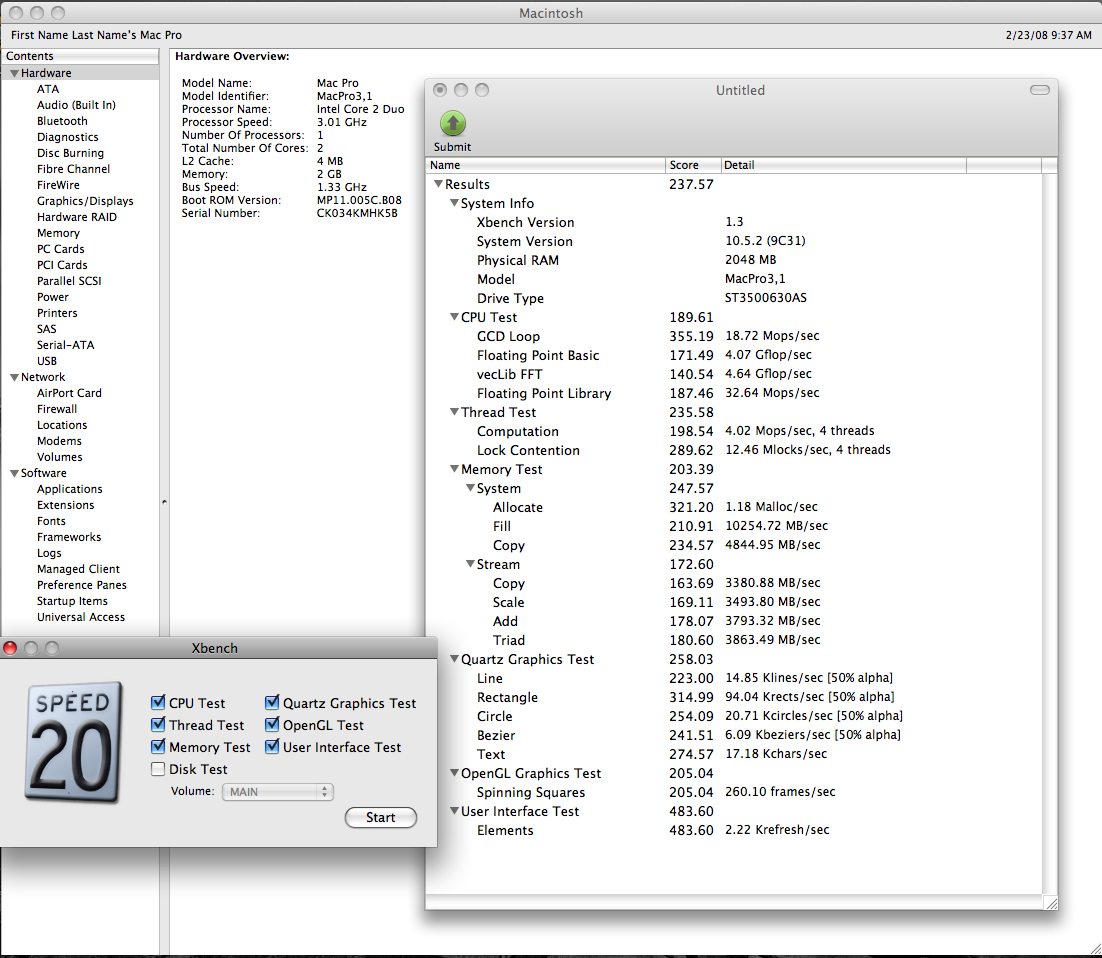

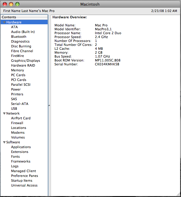

agrafuese Posted February 23, 2008 Author Share Posted February 23, 2008 holy PPZ! what is your system? can you post your specs? your xBench score is beautiful! i want whatever you have!! haha. my score is only like 116 at BEST. Just FYI, I posted the Mac Pro 8800GT dumped string a week ago on another thread, just check my posts Sorry cyclonefr, I didn't mean to steal your thunder Hope you don't mind sharing some of the fame with me when we get rich. Hahaha. j/k ... I honestly didn't know, but thanks for pointing it out. Link to comment https://www.insanelymac.com/forum/topic/89001-gfx-efi-string-for-nvidia-geforce-8800gt-512mb-g92/#findComment-638641 Share on other sites More sharing options...

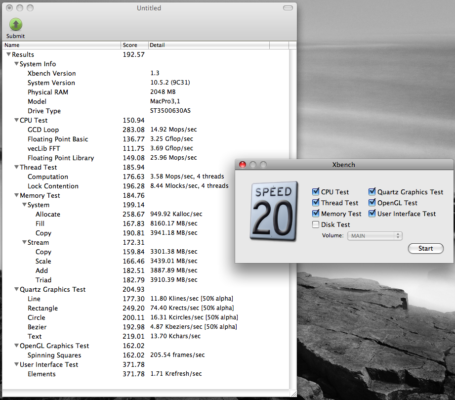

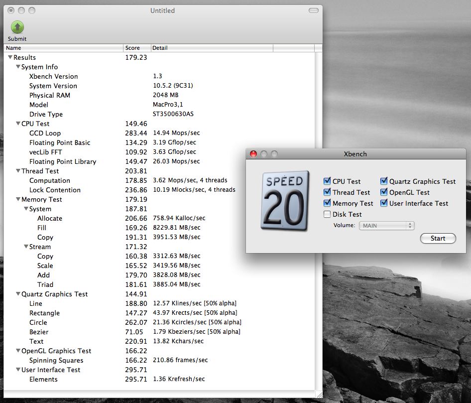

Headrush69 Posted February 23, 2008 Share Posted February 23, 2008 holy PPZ! what is your system? can you post your specs? your xBench score is beautiful! i want whatever you have!! haha. my score is only like 116 at BEST. Turning off the Disk test will probably raise most people's score substantially. Link to comment https://www.insanelymac.com/forum/topic/89001-gfx-efi-string-for-nvidia-geforce-8800gt-512mb-g92/#findComment-638662 Share on other sites More sharing options...

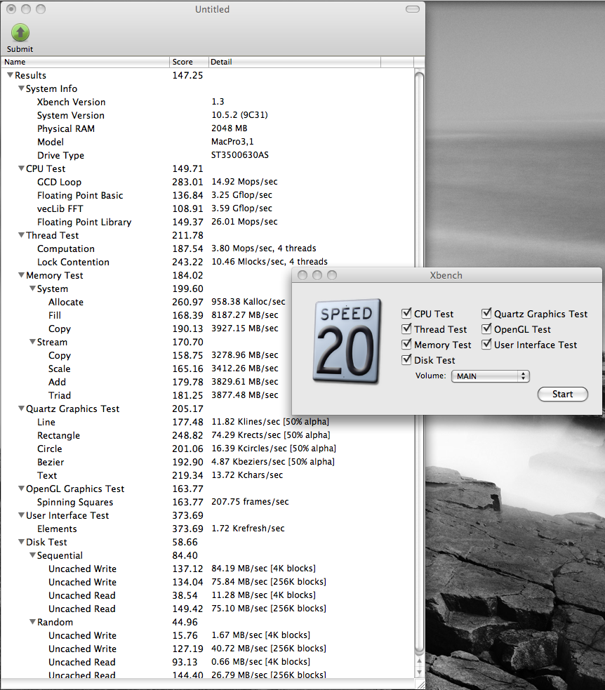

PPZ Posted February 23, 2008 Share Posted February 23, 2008 I don't think that when you are benchmarking one system's CPU and Graphics power is important to have and disk test.I know for this, but disk speed is more/less same to everybody.However, I made on screenshot WITH disk test, just for reference.I could probably get better with 800MHz DDR2, and some tweaking, but I am satisfied with the system as it is.Only thing I plan in future is to upgrade memory to 4GB.... As for the system, specs are: Motherboard : Gigabyte G33M-DS2R Memory : 2 x 1GB 667MHz Supertalent (dual channel) CPU : Core2Duo E6600 @ 2.4GHz (stock speed, no overclocking) GPU : Gigabyte GV-NX88T512HP (Turboforce edition) DVDRW : NEC AD-7170S (SATA) HDD's : Seagate 500GB,320GB,250GB (SATA) PSU : Chieftec 550W.... And here are some screenshots from overclocked system.Motherboard I have is great overclocker! I clocked my 2.4GHz CPU easily on 3GHz with default voltage! First screenshot is with disk test, second overclocked WITHOUT disk test, third overclocked WITH disk test.... Link to comment https://www.insanelymac.com/forum/topic/89001-gfx-efi-string-for-nvidia-geforce-8800gt-512mb-g92/#findComment-638855 Share on other sites More sharing options...

cyclonefr Posted February 23, 2008 Share Posted February 23, 2008 holy :censored2: PPZ! what is your system? can you post your specs? your xBench score is beautiful! i want whatever you have!! haha. my score is only like 116 at BEST. :(Sorry cyclonefr, I didn't mean to steal your thunder Hope you don't mind sharing some of the fame with me when we get rich. Hahaha. j/k ... I honestly didn't know, but thanks for pointing it out. I know you didn't know, i'm just saying this if people want the "real" thing, I don't wanna fight Anyway if you want it, here it is http://forum.insanelymac.com/index.php?s=&...st&p=623046 I modified this string for P35 mobo since I use ASUS P5K, feel free to change the PCI address if you have any problem. It was different on Mac Pro. Link to comment https://www.insanelymac.com/forum/topic/89001-gfx-efi-string-for-nvidia-geforce-8800gt-512mb-g92/#findComment-639047 Share on other sites More sharing options...
Headrush69 Posted February 23, 2008 Share Posted February 23, 2008 I don't think that when you are benchmarking one system's CPU and Graphics power is important to have and disk test.I know for this, but disk speed is more/less same to everybody. Wasn't the point. It was just that for comparisons to everyone else that posts complete scores it makes your system seem higher than it really is. (Proven by agrafuese's response) Makes no difference, just clarifying. (BTW, xbench sucks anyways, we need to find a better all inclusive standard benchmark for us to compare.) Link to comment https://www.insanelymac.com/forum/topic/89001-gfx-efi-string-for-nvidia-geforce-8800gt-512mb-g92/#findComment-639594 Share on other sites More sharing options...
agrafuese Posted February 24, 2008 Author Share Posted February 24, 2008 @PPZ: Thank you for all the info. Your scores are still really great even WITH disk test, and I am still jealous (BTW, xbench sucks anyways, we need to find a better all inclusive standard benchmark for us to compare.) Yeah I agree, xBench is like 1.5 years old ... and geekbench is a little strange for me sometimes...gives random scores. Link to comment https://www.insanelymac.com/forum/topic/89001-gfx-efi-string-for-nvidia-geforce-8800gt-512mb-g92/#findComment-640180 Share on other sites More sharing options...
