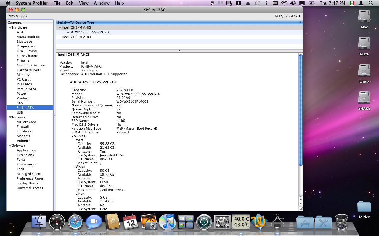

macgirl Posted June 12, 2008 Author Share Posted June 12, 2008 One way to know if your DVD is SATA is with System Profiler, if at least a conroller is shown there it is bcuase with SATA any drive has its own port, IDE can have 2 port with each controller. Also if you have Windows or Linux installed you an see at Device Manager or the equivalent in Linux. Link to comment Share on other sites More sharing options...

macgirl Posted June 13, 2008 Author Share Posted June 13, 2008 shows me no ATA devises, and 2 sata devices. One of which shows my hard drive, the other has nothing supposedly. In System Profiler I also have 2 ports but my DVD is IDE see: Is there a thread for the XPS M1730?I can't find anything, thanks. I didnt see any. Link to comment Share on other sites More sharing options...
