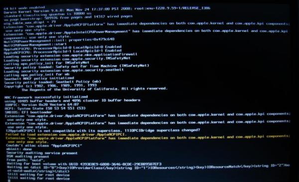

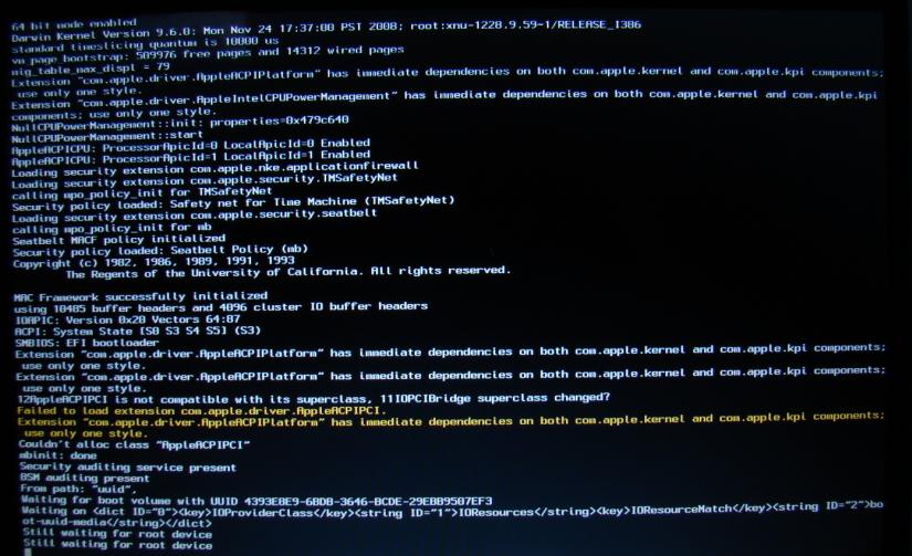

bredroll Posted September 5, 2009 Share Posted September 5, 2009 Hi, I have put the IOPCMCIAFamily.kext in the Extension folder with the right permissions but now leo (10.5.6) on my R52 won't boot.. it hang with no errors. Here is a photo of the boot (10 minutes + with no reactions). Any id�a ? Sry for my poor english i'm french. Thank you a lot Hello, I had the same ( where boot gets stuck just after detecting the pcmcia bridge ), I found that this was because I had the IOPCCard kext in the Extensions folder instead of inside the IOPCMCIAFamily/Content/PlugIns folder. It meant that the kernel would expect the newly found PCMCIA bridge to siddenly attach the root disk ( some netbooks have pcmcia attached disks ) so would wait forever for the boot drive. Don't directly put IOPCCard into Extensions Link to comment https://www.insanelymac.com/forum/topic/81036-cardbuspcmcia-pc-cards-for-leopard/page/42/#findComment-1252712 Share on other sites More sharing options...

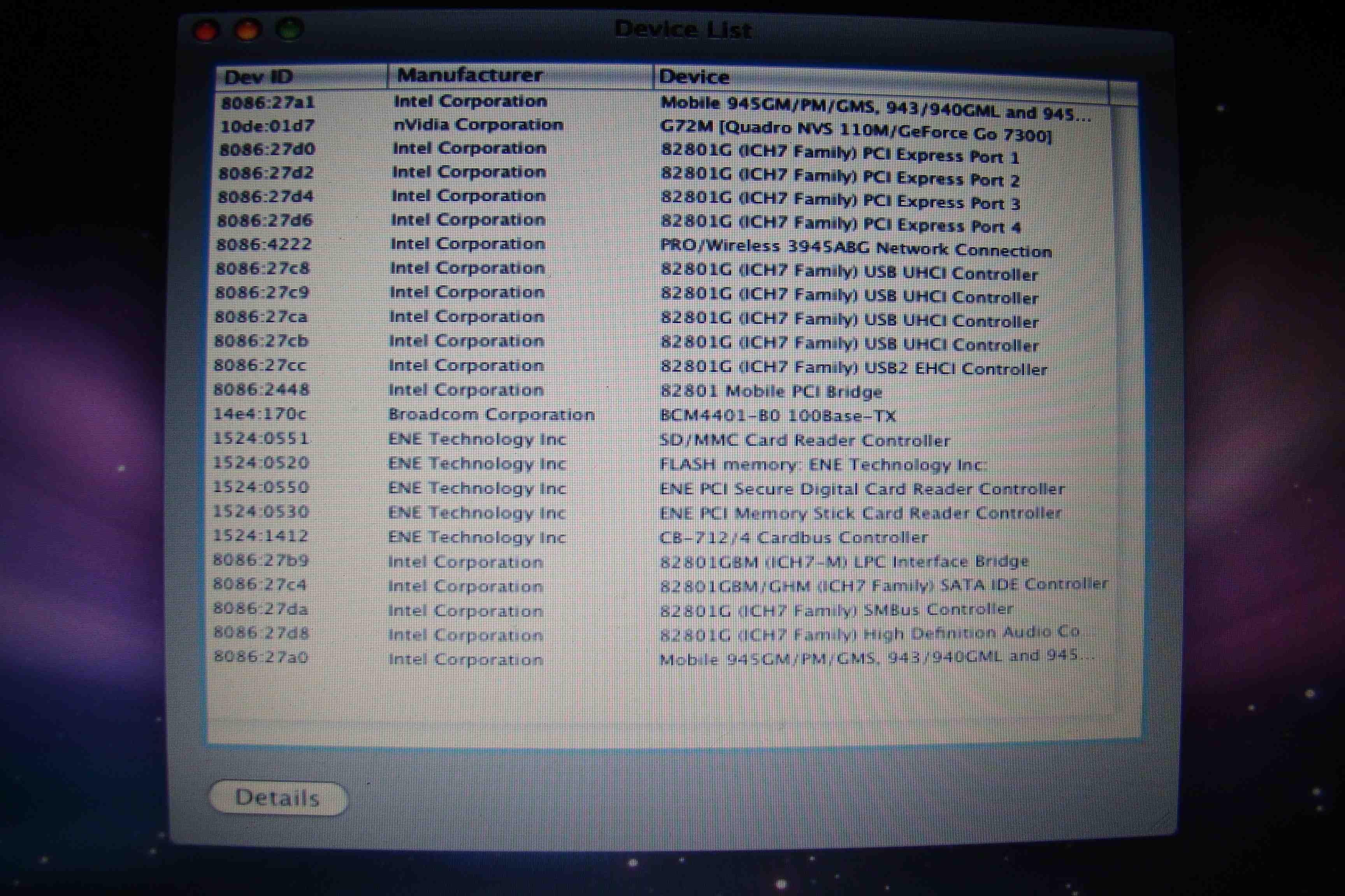

gobe Posted September 7, 2009 Share Posted September 7, 2009 Hi everybody, first I want to thank for this great Project and I'm sorry for my bad english (hungarian living in germany). I've a problem with my FireWire-PCMCIA-Card on an Acer Aspire 5610z. Saw a lot of posts for Acer Notebooks but unfortunately nothing helped me. Cardbus-Controller is an: ene cb-712/ 714/810 FireWire-Card (2 ports): exsys ex-6600e (TI Chips) So here's what I did. Installed a 10.5.6 System by XxX. Installed the IOPCMCIAFamily.kext for 10.5.6 (with the right rights), but the System hangs without error-msgs. Than I tried rev8 and the Sytem was booting and recognizes the controller. Even the FireWire-Card is found. But the Problem is that no devices are recognized when I connect them to the FireWire-Card. First the System-Profiler said there are no FireWire-Drivers loaded, so I loaded them manually and the System-Profiler-Message changed to "Unable to list FireWire devices". Unfortunately this message tells the truth. Here are my dmesg-outputs. After loading IOPCCardFamily.kext and all FireWire-Kexts manually: bash-3.2# dmesg | grep PC Extension "com.apple.driver.ApplePCIConfigurator" has immediate dependencies on both com.apple.kernel and com.apple.kpi components; use only one style. PCI configuration changed (bridge=0 device=5 yenta=1) Got boot device = IOService:/AppleACPIPlatformExpert/PCI0@0/AppleACPIPCI/SATA@1F,2/AppleIntelPIIXATARoot/PRID@0/AppleIntelIC HxSATA/ATADeviceNub@0/AppleATADiskDriver/IOATABlockStorageDevice/IOBlockStorageDriver/WDC WD1600BEVS- 22RST0 WDC WD1600BEVS-22RST0/IOFDiskPartitionScheme/Untitled 3@3 IOPCCard info: Intel PCIC probe: ENE 712/4 rev 10 After inserting the FireWire-Card: bash-3.2# dmesg | grep PC Extension "com.apple.driver.ApplePCIConfigurator" has immediate dependencies on both com.apple.kernel and com.apple.kpi components; use only one style. PCI configuration changed (bridge=0 device=5 yenta=1) Got boot device = IOService:/AppleACPIPlatformExpert/PCI0@0/AppleACPIPCI/SATA@1F,2/AppleIntelPIIXATARoot/PRID@0/AppleIntelIC HxSATA/ATADeviceNub@0/AppleATADiskDriver/IOATABlockStorageDevice/IOBlockStorageDriver/WDC WD1600BEVS- 22RST0 WDC WD1600BEVS-22RST0/IOFDiskPartitionScheme/Untitled 3@3 IOPCCard info: Intel PCIC probe: ENE 712/4 rev 10 IOPCCard info: cs: cb_alloc(bus 7): vendor 0x104c, device 0x8023 IOPCCard info: cs: cb_alloc(bus 7): found 1 functions IOPCCard info: cs: cb_config(bus 7) IOPCCard info: fn 0 bar 1: mem 0xa000d000-0xa000d7ff IOPCCard info: fn 0 bar 3: mem 0xa000c000-0xa000c7ff IOPCCard info: fn 0 bar 2: mem 0xa0008000-0xa000bfff IOPCCard info: irq 16 bash-3.2# dmesg | grep FireWire FireWire (OHCI) TI ID 8023 CardBus now active, GUID 2e0300422e040043; max speed s100. bash-3.2# Additionally I tried to load all Kexts while boot-time, with and without inserted FW-Card. Still the same problem. Any Ideas? Thanks a lot. Cheers gobe Link to comment https://www.insanelymac.com/forum/topic/81036-cardbuspcmcia-pc-cards-for-leopard/page/42/#findComment-1255763 Share on other sites More sharing options...

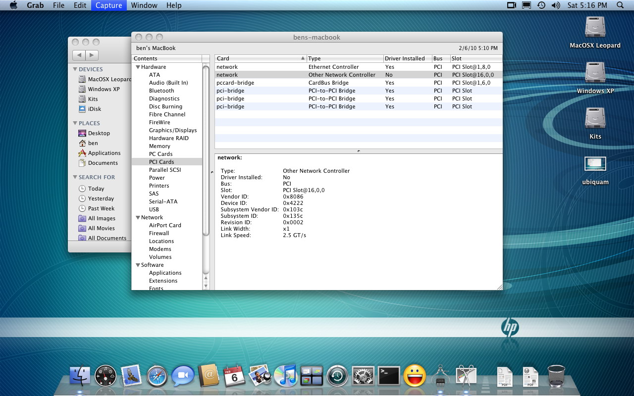

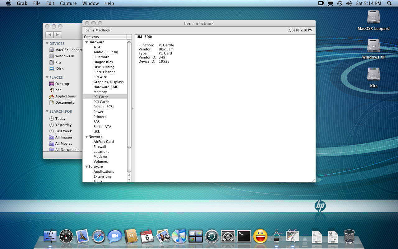

mr ben Posted February 6, 2010 Share Posted February 6, 2010 hello ppl, i have installed iDeneb 1.6 (10.5.8) lite edition and the only problem that i have is that i cannot use my PCMCIA modem (EV-DO) card to connect to the internet by dialing a connection with this PCMCIA card type II. as you can see the card i think is installed because i can turn it off by pressing turn off from taskbar from up. The thing is that i cannot find this card in Network to can setup the PPP conection. Is there anyone that can help me to use this card? I have an HP530 Notebook PC Core Duo 2.17 Ghz, 1,5 GB Ram, Intel GMA950 video card, 3945ABG wireless Thank you Link to comment https://www.insanelymac.com/forum/topic/81036-cardbuspcmcia-pc-cards-for-leopard/page/42/#findComment-1404818 Share on other sites More sharing options...
