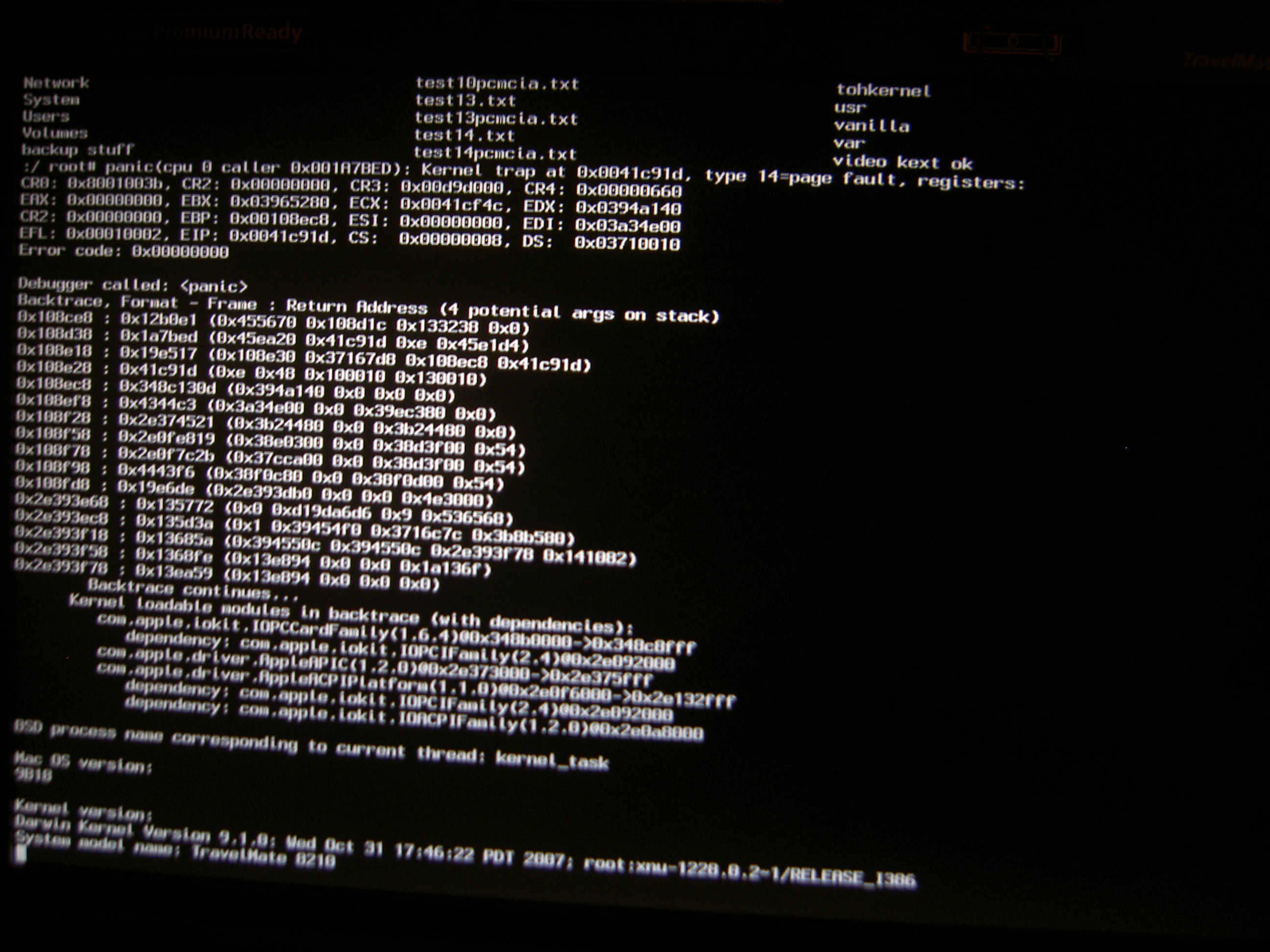

snam11 Posted February 11, 2008 Share Posted February 11, 2008 Hi snam11 and kizwan, Here is the test IOPCIFamily. Try it and let me know the dmesg result under singleuser mode. If kernel panic happens, show me the picture if possible or let me know where it stops. Thanks a lot. Again, don't forget to backup your original files while trying it. Chun-Nan IOPCIFamily.test.only.zip hi chun-nan, with this release i get kp. i can boot only in safe mode, if pcmcia is not plugged in. here is the dmesg: to 400:8f8 for 0:400 overlap 400 clipped bridge MEM range head to e0000:0 for 0:100000 overlap 20000 clipped bridge MEM range head to dc000:0 for 0:100000 overlap 24000 clipped bridge MEM range head to d8000:0 for 0:100000 overlap 28000 clipped bridge MEM range head to d4000:0 for 0:100000 overlap 2c000 clipped bridge MEM range head to d0000:0 for 0:100000 overlap 30000 clipped bridge MEM range head to a0000:0 for 0:100000 overlap 60000 clipped bridge I/O range head to 1000:f000 for 0:1000 overlap 300 clipped bridge I/O range head to 400:0 for 0:1000 overlap c00 PFM: sub-range outside parent range: 0x0:0x100000 I/O: sub-range outside parent range: 0x0:0x1000 PFM: sub-range outside parent range: 0x0:0x100000 I/O: sub-range outside parent range: 0x0:0x1000 PFM: sub-range outside parent range: 0x0:0x100000 I/O: sub-range outside parent range: 0x0:0x1000 PFM: sub-range outside parent range: 0x0:0x100000 I/O: sub-range outside parent range: 0x0:0x1000 MEM: 2 sub-range limited to 374fde00 each I/O: 6 sub-range limited to 253a each BUS: 2 sub-range limited to 7b each I/O: allocated block 1000:8 I/O: allocated block 1008:4 I/O: allocated block 1010:8 I/O: allocated block 100c:4 I/O: allocated block 1020:10 MEM: allocated block 80000000:100000 BUS: allocated block 3:1 MEM: allocated block 80100000:200000 I/O: allocated block 3000:1000 BUS: allocated block 5:1 pciBridgeAllocateResource(bus 10, state 3) Allocating resources on bus 10 MEM: 4 sub-range limited to 40000 each BUS: 2 sub-range limited to 0 each MEM: allocated block d0400000:1000 MEM: allocated block d0401000:800 MEM: allocated block d0402000:1000 MEM: allocated block d0403000:1000 pciBridgeAllocateResource(bus 7, state 3) pciBridgeAllocateResource(bus 6, state 3) pciBridgeAllocateResource(bus 3, state 3) Allocating resources on bus 3 MEM: 1 sub-range limited to 100000 each MEM: allocated block 80000000:1000 pciBridgeAllocateResource(bus 4, state 3) pciBridgeAllocateResource(bus 5, state 3) Allocating resources on bus 5 MEM: 2 sub-range limited to 100000 each I/O: 1 sub-range limited to 1000 each MEM: allocated block 80100000:20000 MEM: allocated block 80200000:100000 I/O: allocated block 3000:20 pciBridgeAllocateResource(bus 2, state 3) pciBridgeAllocateResource(bus 1, state 3) Allocating resources on bus 1 MEM: 2 sub-range limited to 80000 each PFM: 1 sub-range limited to 10000000 each I/O: 1 sub-range limited to 1000 each PFM: allocated block c0000000:10000000 I/O: allocated block 2000:100 MEM: allocated block d0200000:10000 MEM: allocated block d0220000:20000 pciBridgeAllocateResource(bus 0, state 3) pciBridgeAllocateResource(bus 11, state 3) PCI configuration changed (bridge=2 device=14 yenta=0) Extension "com.apple.driver.AppleACPIPlatform" has immediate dependencies on both com.apple.kernel and com.apple.kpi components; use only one style.mbinit: done Security auditing service present BSM auditing present Starting AppleACPIPS2Nub Found mouse PNP device AppleACPIPS2Nub startup complete From path: "uuid", Waiting for boot volume with UUID F4EDFD34-C9E7-3FF1-A157-8A7E8C92493B Waiting on <dict ID="0"><key>IOProviderClass</key><string ID="1">IOResources</string><key>IOResourceMatch</key><string ID="2">boot-uuid-media</string></dict> IOPCCard info: Intel PCIC probe: O2Micro OZ711MP1/MS1 rev 21IOPCCardBridge::checkBridgeBusIDs invalid sub/cardbus/pci settings of 0x0 FireWire (OHCI) VendorID 1217 ID f7 PCI now active, GUID 009fc0001a119e00; max speed s400. Extension "com.apple.driver.iTunesPhoneDriver" has no explicit kernel dependency; using version 6.0. Got boot device = IOService:/AppleACPIPlatformExpert/PCI0@0/AppleACPIPCI/USB7@1D,7/AppleUSBEHCI/NOONTEC USB Storage@fd410000/MSC Bulk-Only Transfer@0/IOUSBMassStorageClass/IOSCSIPeripheralDeviceNub/IOSCSIPeripheralDeviceType00/IOBlockStorageServices/IOBlockStorageDriver/Maxtor 6 AD1G Media/IOFDiskPartitionScheme/Untitled 1@1 BSD root: disk1s1, major 14, minor 4 HFS: Removed 2 orphaned unlinked files or directories as soon i plug in the pcmcia card i get kp also in safe mode(1st kp picture). if i boot in standard mode, i get kp too (2nd kp picture). regards Link to comment https://www.insanelymac.com/forum/topic/81036-cardbuspcmcia-pc-cards-for-leopard/page/16/#findComment-617745 Share on other sites More sharing options...

~Eureka Posted February 11, 2008 Author Share Posted February 11, 2008 Hi snam11 and kizwan, Here is another test IOPCIFamily. Try it and let me know the dmesg result under singleuser mode. If kernel panic happens, show me the picture if possible or let me know where it stops. Thanks a lot. Again, don't forget to backup your original files while trying it. Chun-Nan IOPCIFamily.test.only2.zip ========================== Hi guys, I would like to help you find out solutions to the problems. However, it will be helpful if you can also attach the dmesg result or other information (i.e. photos, etc.) instead of just telling me the pccard doesn't work. Otherwise, I won't know where the problem is and where I need to start. Thanks for understanding. Chun-Nan Link to comment https://www.insanelymac.com/forum/topic/81036-cardbuspcmcia-pc-cards-for-leopard/page/16/#findComment-618034 Share on other sites More sharing options...
snam11 Posted February 11, 2008 Share Posted February 11, 2008 Hi snam11 and kizwan, Here is another test IOPCIFamily. Try it and let me know the dmesg result under singleuser mode. If kernel panic happens, show me the picture if possible or let me know where it stops. Thanks a lot. Again, don't forget to backup your original files while trying it. Chun-Nan IOPCIFamily.test.only2.zip hi chun-nan i've removed my pci wifi card for this version: my dmesg : pciBridgeCheckConfiguration(bus 10, state 0) pciBridgeAllocateResource(bus 0, state 0) Allocating resources on bus 0 root bridge resource MEM 80000000 len 7ec00000 root bridge resource MEM e0000 len 4000 root bridge resource MEM dc000 len 4000 root bridge resource MEM d8000 len 4000 root bridge resource MEM d4000 len 4000 root bridge resource MEM d0000 len 4000 root bridge resource MEM a0000 len 20000 root bridge resource I/O d00 len f300 root bridge resource I/O 0 len cf8 root bridge resource BUS 0 len 100 clipped bridge I/O range head to 400:8f8 for 0:400 overlap 400 clipped bridge MEM range head to e0000:0 for 0:100000 overlap 20000 clipped bridge MEM range head to dc000:0 for 0:100000 overlap 24000 clipped bridge MEM range head to d8000:0 for 0:100000 overlap 28000 clipped bridge MEM range head to d4000:0 for 0:100000 overlap 2c000 clipped bridge MEM range head to d0000:0 for 0:100000 overlap 30000 clipped bridge MEM range head to a0000:0 for 0:100000 overlap 60000 clipped bridge I/O range head to 1000:f000 for 0:1000 overlap 300 clipped bridge I/O range head to 400:0 for 0:1000 overlap c00 PFM: sub-range outside parent range: 0x0:0x100000 I/O: sub-range outside parent range: 0x0:0x1000 PFM: sub-range outside parent range: 0x0:0x100000 I/O: sub-range outside parent range: 0x0:0x1000 PFM: sub-range outside parent range: 0x0:0x100000 I/O: sub-range outside parent range: 0x0:0x1000 PFM: sub-range outside parent range: 0x0:0x100000 I/O: sub-range outside parent range: 0x0:0x1000 PFM: sub-range outside parent range: 0x0:0x100000 I/O: sub-range outside parent range: 0x0:0x1000 MEM: 1 sub-range limited to 6e9fbc00 each I/O: 6 sub-range limited to 253a each BUS: 1 sub-range limited to f5 each I/O: allocated block 1000:8 I/O: allocated block 1008:4 I/O: allocated block 1010:8 I/O: allocated block 100c:4 I/O: allocated block 1020:10 MEM: allocated block 80000000:200000 I/O: allocated block 3000:1000 BUS: allocated block 3:1 pciBridgeAllocateResource(bus 10, state 3) Allocating resources on bus 10 PCI configuration changed (BUS free=1 needed=1 added=0) PCI configuration changed (BUS free=1 needed=2 added=1) MEM: 4 sub-range limited to 40000 each BUS: 2 sub-range limited to 0 each MEM: allocated block d0300000:1000 MEM: allocated block d0301000:800 MEM: allocated block d0302000:1000 MEM: allocated block d0303000:1000 pciBridgeAllocateResource(bus 7, state 3) pciBridgeAllocateResource(bus 6, state 3) pciBridgeAllocateResource(bus 5, state 3) pciBridgeAllocateResource(bus 4, state 3) pciBridgeAllocateResource(bus 3, state 3) Allocating resources on bus 3 MEM: 2 sub-range limited to 100000 each I/O: 1 sub-range limited to 1000 each MEM: allocated block 80000000:20000 MEM: allocated block 80100000:100000 I/O: allocated block 3000:20 pciBridgeAllocateResource(bus 2, state 3) pciBridgeAllocateResource(bus 1, state 3) Allocating resources on bus 1 MEM: 2 sub-range limited to 80000 each PFM: 1 sub-range limited to 10000000 each I/O: 1 sub-range limited to 1000 each PFM: allocated block c0000000:10000000 I/O: allocated block 2000:100 MEM: allocated block d0200000:10000 MEM: allocated block d0220000:20000 pciBridgeAllocateResource(bus 0, state 3) pciBridgeAllocateResource(bus 11, state 3) PCI configuration changed (bridge=1 device=13 yenta=0) IOPCCardBridge::checkBridgeBusIDs invalid sub/cardbus/pci settings of 0x0 IOPCCard info: Intel PCIC probe: O2Micro OZ711MP1/MS1 rev 21 FireWire (OHCI) VendorID 1217 ID f7 PCI now active, GUID 009fc0001a119e00; max speed s400. Extension "com.apple.driver.iTunesPhoneDriver" has no explicit kernel dependency; using version 6.0. Got boot device = IOService:/AppleACPIPlatformExpert/PCI0@0/AppleACPIPCI/USB7@1D,7/AppleUSBEHCI/NOONTEC USB Storage@fd410000/MSC Bulk-Only Transfer@0/IOUSBMassStorageClass/IOSCSIPeripheralDeviceNub/IOSCSIPeripheralDeviceType00/IOBlockStorageServices/IOBlockStorageDriver/Maxtor 6 AD1G Media/IOFDiskPartitionScheme/Untitled 1@1 BSD root: disk1s1, major 14, minor 3 i cannot boot in standard mode, system hangs on vga message or on ntfs, no kp or similar errors. in single user mode as soon i plug in the pcmcia card i get kp (picture attached) regards Link to comment https://www.insanelymac.com/forum/topic/81036-cardbuspcmcia-pc-cards-for-leopard/page/16/#findComment-618118 Share on other sites More sharing options...
~Eureka Posted February 11, 2008 Author Share Posted February 11, 2008 Hi snam11, kizwan and elchile, Here is another test.only3 IOPCIFamily. Try it and let me know the dmesg result under singleuser mode. If kernel panic happens, show me the picture if possible or let me know where it stops. Thanks a lot. Again, don't forget to backup your original files while trying it. Chun-Nan IOPCIFamily.test.only3.zip Link to comment https://www.insanelymac.com/forum/topic/81036-cardbuspcmcia-pc-cards-for-leopard/page/16/#findComment-618126 Share on other sites More sharing options...

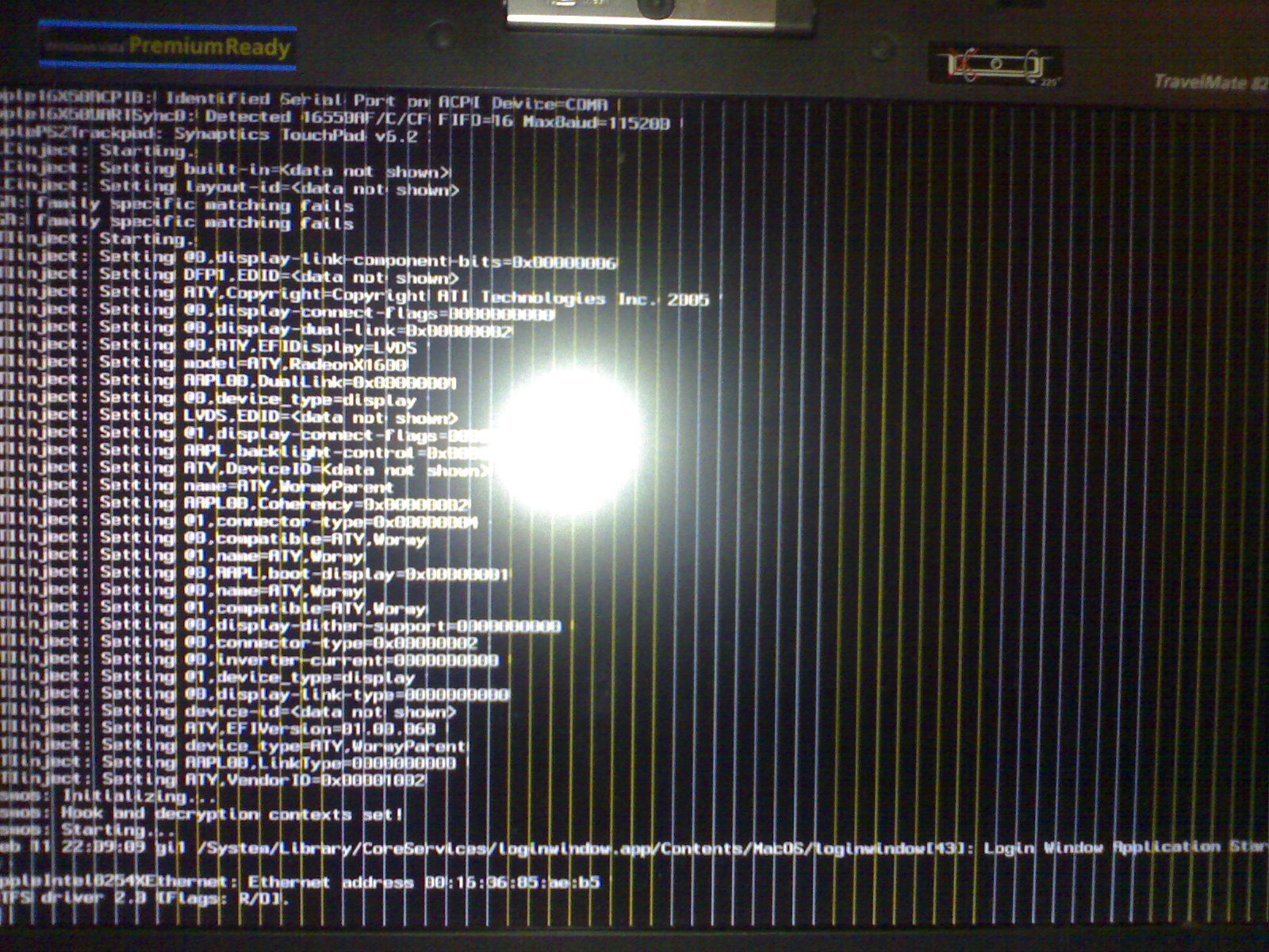

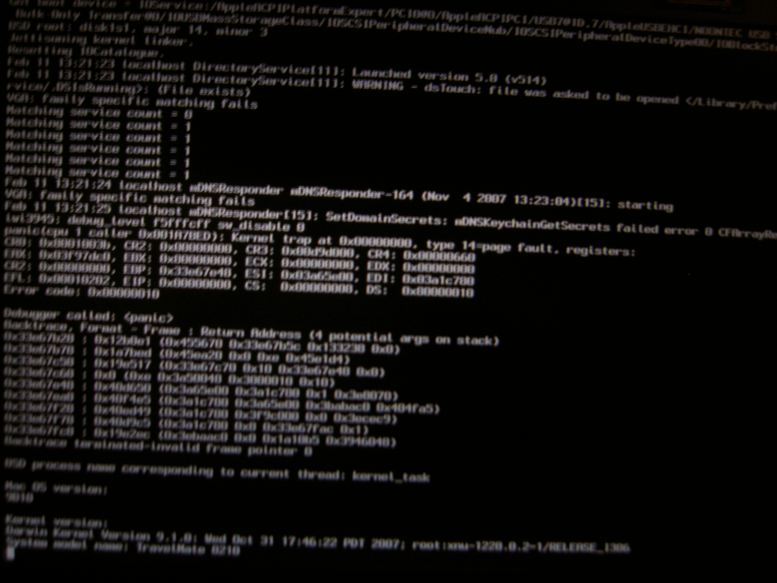

manw Posted February 11, 2008 Share Posted February 11, 2008 hey, i tried rev8, and just like the previous version, whenever i boot without the -f flag (!?) i get that grey multilingual thing telling me the computer needs to be turned off... Anyway of fixing this? or - at least a way to make it automatically start with the -f flag ? Thanks. Link to comment https://www.insanelymac.com/forum/topic/81036-cardbuspcmcia-pc-cards-for-leopard/page/16/#findComment-618144 Share on other sites More sharing options...
~Eureka Posted February 11, 2008 Author Share Posted February 11, 2008 hey, i tried rev8, and just like the previous version, whenever i boot without the -f flag (!?) i get that grey multilingual thing telling me the computer needs to be turned off...Anyway of fixing this? or - at least a way to make it automatically start with the -f flag ? Thanks. Hi manw, Try to boot with "-s" to enter singleuser mode. If you get the kernel panic under singleuser mode, take a picture of it if possible. If you don't get the kernel panic, please show me the full dmesg under singleuser mode. Thanks. Chun-Nan Link to comment https://www.insanelymac.com/forum/topic/81036-cardbuspcmcia-pc-cards-for-leopard/page/16/#findComment-618154 Share on other sites More sharing options...

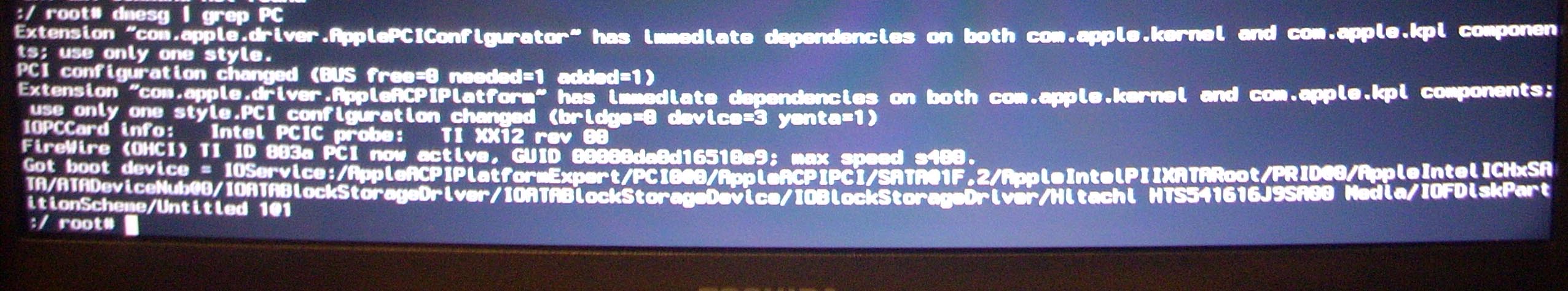

lele40 Posted February 11, 2008 Share Posted February 11, 2008 Hi Chun-Nan, Thanks for your incredibly fast reply. I'm coming with more informations. I booted system with IOPCIFamily ver.8 only: npvhash=4095 hi mem tramps at 0xffe00000 PAE enabled HPET enabled on your system enabling INTEL features Darwin Kernel Version 9.1.0: Fri Nov 16 14:50:43 SCT 2007; made by ToH:xnu-1228.0.2~1/BUILD/obj/RELEASE_I386 standard timeslicing quantum is 10000 us vm_page_bootstrap: 513733 free pages and 10555 wired pages mig_table_max_displ = 79 HTT: 2 cores per package; 2 logical cpus per package Extension "com.apple.driver.AppleACPIPlatform" has immediate dependencies on both com.apple.kernel and com.apple.kpi components; use only one style. ACPI CA 20060421 Extension "com.apple.driver.AppleIntelCPUPowerManagement" has immediate dependencies on both com.apple.kernel and com.apple.kpi components; use only one style. devfs_make_node: not ready for devices! AppleACPICPU: ProcessorApicId=0 LocalApicId=0 Enabled AppleACPICPU: ProcessorApicId=1 LocalApicId=1 Enabled Loading security extension com.apple.security.TMSafetyNet calling mpo_policy_init for TMSafetyNet Security policy loaded: Safety net for Time Machine (TMSafetyNet) Loading security extension com.apple.nke.applicationfirewall Loading security extension com.apple.security.seatbelt calling mpo_policy_init for mb Seatbelt MACF policy initialized Security policy loaded: Seatbelt Policy (mb) Copyright (c) 1982, 1986, 1989, 1991, 1993 The Regents of the University of California. All rights reserved. MAC Framework successfully initialized using 10485 buffer headers and 4096 cluster IO buffer headers IOAPIC: Version 0x20 Vectors 64:87 ACPI: System State [S0 S3 S4 S5] (S3) Extension "com.apple.driver.AppleACPIPlatform" has immediate dependencies on both com.apple.kernel and com.apple.kpi components; use only one style. Extension "com.apple.driver.ApplePCIConfigurator" has immediate dependencies on both com.apple.kernel and com.apple.kpi components; use only one style. Extension "com.apple.driver.AppleACPIPlatform" has immediate dependencies on both com.apple.kernel and com.apple.kpi components; use only one style. can't determine immediate dependencies for extension org.tgwbd.driver.ACPIPS2Nub Can't determine dependencies for org.tgwbd.driver.ACPIPS2Nub. mbinit: done Security auditing service present BSM auditing present Extension "com.apple.driver.AppleACPIPlatform" has immediate dependencies on both com.apple.kernel and com.apple.kpi components; use only one style. PCI configuration changed (BUS free=0 needed=1 added=1) PCI configuration changed (bridge=0 device=4 yenta=1) From path: "uuid", Waiting for boot volume with UUID 1F5A630C-103A-3524-8E8D-DD5A3553B8A2 Waiting on <dict ID="0"><key>IOProviderClass</key><string ID="1">IOResources</string><key>IOResourceMatch</key><string ID="2">boot-uuid-media</string></dict> Debug driver registered: AppleUSBUHCI FireWire (OHCI) TI ID 803a PCI now active, GUID 00080da0d1541344; max speed s400. Extension "com.apple.iokit.IOBluetoothFamily" has immediate dependencies on both com.apple.kernel and com.apple.kpi components; use only one style. E:[AppleUSBBluetoothHCIController][FindInterfaces] mInt0InterruptMaxPacketSize = 16 Got boot device = IOService:/AppleACPIPlatformExpert/PCI0@0/AppleACPIPCI/SATA@1F,2/AppleIntelPIIXATARoot/PRID@0/AppleIntelICHxSATA/ATADeviceNub@0/IOATABlockStorageDriver/IOATABlockStorageDevice/IOBlockStorageDriver/HTS541010G9SA00 Media/IOFDiskPartitionScheme/Untitled 1@1 BSD root: disk0s1, major 14, minor 1 jnl: unknown-dev: replay_journal: from: 6297088 to: 7319040 (joffset 0x2ec000) jnl: unknown-dev: journal replay done. ERROR: FireWire unable to determine security-mode; defaulting to full-secure. HFS: Removed 1 orphaned unlinked files or directories Then here is dmesg when i kextload manually IOPCCardFamily.kext: ... IOPCCard info: Intel PCIC probe: TI XX12 rev 00 ... Then, when I insert the wifi card, in dmesg appears: Feb 11 18:08:38 leopard airportd[91]: Error: ACInterfaceGetPowerPreference() failed and system freezes for 5 seconds, then reboots. If I automatically load IOPCCardFamily at boot but without any pccard inserted, the dmesg is this: npvhash=4095 hi mem tramps at 0xffe00000 PAE enabled HPET enabled on your system enabling INTEL features Darwin Kernel Version 9.1.0: Fri Nov 16 14:50:43 SCT 2007; made by ToH:xnu-1228.0.2~1/BUILD/obj/RELEASE_I386 standard timeslicing quantum is 10000 us vm_page_bootstrap: 510781 free pages and 13507 wired pages mig_table_max_displ = 79 HTT: 2 cores per package; 2 logical cpus per package Skipping duplicate extension "com.apple.driver.AppleIntel8255x" with older/same version (1.4 -> 1.4). Extension "com.apple.driver.AppleACPIPlatform" has immediate dependencies on both com.apple.kernel and com.apple.kpi components; use only one style. ACPI CA 20060421 Extension "com.apple.driver.AppleIntelCPUPowerManagement" has immediate dependencies on both com.apple.kernel and com.apple.kpi components; use only one style. devfs_make_node: not ready for devices! AppleACPICPU: ProcessorApicId=0 LocalApicId=0 Enabled AppleACPICPU: ProcessorApicId=1 LocalApicId=1 Enabled Loading security extension com.apple.nke.applicationfirewall Loading security extension com.apple.security.seatbelt calling mpo_policy_init for mb Seatbelt MACF policy initialized Security policy loaded: Seatbelt Policy (mb) Loading security extension com.apple.security.TMSafetyNet calling mpo_policy_init for TMSafetyNet Security policy loaded: Safety net for Time Machine (TMSafetyNet) Copyright (c) 1982, 1986, 1989, 1991, 1993 The Regents of the University of California. All rights reserved. MAC Framework successfully initialized using 10485 buffer headers and 4096 cluster IO buffer headers IOAPIC: Version 0x20 Vectors 64:87 ACPI: System State [S0 S3 S4 S5] (S3) Extension "com.apple.driver.AppleACPIPlatform" has immediate dependencies on both com.apple.kernel and com.apple.kpi components; use only one style. Extension "com.apple.driver.ApplePCIConfigurator" has immediate dependencies on both com.apple.kernel and com.apple.kpi components; use only one style. Extension "com.apple.driver.AppleACPIPlatform" has immediate dependencies on both com.apple.kernel and com.apple.kpi components; use only one style. can't determine immediate dependencies for extension org.tgwbd.driver.ACPIPS2Nub Can't determine dependencies for org.tgwbd.driver.ACPIPS2Nub. Extension "com.apple.driver.AppleACPIPlatform" has immediate dependencies on both com.apple.kernel and com.apple.kpi components; use only one style.mbinit: done Security auditing service present BSM auditing present PCI configuration changed (BUS free=0 needed=1 added=1) PCI configuration changed (bridge=0 device=4 yenta=1) From path: "uuid", Waiting for boot volume with UUID 1F5A630C-103A-3524-8E8D-DD5A3553B8A2 Waiting on <dict ID="0"><key>IOProviderClass</key><string ID="1">IOResources</string><key>IOResourceMatch</key><string ID="2">boot-uuid-media</string></dict> Debug driver registered: AppleUSBUHCI IOPCCard info: Intel PCIC probe: TI XX12 rev 00 FireWire (OHCI) TI ID 803a PCI now active, GUID 00080da0d1541344; max speed s400. Extension "com.apple.iokit.IOBluetoothFamily" has immediate dependencies on both com.apple.kernel and com.apple.kpi components; use only one style. Got boot device = IOService:/AppleACPIPlatformExpert/PCI0@0/AppleACPIPCI/SATA@1F,2/AppleIntelPIIXATARoot/PRID@0/AppleIntelICHxSATA/ATADeviceNub@0/IOATABlockStorageDriver/IOATABlockStorageDevice/IOBlockStorageDriver/HTS541010G9SA00 Media/IOFDiskPartitionScheme/Untitled 1@1E:[AppleUSBBluetoothHCIController][FindInterfaces] mInt0InterruptMaxPacketSize = 16 BSD root: disk0s1, major 14, minor 1 ERROR: FireWire unable to determine security-mode; defaulting to full-secure. And this dmesg when booting with pccard inserted: npvhash=4095 hi mem tramps at 0xffe00000 PAE enabled HPET enabled on your system enabling INTEL features Darwin Kernel Version 9.1.0: Fri Nov 16 14:50:43 SCT 2007; made by ToH:xnu-1228.0.2~1/BUILD/obj/RELEASE_I386 standard timeslicing quantum is 10000 us vm_page_bootstrap: 510781 free pages and 13507 wired pages mig_table_max_displ = 79 HTT: 2 cores per package; 2 logical cpus per package Skipping duplicate extension "com.apple.driver.AppleIntel8255x" with older/same version (1.4 -> 1.4). Extension "com.apple.driver.AppleACPIPlatform" has immediate dependencies on both com.apple.kernel and com.apple.kpi components; use only one style. ACPI CA 20060421 Extension "com.apple.driver.AppleIntelCPUPowerManagement" has immediate dependencies on both com.apple.kernel and com.apple.kpi components; use only one style. devfs_make_node: not ready for devices! AppleACPICPU: ProcessorApicId=0 LocalApicId=0 Enabled AppleACPICPU: ProcessorApicId=1 LocalApicId=1 Enabled Loading security extension com.apple.nke.applicationfirewall Loading security extension com.apple.security.seatbelt calling mpo_policy_init for mb Seatbelt MACF policy initialized Security policy loaded: Seatbelt Policy (mb) Loading security extension com.apple.security.TMSafetyNet calling mpo_policy_init for TMSafetyNet Security policy loaded: Safety net for Time Machine (TMSafetyNet) Copyright (c) 1982, 1986, 1989, 1991, 1993 The Regents of the University of California. All rights reserved. MAC Framework successfully initialized using 10485 buffer headers and 4096 cluster IO buffer headers IOAPIC: Version 0x20 Vectors 64:87 ACPI: System State [S0 S3 S4 S5] (S3) Extension "com.apple.driver.AppleACPIPlatform" has immediate dependencies on both com.apple.kernel and com.apple.kpi components; use only one style. Extension "com.apple.driver.ApplePCIConfigurator" has immediate dependencies on both com.apple.kernel and com.apple.kpi components; use only one style. Extension "com.apple.driver.AppleACPIPlatform" has immediate dependencies on both com.apple.kernel and com.apple.kpi components; use only one style. can't determine immediate dependencies for extension org.tgwbd.driver.ACPIPS2Nub Can't determine dependencies for org.tgwbd.driver.ACPIPS2Nub. Extension "com.apple.driver.AppleACPIPlatform" has immediate dependencies on both com.apple.kernel and com.apple.kpi components; use only one style.mbinit: done Security auditing service present BSM auditing present PCI configuration changed (BUS free=0 needed=1 added=1) PCI configuration changed (bridge=0 device=4 yenta=1) From path: "uuid", Waiting for boot volume with UUID 1F5A630C-103A-3524-8E8D-DD5A3553B8A2 Waiting on <dict ID="0"><key>IOProviderClass</key><string ID="1">IOResources</string><key>IOResourceMatch</key><string ID="2">boot-uuid-media</string></dict> Debug driver registered: AppleUSBUHCI IOPCCard info: Intel PCIC probe: TI XX12 rev 00 FireWire (OHCI) TI ID 803a PCI now active, GUID 00080da0d1541344; max speed s400. IOPCCard info: cs: cb_alloc(bus 8): vendor 0x168c, device 0x0013 IOPCCard info: cs: cb_alloc(bus 8): found 1 functions IOCardBusDevice: binding socket 0 function 0 to card services. IOPCCard info: cs: cb_config(bus 8) IOPCCard info: fn 0 bar 1: mem 0xa0010000-0xa001ffff IOPCCard info: irq 18 Got boot device = IOService:/AppleACPIPlatformExpert/PCI0@0/AppleACPIPCI/SATA@1F,2/AppleIntelPIIXATARoot/PRID@0/AppleIntelICHxSATA/ATADeviceNub@0/IOATABlockStorageDriver/IOATABlockStorageDevice/IOBlockStorageDriver/HTS541010G9SA00 Media/IOFDiskPartitionScheme/Untitled 1@1Extension "com.apple.iokit.IOBluetoothFamily" has immediate dependencies on both com.apple.kernel and com.apple.kpi components; use only one style. BSD root: disk0s1, major 14, minor 1 E:[AppleUSBBluetoothHCIController][FindInterfaces] mInt0InterruptMaxPacketSize = 16 ERROR: FireWire unable to determine security-mode; defaulting to full-secure. Thank you. Link to comment https://www.insanelymac.com/forum/topic/81036-cardbuspcmcia-pc-cards-for-leopard/page/16/#findComment-618250 Share on other sites More sharing options...

~Eureka Posted February 11, 2008 Author Share Posted February 11, 2008 Hi Chun-Nan, Thanks for your incredibly fast reply. I'm coming with more informations. I booted system with IOPCIFamily ver.8 only: .......... Then here is dmesg when i kextload manually IOPCCardFamily.kext: ... IOPCCard info: Intel PCIC probe: TI XX12 rev 00 ... Then, when I insert the wifi card, in dmesg appears: Feb 11 18:08:38 leopard airportd[91]: Error: ACInterfaceGetPowerPreference() failed and system freezes for 5 seconds, then reboots. If I automatically load IOPCCardFamily at boot but without any pccard inserted, the dmesg is this: .......... And this dmesg when booting with pccard inserted: .......... Thank you. Hi lele40, Thanks for the information. According to the demsg, your pccard controller seems to be activated. I think you are using the wireless PC Cards. If you do, what wifi card are you using now (vender id and product id)? What driver for the wireless device are you using now? If possible, can you let me know what extra kexts you are using are not from Leopard originally? Thanks. Chun-Nan ===================== Hi snam11, Here is another test.only4 IOPCIFamily. Try it and let me know the dmesg result under singleuser mode. If kernel panic happens, show me the picture if possible or let me know where it stops. Thanks a lot. Again, don't forget to backup your original files while trying it. Chun-Nan IOPCIFamily.test.only4.zip Link to comment https://www.insanelymac.com/forum/topic/81036-cardbuspcmcia-pc-cards-for-leopard/page/16/#findComment-618703 Share on other sites More sharing options...
lele40 Posted February 12, 2008 Share Posted February 12, 2008 Hi lele40, Thanks for the information. According to the demsg, your pccard controller seems to be activated. I think you are using the wireless PC Cards. If you do, what wifi card are you using now (vender id and product id)? What driver for the wireless device are you using now? If possible, can you let me know what extra kexts you are using are not from Leopard originally? Thanks. Chun-Nan ===================== Hi snam11, Here is another test.only4 IOPCIFamily. Try it and let me know the dmesg result under singleuser mode. If kernel panic happens, show me the picture if possible or let me know where it stops. Thanks a lot. Again, don't forget to backup your original files while trying it. Chun-Nan IOPCIFamily.test.only4.zip Hi Chun-Nan, I tried the IOPCIFamily test file you sent me. Here is the dmesg log. If I try to load IOPCCardFamily from rev.8 with this test file, it gives me error: "IOPCCardBridge::checkBridgeBusIDs invalid sub/cardbus/pci settings 0x0". Mi wi-fi card is a D-Link DWL-G650 whit Atheros 5212 Chipset, id pci168c,13. Thank you Chun-Nan, your're doing a great job and thanks for wasting you're time with us. Lele40 test4.zip Link to comment https://www.insanelymac.com/forum/topic/81036-cardbuspcmcia-pc-cards-for-leopard/page/16/#findComment-619448 Share on other sites More sharing options...

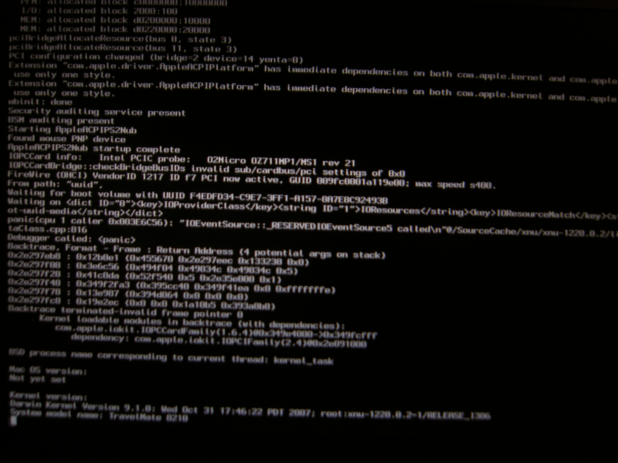

~Eureka Posted February 12, 2008 Author Share Posted February 12, 2008 Hi Chun-Nan, I tried the IOPCIFamily test file you sent me. Here is the dmesg log. If I try to load IOPCCardFamily from rev.8 with this test file, it gives me error: "IOPCCardBridge::checkBridgeBusIDs invalid sub/cardbus/pci settings 0x0". Mi wi-fi card is a D-Link DWL-G650 whit Atheros 5212 Chipset, id pci168c,13. Thank you Chun-Nan, your're doing a great job and thanks for wasting you're time with us. Lele40 Hi Lele40, If possible, can you go to Post #364 , download the IOPCIFamily.info.only, load it, and show me the dmesg? I need some information from it. Thanks. Chun-Nan Link to comment https://www.insanelymac.com/forum/topic/81036-cardbuspcmcia-pc-cards-for-leopard/page/16/#findComment-620226 Share on other sites More sharing options...
manw Posted February 12, 2008 Share Posted February 12, 2008 Hi manw, Try to boot with "-s" to enter singleuser mode. If you get the kernel panic under singleuser mode, take a picture of it if possible. If you don't get the kernel panic, please show me the full dmesg under singleuser mode. Thanks. Chun-Nan Hi Chun-Nan, here it is. Apparently, when booting in singleuser mode, no hang...Anyway, the problem seems to have passed once i installed the 10.4.5 io80211family.kext, and the 10.4.3 IOnetworkingFamily (trying in the same time to make my AR5001 wifi card work, with no success so far); once i put back the 10.5.1 kexts, the hang kicks back on the loading screen, if no switch (-f, and now -s) is used. P.S. - sorry for the late reply. Link to comment https://www.insanelymac.com/forum/topic/81036-cardbuspcmcia-pc-cards-for-leopard/page/16/#findComment-620282 Share on other sites More sharing options...

~Eureka Posted February 12, 2008 Author Share Posted February 12, 2008 Hi snam11, Here is another test.only5 IOPCIFamily. Try it and let me know the dmesg result under singleuser mode. If kernel panic happens, show me the picture if possible or let me know where it stops. Thanks a lot. Again, don't forget to backup your original files while trying it. Chun-Nan IOPCIFamily.test.only5.zip Link to comment https://www.insanelymac.com/forum/topic/81036-cardbuspcmcia-pc-cards-for-leopard/page/16/#findComment-620403 Share on other sites More sharing options...
