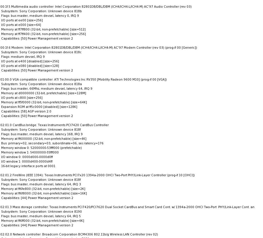

applehacker Posted March 7, 2008 Share Posted March 7, 2008 Hey, Ive got an update. I installed that kext. I ran the command, and it scanned, nothing bout a Tixx12, but it say 3 things about 3 different pci ports. does this mean this laptop has pci ports I can use!!?!?! Link to comment https://www.insanelymac.com/forum/topic/81036-cardbuspcmcia-pc-cards-for-leopard/page/21/#findComment-657348 Share on other sites More sharing options...
~Eureka Posted March 8, 2008 Author Share Posted March 8, 2008 I don't know if the new added devices will work or not. However, you can give it a try and let me know the result. In addition, if your pccard slot works under linux and it is not listed on the above the list (and if you believe it may work under mac), let me know the device id and I will try to add it to the next revision. hi Chun-Nan Would first like to offer my thanks for all your investment of time and effort. Believe this might be a new device for you to add, TI7420 built-in chip on my Sony Vaio VGN-A series laptop and also on many other Sony's ie. FS FE FJ series. Noticed in the device id capture below that it is linked in with flash mermory - a bit different. Reports in windows device manager as TI17420 Integrated FlashMedia Controller. It is recognised and useable under Linux. ..... If you need furture info please PM me. Thanks again. Hi shemozzle, I've been busy with school recently. I will try to add your pccard controller to the list this weekend. Thanks. Chun-Nan Hey, Ive got an update. I installed that kext. I ran the command, and it scanned, nothing bout a Tixx12, but it say 3 things about 3 different pci ports. does this mean this laptop has pci ports I can use!!?!?! Hi applehacker, Can you show the demsg result under singleuser mode (or standard mode)? Thanks. Chun-Nan Link to comment https://www.insanelymac.com/forum/topic/81036-cardbuspcmcia-pc-cards-for-leopard/page/21/#findComment-658528 Share on other sites More sharing options...
