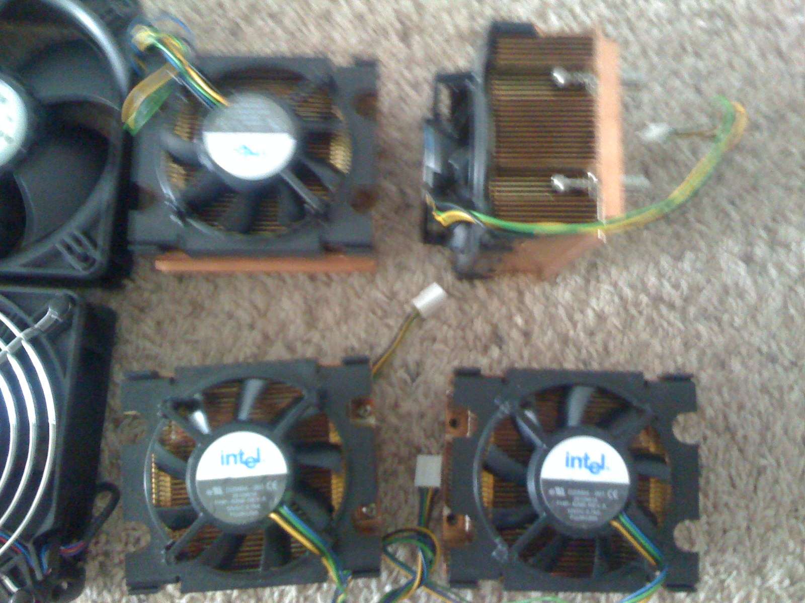

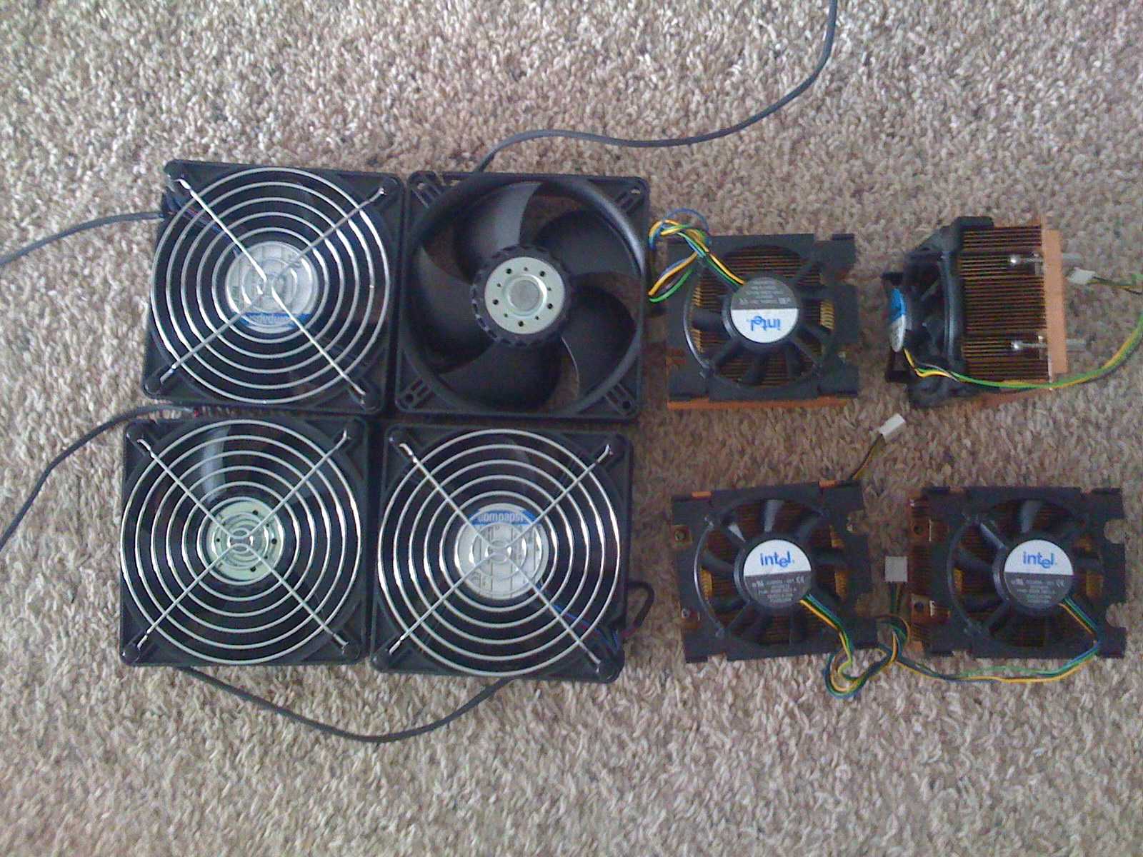

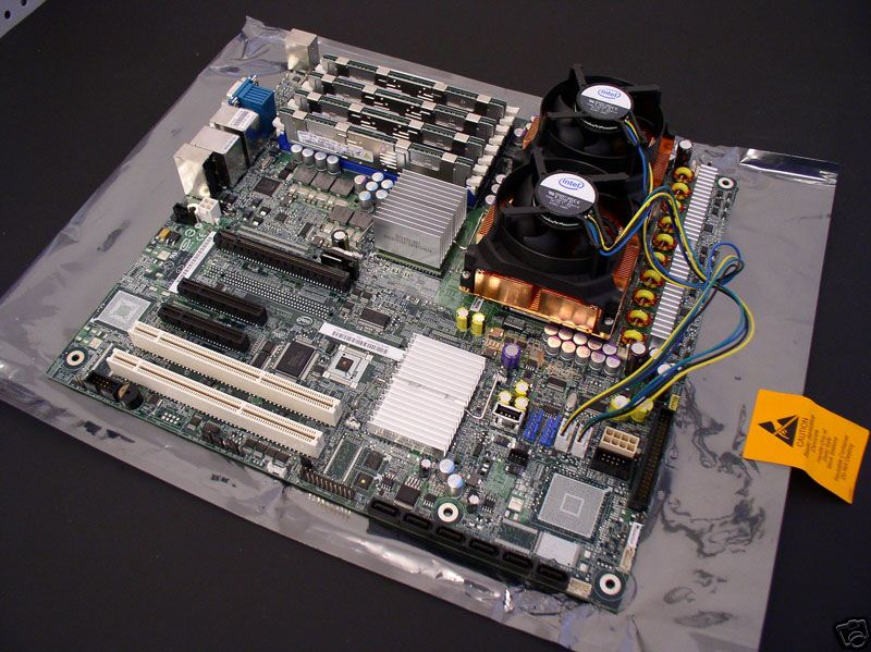

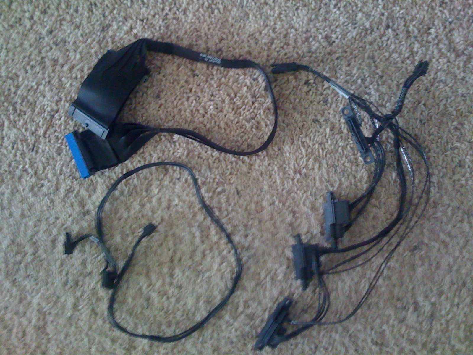

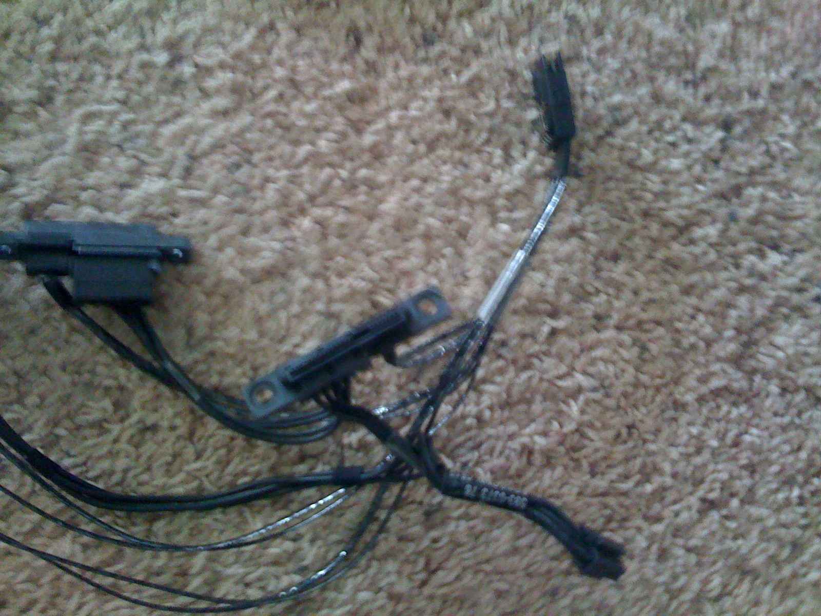

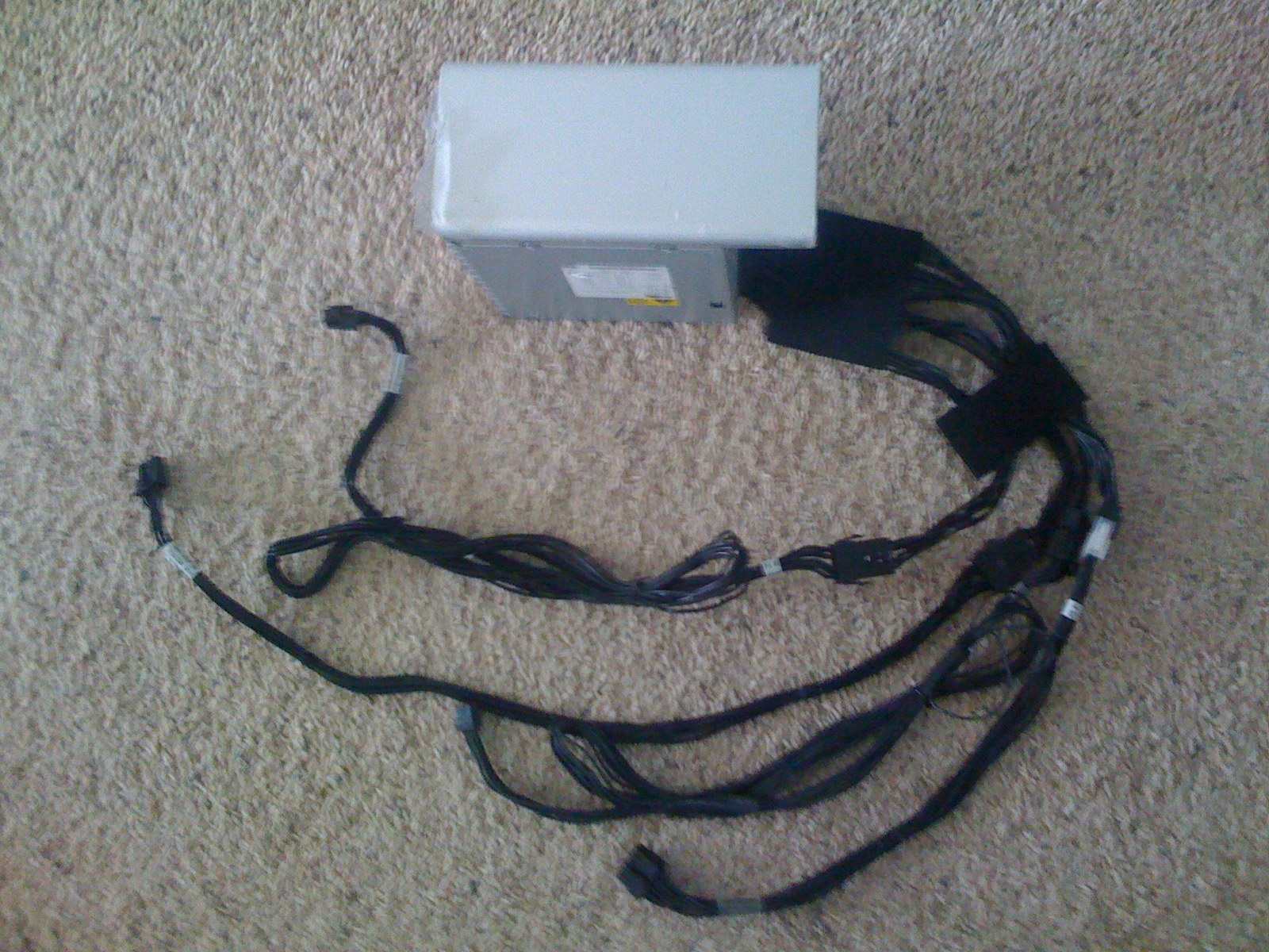

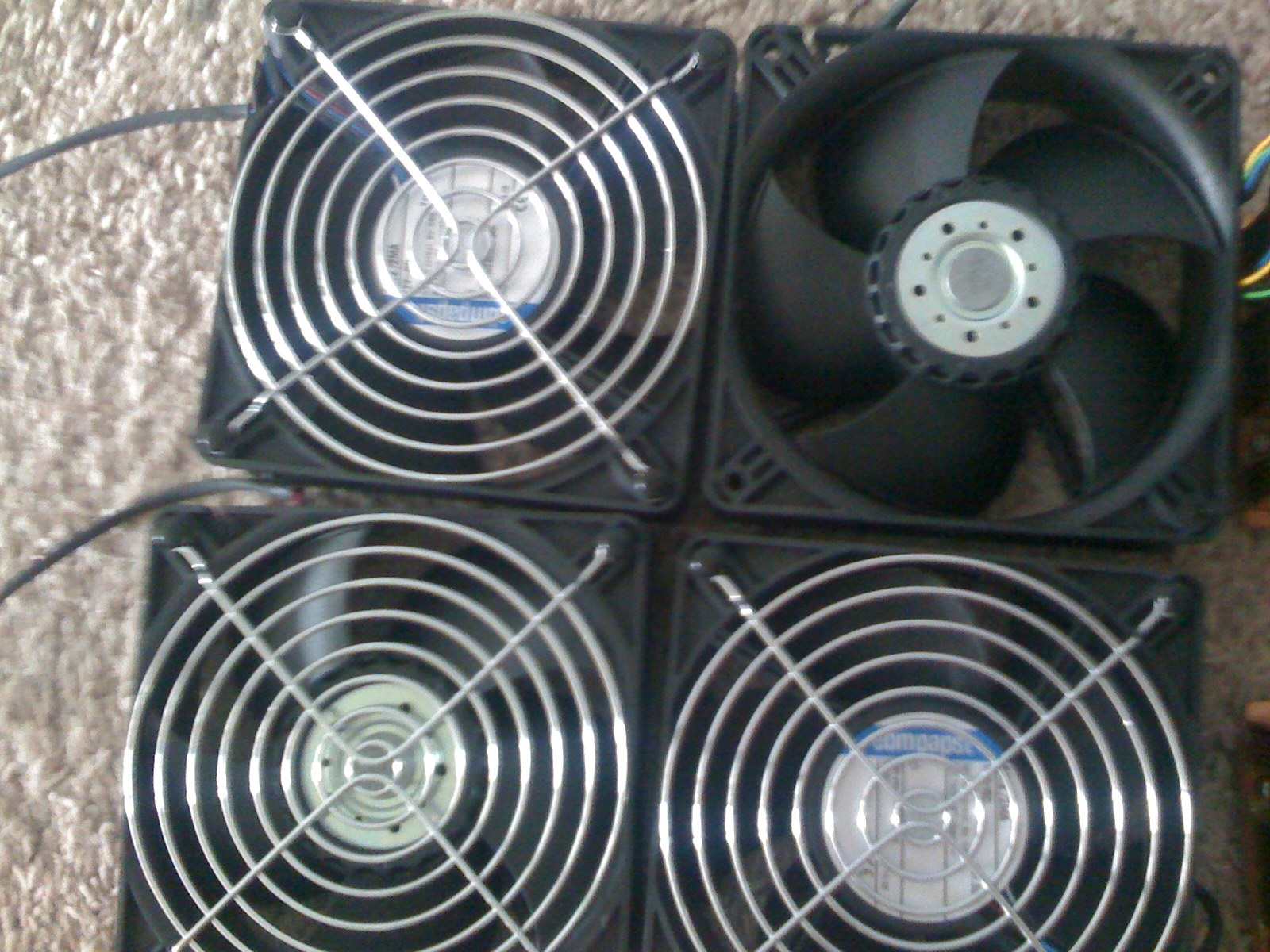

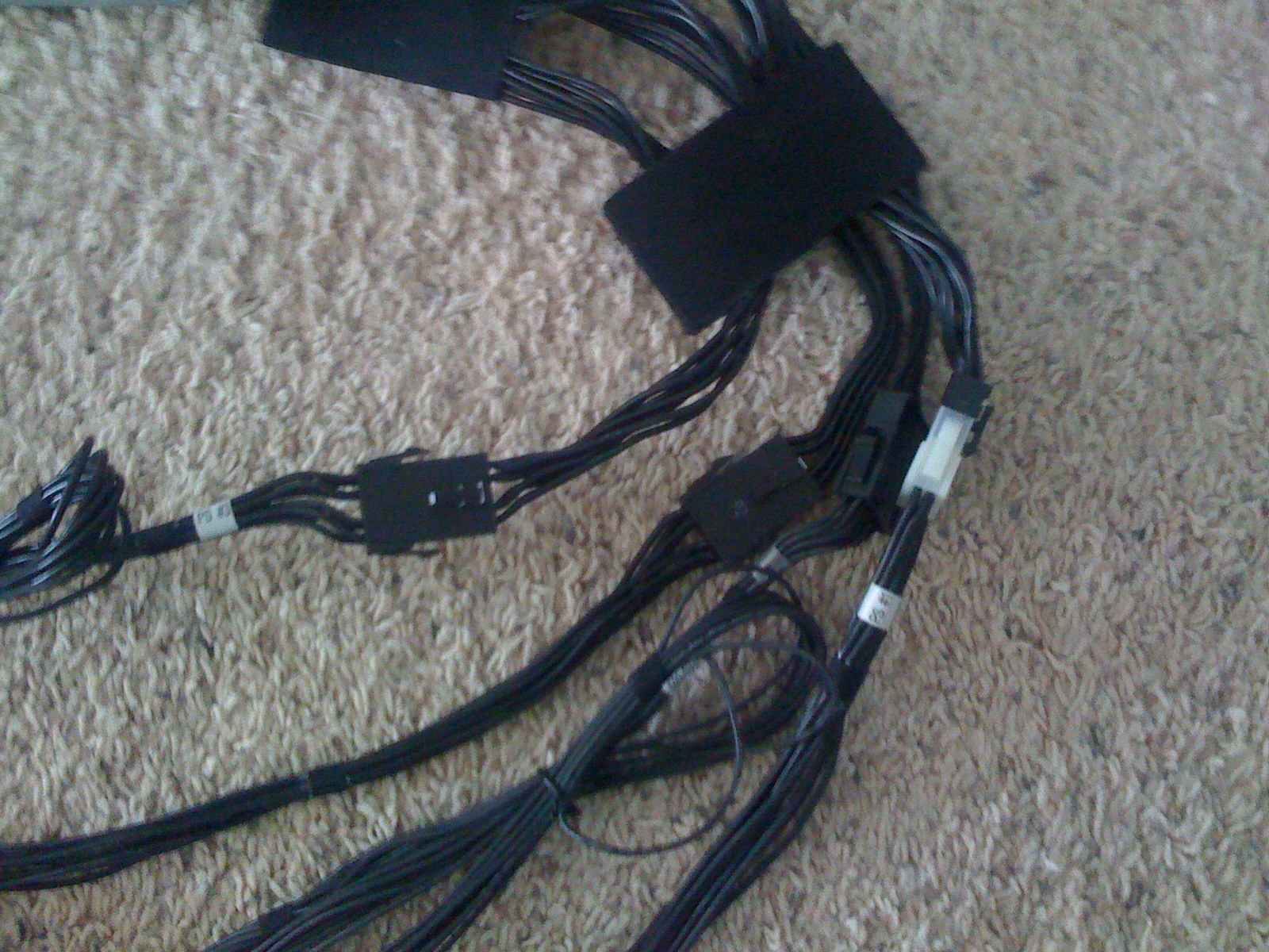

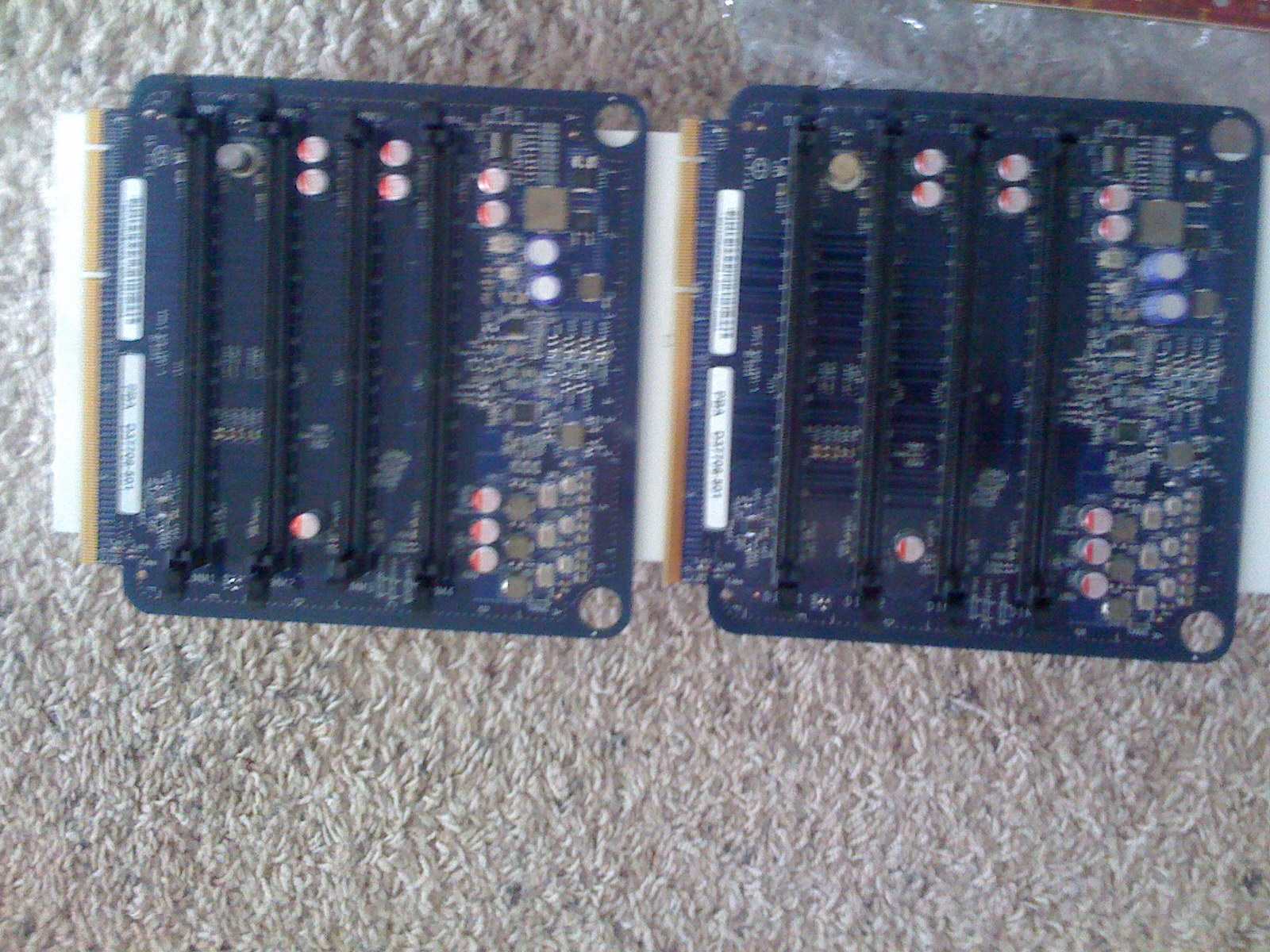

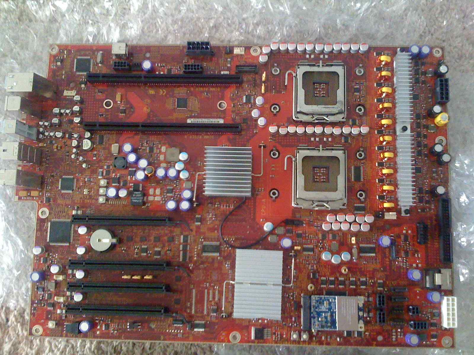

Okay, here's the photos of the stuff I've got in excess!
Items list:
1) PSU with Logic Board Cables, HDD SATA/Power Cables, Optical Drive Data and Power Cables, Front dual Case Fan power connector(NP)
2)Power Supply Cables
3) Optical Data Cable
4) Optical Power Cables
5) Front dual Case Fan power connector (not pictured)
6) Case Fans (4-pin) (5 avail)
7) CPU Fan/Heatsink (6 avail)
8) Memory Card Risers - Consumer release (2 avail)
9) Memory Card Risers - Prototype (2 Avail, not pictured)
10) Prototype Logic Board 1,1

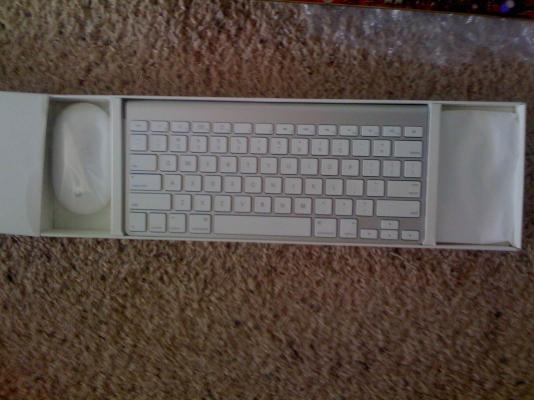

11) NEW Wireless KB
12) NEW Wireless Mighty Mouse
13) CPU Thermal sensors , ready to plug in (Home Made, royalties paid to Nagal!)(Not Pictured)
Too much stuff! I ended up with several prototype boards, and I've don't all I can handle, now it's time to build a 16 core Mac Pro! Have you seen the new prototype logic boards? Just kidding...
I'm just not gonna build any more prototype systems, so I figure I'd see who might like!
Oh, and I have to have a 10 key, so that's why the keyboard and mouse.... No if someone could adapt the new slim full keyboard and make it bluetooth, then we'd be talking!
