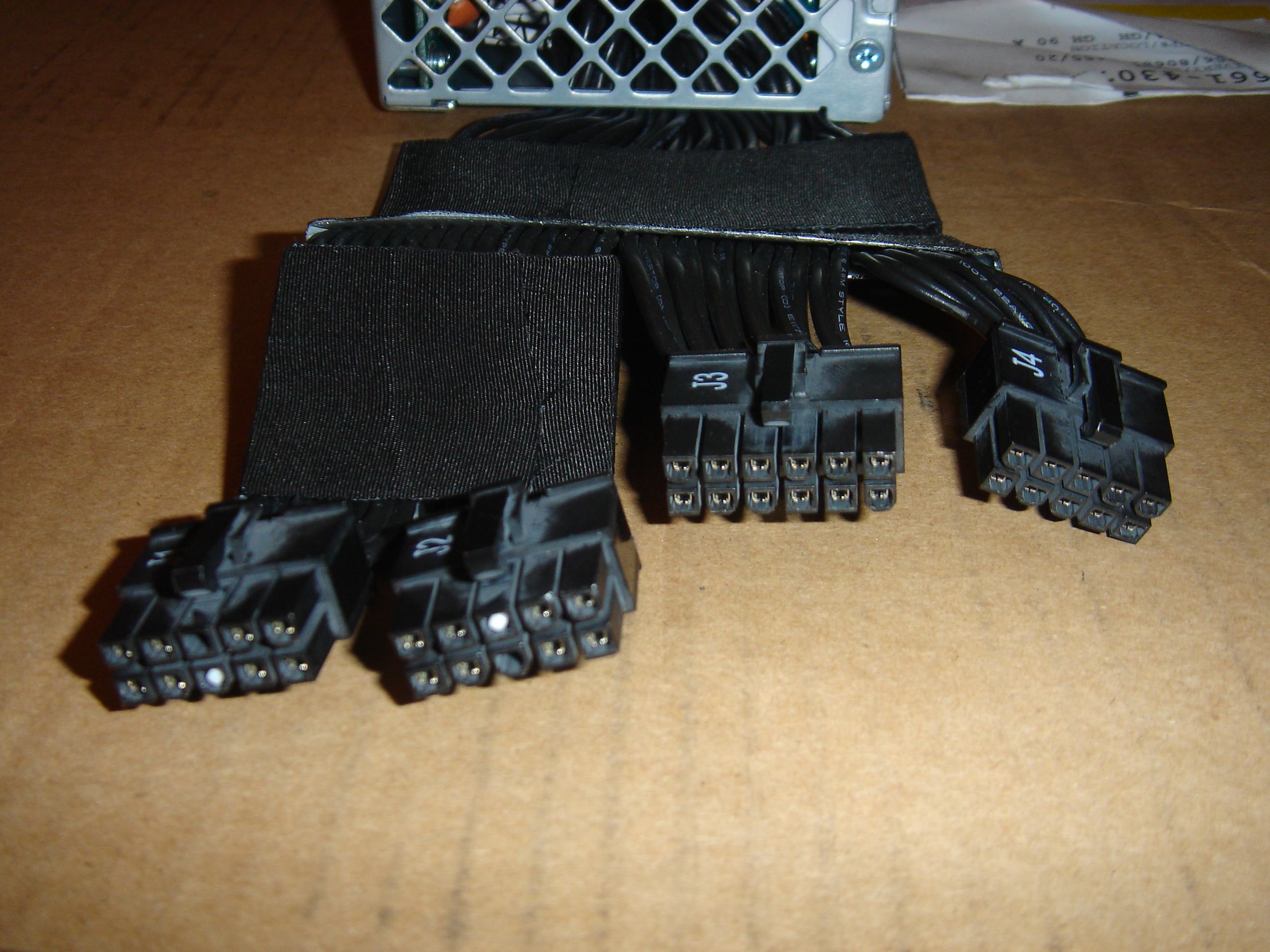

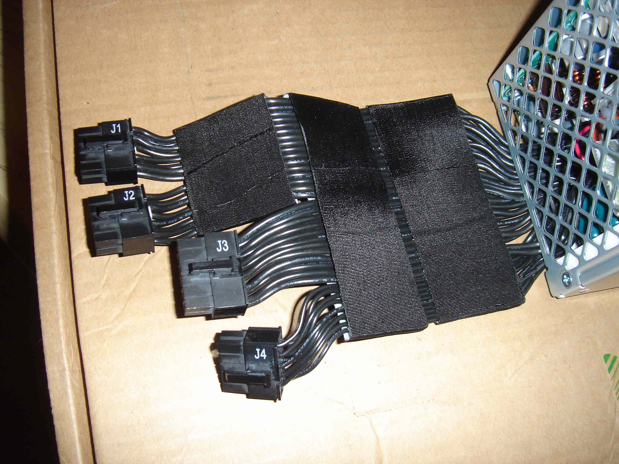

Yes, the cabling is basically just a bunch of extensions. Make sense as it allows the power supply to be easily removed. It would be an utter pain to have to remove the PSU if all the wiring actually ran down into the case.

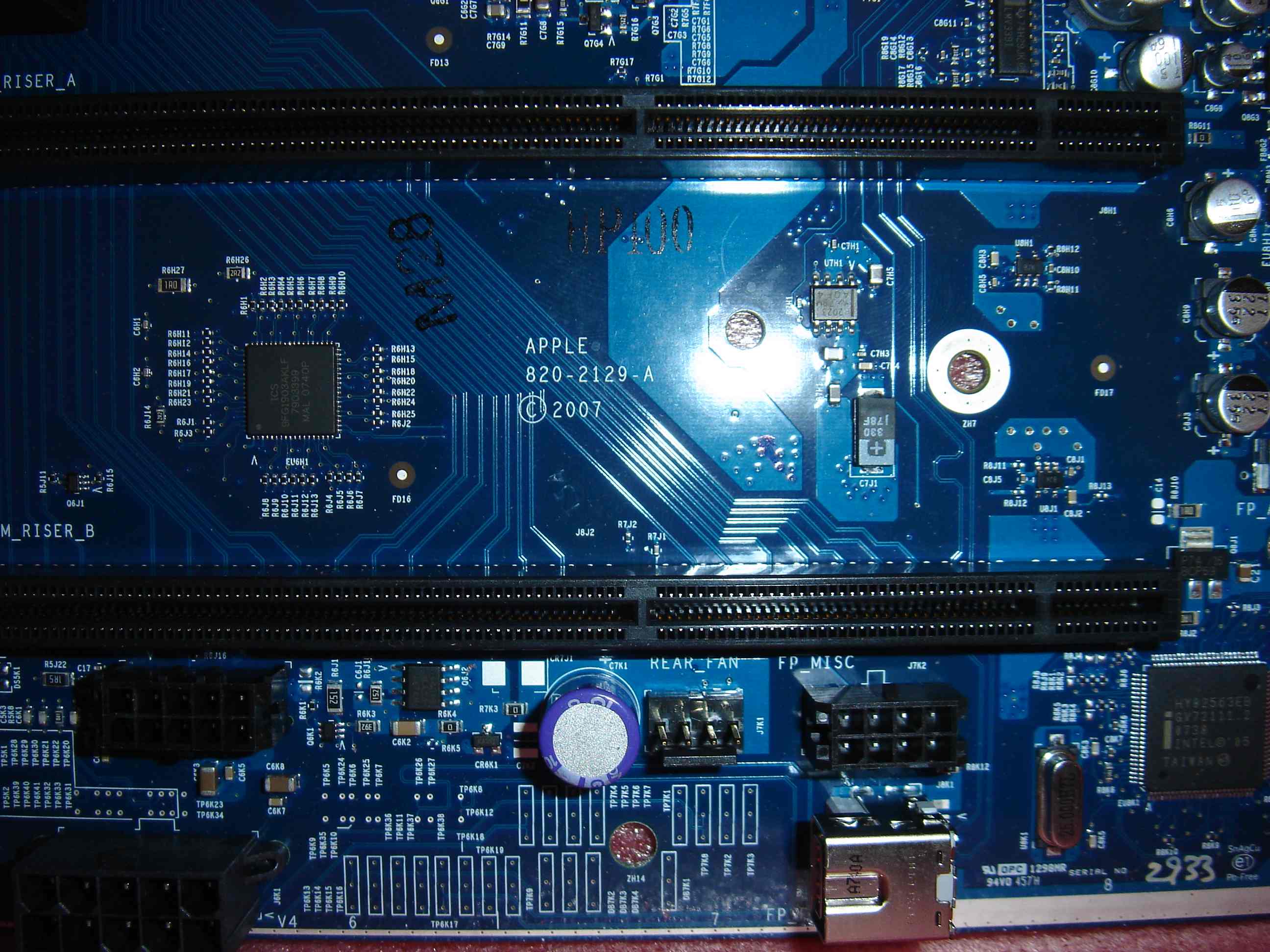

I do not think you can just splice into the the PSU wiring to extend it. I know the one connector for the unlabeled plug by the memory risers is vastly different in size and pin density than the actually connector on the PSU. I did not bother to check the other connectors but they did seem to be of similar size as the logic board connectors.

Yes, the cabling is basically just a bunch of extensions. Make sense as it allows the power supply to be easily removed. It would be an utter pain to have to remove the PSU if all the wiring actually ran down into the case.I do not think you can just splice into the the PSU wiring to extend it. I know the one connector for the unlabeled plug by the memory risers is vastly different in size and pin density than the actually connector on the PSU. I did not bother to check the other connectors but they did seem to be of similar size as the logic board connectors.If I had a Mouser catalog (printed), I am sure I could find out what connectors are being used. I know wish I had not thrown mine away when I moved.

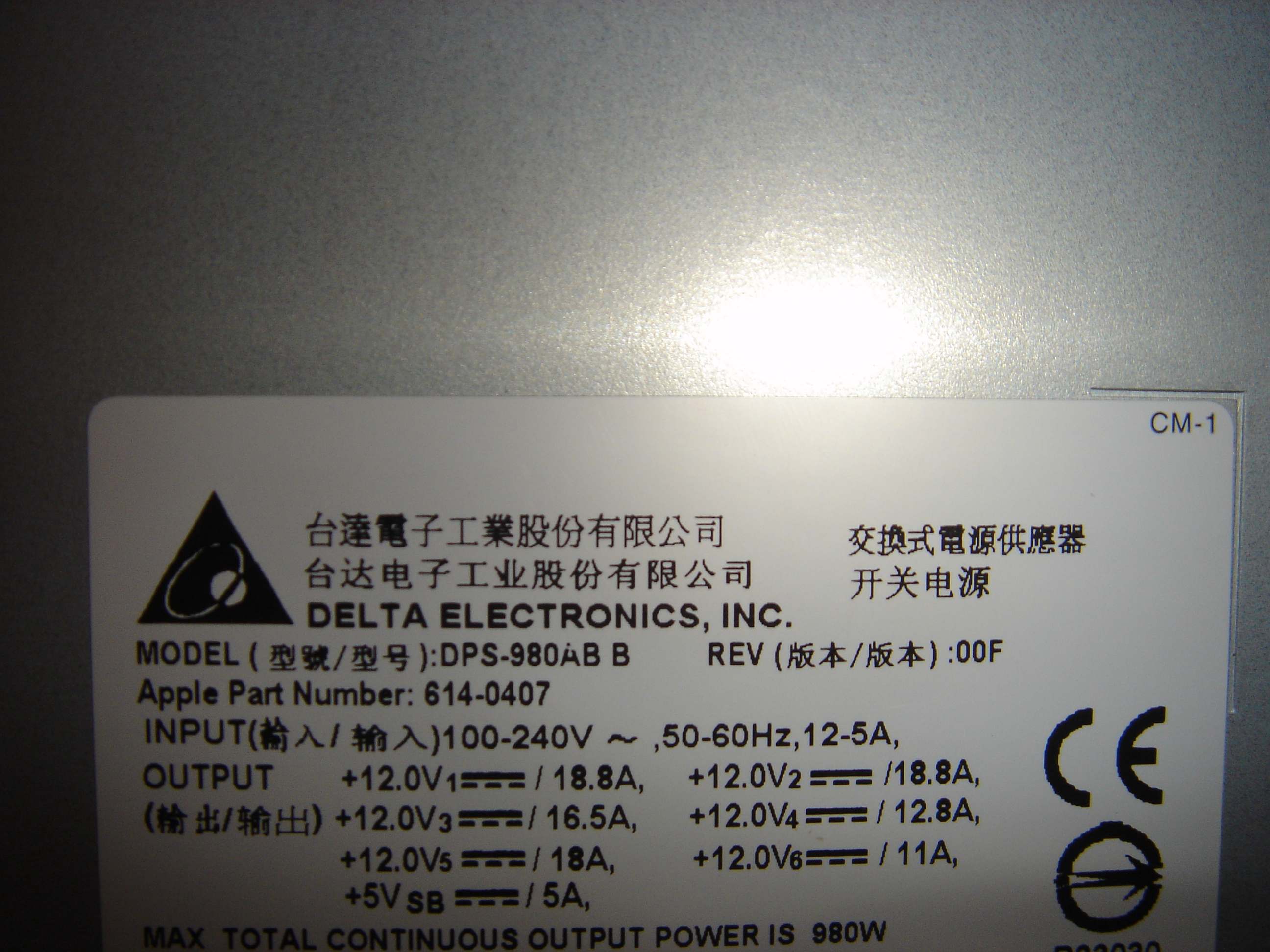

Nagal, my power supply that I got from applepalace is box labeled as #667-4309
Does this match yours?

MLB:
Looks just like my PSU and I sure hope so because that is the same part number I ordered. Not sure why you posted the pic of the connectors near the memory raiser slots but that looks just like mine as well.
Just wanted to confirm that we received the same power supply.. the MLB was to show that it's a 2007 model... Also it's for on lookers who are interested... One thing about the mac pro is that I haven't been able to find really detailed "close up" photos of it's components; I want to start a photo gallery.

nagal awesome work!!! You're the man!!! A little confusion, in essence the four bundles of cables are just extenders from the power supply's connectors to the logic board receptacles; for example pin # 1's wire from the power supply will correspond to pin one of the receiving MLB receptacle, as if it was directly plugged into the logic board without the bundle extender. I was thinking of saving 200 bucks by extending the power supply leads by splicing longer wires in between the PS and the immediate connector; applepalace rapes on frickin simple 12 and 10 conductor molex connectors and wires; $49-54 per bundle... OHHHH Please... $2 for a pair of those molex connectors and wire is practically nothing; I think I'll make those bundles and sell them for cost and shipping... I hate consumer raping!!!! I'm really happy that there is so much interest in building genuine mac pros... I've been reading very encouraging entries and admire the ambition. I'm half-way complete with parts purchases, and ultimately strive to show that it's possible to assemble a fully functional mac-pro (not a hackpro but custom) that undercuts a retail model ($3033.00 after taxes) of equivalent specs for $1000-$1200 less. If you own a mac-pro, and aren't intimidated by looking inside your tower, please help in the quest for knowledge by posting closeup photos, descriptions; if possible simple circuit reverse engineering with a multimeter ( Like Nagal's great reference on the Power Supply) to simplify a circuit i.e front panel board... I'll do my best to do same but I'm trying to limit my purchases to essential mac components necessary to get the computer to function. My contributions will be based on substitutable components. Thanks everyone!
My Mac Logic Board ver 2 (MacPro 2,1) Octo dates 2007... # 667-4307

..and is that an internal firewire 800 port i see at the bottom rightish of your motherboard picture?
there is a cable that runs from that port to the front panel assembly and I have always assumed it was a simple firewire 800 cable and that is how they connect the front panel firewire ports to logic board.
The FireWire PHY is near that port and the rear ports, all ( 400/800 ) on the same bus.

I had a thought. Have you tried plugging the power supply connectors directly into the logic board? If everything lines up (except for the one connector which I know is too big), then you can reuse those connector just by extending/rewiring as need. Then you would only have that one connector to hunt down.

Hey Nagal. Yeah the four bundles attach, that was my first game plan of splicing the PS leads to elongate them. That medium receptacle shouldn't be hard to track down... Hardest part be will to nicely crimp the inserts; gonna go it with my trusty electricians lineman. I will eventually make my own convertor cables to make any high powered PS mac-pro compatible; Just need the beast up so I can reverse engineer the power supply... I hate waiting for the parts!!! Do you have any Molex connectors at work that you can reference to help in the hunt down process. Tons of molex on mouser; I can guesstimate by measuring but don't want to waste time with trial and error.
