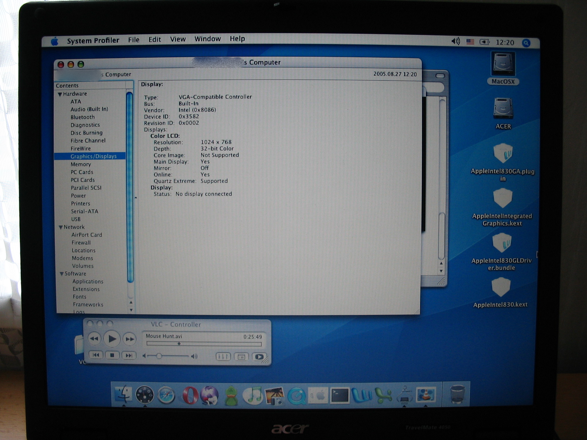

Murzilka Posted August 27, 2005 Share Posted August 27, 2005 YES, I did it (again? ;-) )! Acer Travelmate 4050 BIOS ver. 1.70A, Pentium M 1.4 GHz, 512 MB RAM, 40 GB 5400 rpm HDD, Intel 855 GME VGA (BIOS ver. 3104) - with 1024x768 resolution Quarz Extreme WORKS (in /System/Library/Extensions: AppleIntelIntegratedGraphics.kext (changed 2582 to 3582) and only AppleIntel830* from Darwin), but only in case when i rebooting from Windows XP. Not on "power on" boot. Maybe Intel 855 VGA drivers for Windows load firmware as a Intel Wi-Fi 2200? Someone can check this? Who can fix this trouble? ;-) M. Link to comment Share on other sites More sharing options...
