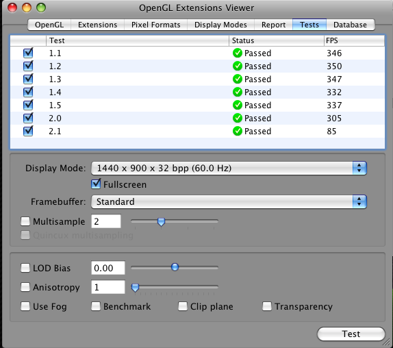

Hi,
Been away for a time! Now I'm back to test...
Here are my setups and results:
#12
Leo 10.5.2
AGPGart 2.6.6 -> AGP_Base_0xf0000000
IONDRVsupport -> From Slice (V1441)
atindrv 10.4.5
IOGraphicsFamily -> Vanilla 10.5.2/Graph Update 1.0
Graph kext -> Vanilla 10.5.2/Graph update 1.0 with mod to ATIRadeonX1000.kext with 71C2 key added
Boots fine, like with AGPGart 2.6.5f
Tearing: None visible
Shading (OpenGL Standard): 1626
GioFX: 438

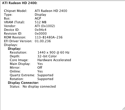

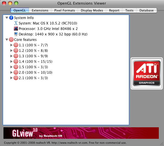

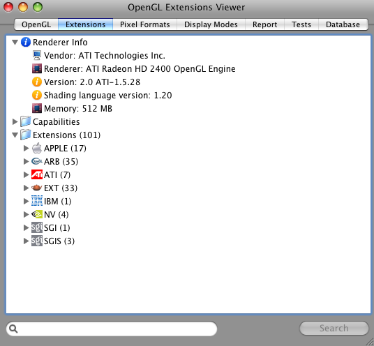

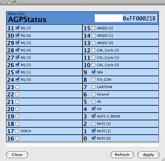

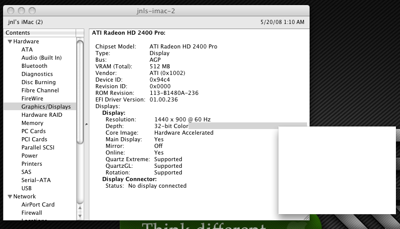

I have a new card for testing on my i865 agp mobo. Radeon HD 2400 Pro 512mb.
After about 9 hours lastExile and I got it working under 10.5.2.
With the latest agpgart.kext I can get to the desktop with 32mb and 64mb agp aperture ( no ci or qe )
With 128MB aperture I get a blue screen. ( hangs b/c 128mb must be activation hardware acceleration )
I will be available to test new builds and I might start looking into how to get it working with you. I am thinking of asking lastExile to help.
The AGP showing in this screenshot is agpgart light loaded not the true agpgart.

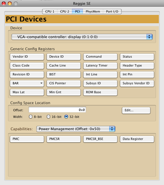

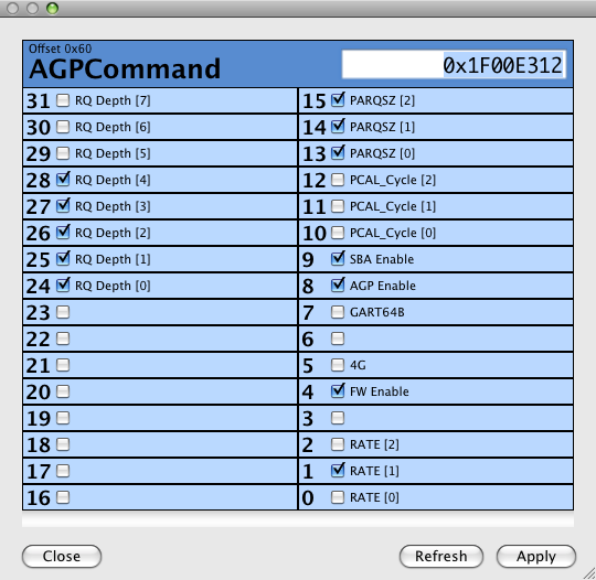

Well well well with the new working Radeon HD 2400 Pro and Intel 865 chipset I am able to get agpgart version f to load and have full qe and ci supported .... just need to fix the white menu bug.
Well after some testing, reinstalling the Radeon HD 2400 Pro AGP package rebuilding the mkext and rebooting the white menus are fixed.

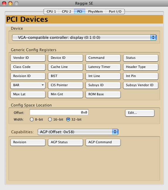

here is the output from lspci -vvv
00:00.0 Host bridge: Intel Corporation 82865G/PE/P DRAM Controller/Host-Hub Interface (rev 02)
Subsystem: Intel Corporation 82865G/PE/P DRAM Controller/Host-Hub Interface
Control: I/O- Mem+ BusMaster+ SpecCycle- MemWINV- VGASnoop- ParErr- Stepping- SERR+ FastB2B- DisINTx-
Status: Cap+ 66MHz- UDF- FastB2B+ ParErr- DEVSEL=fast >TAbort- <TAbort- <MAbort+ >SERR- <PERR- INTx-
Latency: 0
Region 0: Memory at f0000000 (32-bit, prefetchable)
Capabilities: [e4] Vendor Specific Information <?>
Capabilities: [a0] AGP version 3.0
	Status: RQ=32 Iso- ArqSz=2 Cal=2 SBA+ ITACoh- GART64- HTrans- 64bit- FW+ AGP3+ Rate=x4,x8
	Command: RQ=1 ArqSz=0 Cal=0 SBA+ AGP+ GART64- 64bit- FW+ Rate=x8
00:01.0 PCI bridge: Intel Corporation 82865G/PE/P PCI to AGP Controller (rev 02) (prog-if 00 [Normal decode])
Control: I/O+ Mem+ BusMaster+ SpecCycle- MemWINV- VGASnoop- ParErr- Stepping- SERR+ FastB2B- DisINTx-
Status: Cap- 66MHz+ UDF- FastB2B+ ParErr- DEVSEL=fast >TAbort- <TAbort- <MAbort- >SERR- <PERR- INTx-
Latency: 32
Bus: primary=00, secondary=01, subordinate=01, sec-latency=32
I/O behind bridge: 0000a000-0000afff
Memory behind bridge: ff800000-ff8fffff
Prefetchable memory behind bridge: ceb00000-eeafffff
Secondary status: 66MHz+ FastB2B+ ParErr- DEVSEL=medium >TAbort- <TAbort- <MAbort+ <SERR- <PERR-
BridgeCtl: Parity- SERR- NoISA- VGA+ MAbort- >Reset- FastB2B-
	PriDiscTmr- SecDiscTmr- DiscTmrStat- DiscTmrSERREn-
01:00.0 VGA compatible controller: ATI Technologies Inc Unknown device 94c4 (prog-if 00 [VGA controller])
Subsystem: VISIONTEK Unknown device 0028
Status: Cap+ 66MHz+ UDF- FastB2B+ ParErr- DEVSEL=medium >TAbort- <TAbort- <MAbort+ >SERR- <PERR- INTx-
Latency: 32 (2000ns min), Cache Line Size: 64 bytes
Interrupt: pin A routed to IRQ 16
Region 0: Memory at d0000000 (32-bit, prefetchable)
Region 1: I/O ports at a800
Region 2: Memory at ff8f0000 (32-bit, non-prefetchable)
Expansion ROM at ff8c0000 [disabled]
Capabilities: [50] Power Management version 3
	Flags: PMEClk- DSI- D1+ D2+ AuxCurrent=0mA PME(D0-,D1-,D2-,D3hot-,D3cold-)
	Status: D0 PME-Enable- DSel=0 DScale=0 PME-
Capabilities: [58] AGP version 3.0
	Status: RQ=256 Iso- ArqSz=0 Cal=0 SBA+ ITACoh- GART64- HTrans- 64bit- FW+ AGP3+ Rate=x4,x8
	Command: RQ=32 ArqSz=7 Cal=0 SBA+ AGP+ GART64- 64bit- FW+ Rate=x8

May 20 05:07:02 jnls-imac-2 kernel[0]: AGP: Setting 08 data rate
May 20 05:07:02 jnls-imac-2 kernel[0]: AGP: command written target=00000312 master=1f00e312
May 20 05:07:02 jnls-imac-2 kernel[0]: AGP memory 162c6000 length 00001000 offset 00000000 cnt 00000000
May 20 05:07:02 jnls-imac-2 kernel[0]: AGP memory 162c6000 length 00001000 offset 00001000 cnt 00000001
May 20 05:07:02 jnls-imac-2 kernel[0]: AGP memory 162c6000 length 00001000 offset 00002000 cnt 00000002
May 20 05:07:02 jnls-imac-2 kernel[0]: ** Device in slot: SLOT--1 **
