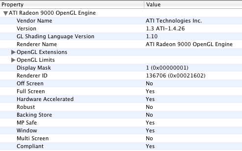

toadspit Posted April 15, 2008 Share Posted April 15, 2008 I confirm your result:(remember our difference - same chipset but Radeon <-> nVidia)with 265b2 I have hardware OpenGL with breaking with 265f I have only software OpenGL but fast Quatrz graphic. The difference is OUTREG(ATI_GART_CACHE_CNTRL, 1); //ENTRY_ for (int i = 0; i < 20000; i++) { temp = INREG(ATI_GART_CACHE_CNTRL) & 1; if(temp == 0) break; } // OUTREG(ATI_GART_CACHE_CNTRL, 0); 265b2 CACHE_CNTRL=1 265f CACHE_CNTRL=0 There is one more possible setting CACHE_ENTRY_CNTRL but I have no example how to use it. F..g Linux don't use it! It seems to be needed. Can you advice me something? Slice, I have no blind idea how to set them!! My proposal: you could build a kext where we can modify these value in Info.plist, and I could "try and guess".. Link to comment https://www.insanelymac.com/forum/topic/71308-new-agpgart/page/22/#findComment-709694 Share on other sites More sharing options...
Slice Posted April 16, 2008 Author Share Posted April 16, 2008 OK! I made version 266 with new custom value FlushTimeout. It is useful only for ATI chipset. For other no changes. Strange but this version works as 265b2 i.e. with hardwareOpenGL (with all my problems of RadeonIGP). New version of IONDRVSupport.kext. It works even in Tiger 10.4.6 but contains new features and corrections from latest version. If you type in terminal tail -n 50 /var/log/system.log | grep IONDRV you may see tracing from the kext IONDRV: ATIM baseAddr=d0000000 rowBytes=00001000 Width=00000400 height=00000300 depth=00000020 Dunno what else I need. Link to comment https://www.insanelymac.com/forum/topic/71308-new-agpgart/page/22/#findComment-710893 Share on other sites More sharing options...

Slice Posted April 17, 2008 Author Share Posted April 17, 2008 Without the ATIRadeon9700GA.plugin: AGP_Base=0xf8000000 --> boot's up till the desktop, but then everything becomes really slow (windows, dock), which is basically unworkable. 100% cpu usage? AGP_Base=0xe8000000 --> boot's up till the desktop, and then it seems to go fine, but Quartz Extreme: Not Supported It is very important if you confirm that different addresses give you different speed! Slice: I confirm your results (blue or black screen freeze with 64mb, 128mb, 256mb aperture, as 265b2, GUI with 32mb but no opengl). No traces in system.log with your new IONDRVSupport. Reports in attachment, as usual! Is FlushTimeout related to CACHE_ENTRY_CNTRL register?? Another shocking news. How can you have the same result with nVidia as I have Radeon? How do you change aperture? In my BIOS there is only shared memory size! About 32Mb look updated topic. FlushTimeout is for CACHE_CNTL. I still don't know what to do with CACHE_ENTRY_CNTL. Here is my latest sources. You can compare with previous to find what is the difference. Link to comment https://www.insanelymac.com/forum/topic/71308-new-agpgart/page/22/#findComment-712148 Share on other sites More sharing options...
