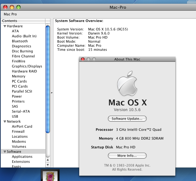

did you overclocked it? how does it performs compared to a Q6600?
i'm getting 5470 in geekbench Q6600 OC to 2.8GHz 32bit - was that a 64bit test? Getting over 10000 is a lot - a 4 core 3GHz mac pro usually gets about 5521
Nope, not overclocked. Dunno about the Q6600, never had one. My previous CPU was the Xeon Core 2 Duo running at about the same specs. All I did was add a chip with 2 more processors, feels faster! Yes, I always use the 64 bit test. I am doing a little better than a Mac Pro probably because I have slightly better parts...dunno if the hard drive comes into play with that test or not as I have a WD Raptor.
